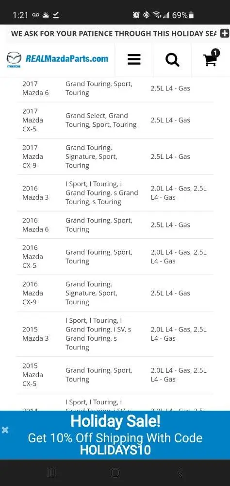

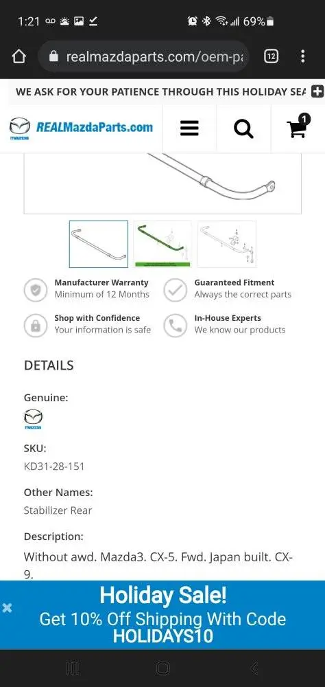

Appreciate the info. It fits the 3,6 and CX-5 but I can't speak for the CX-9. Originally I wanted the Corksport one but the CS parts specialist informed me it wouldn't fit.
3, 6, cx-5, cx-9 for fwd at least
