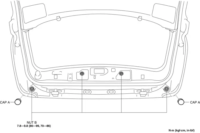

My '14 GT's got it now! Quick question. Where are the screws that need to be tightened? Thanks y'all!
I know this is an older thread, but how do you access the two bolts near the center of the spoiler?
How do you remove the trim covering the long portion of the underside of the hatch?
I see the small rubber covers on the two end bolts, but need help w/ the other two.
Thanks so much if you can help!
