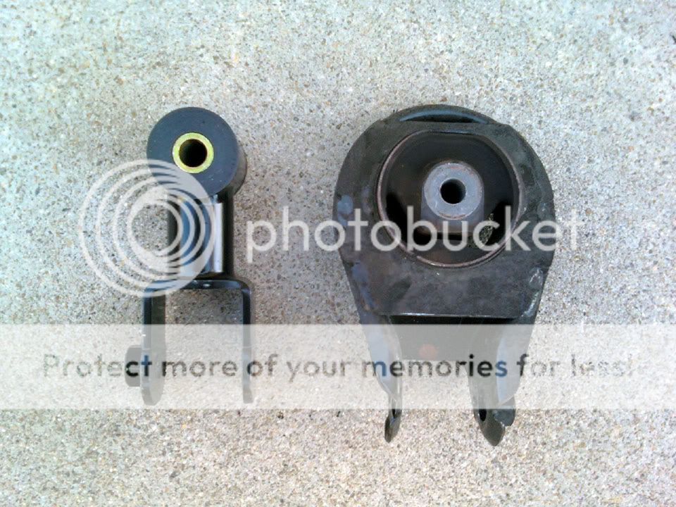

I have the TRZ Rear MM and love it!
Easy 5 min install.
TRZ Mount on left, OEM on right
Drive your car on ramps or jack the front end up, loosen the two bolts, remove stock mount, insert new mount. Done.
