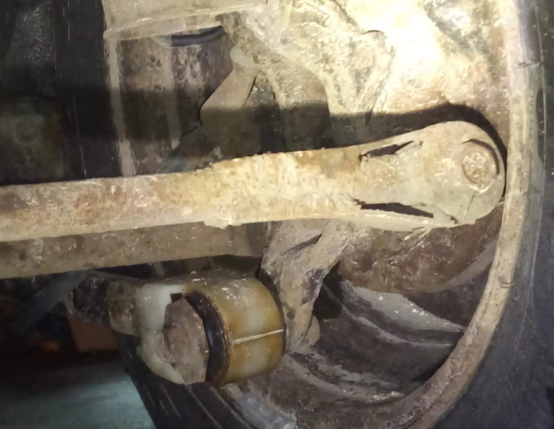

I know I'm grave digging on this post, but I wanted to share my experience with this in case it helps someone. This was hell on mine!
Three weeks into owning my 98 protege, rear lateral arm needed replaced. I noticed a previous owner did a back yard job on it previously. You can see in the photo the piece of metal that was bent around the bolt and welded back together :p
My 98 has a lot of rust, removing the bolt without destroying it was impossible. I cut one end of the long bolt off, used a torch and beat the hell out of it until it gave way. I couldn't find a replacement bolt anywhere that didn't have some long shipping time or a redic price. After replacing the arms on both sides, I used 4140 (i think) threaded steel rod and cut to size. Continued to check alignment, seems okay. Tire wear is even on both sides, so that's a plus :D I don't remember a ton of details , I did this about 8 months ago.
