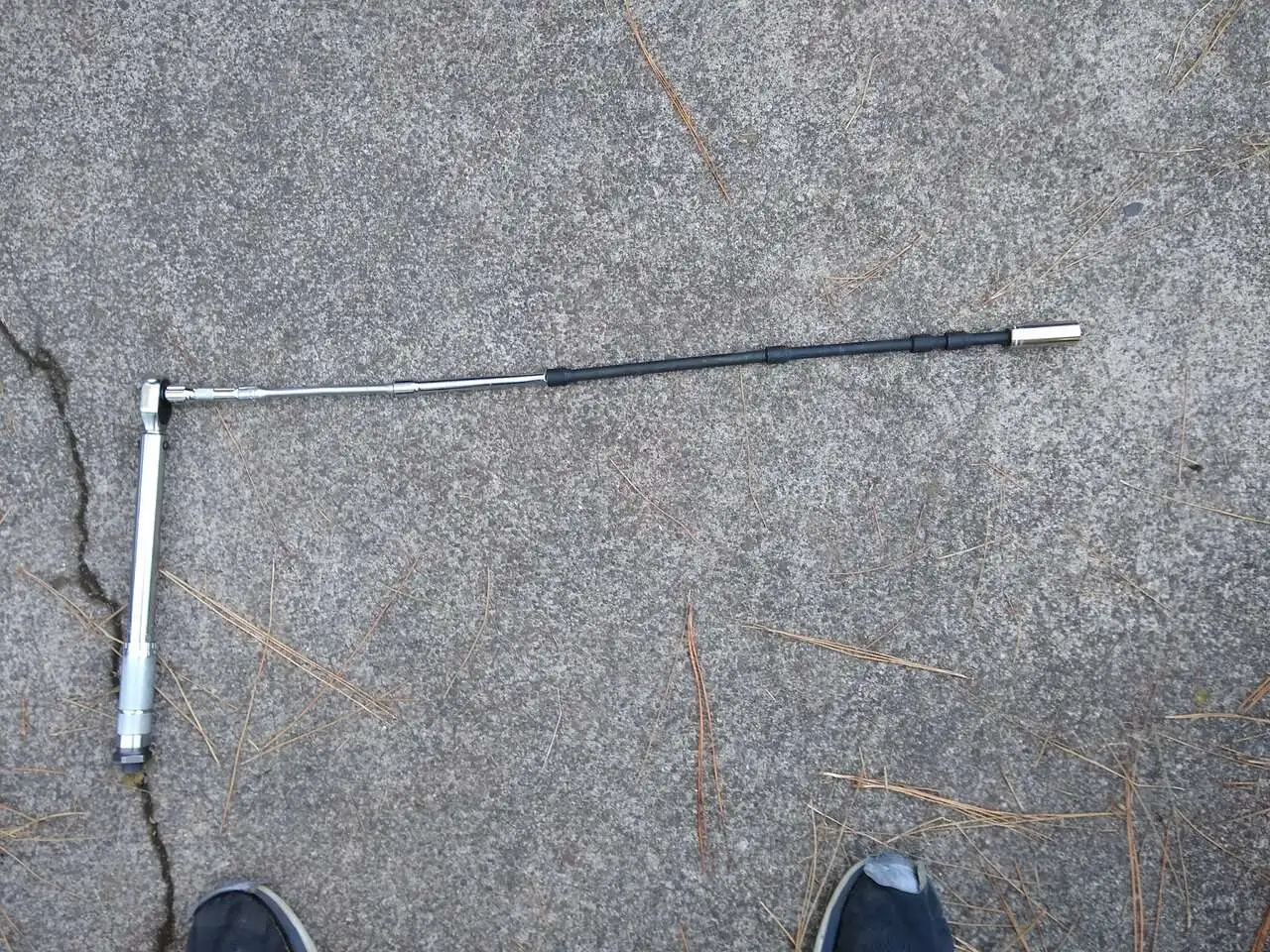

I used $17 in low quality Harbor Freight extensions and u-joints, which surprisingly did the job. Ironically, the only casualty was my Craftsman ratchet (RIP) which I admittedly put too much torque on while trying to break the nuts loose. Oh, and my hands which got pretty banged up. I replaced the OEM mount with another OEM mount which I filled with some PU sealant (40 duro I think).

  5. Use tons of extensions from harbor freight to break the bolts loose from above with a breaker bar (not a ratchet!!).

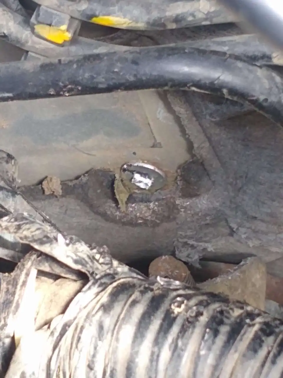

(Pics of my extensions and the ground down stud attached)

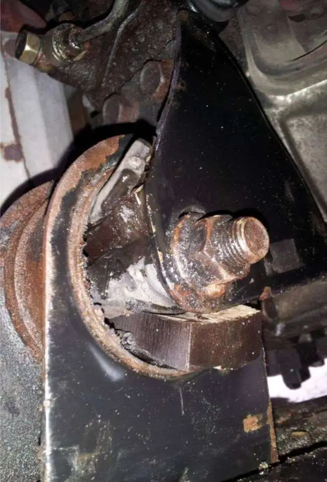

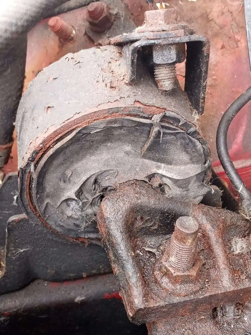

This is a picture of my passenger side engine mount where the PO filled it with what looks like window weld,..

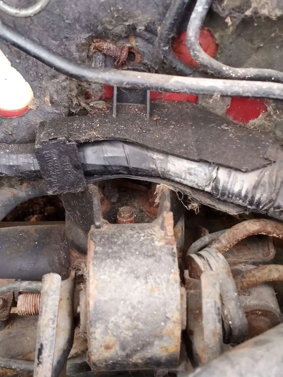

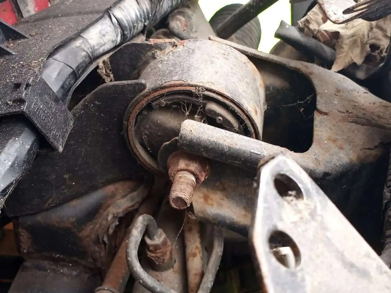

And this is the dreaded rear mount,..
It looks like the PO replaced the rear mount?
The stud supporting the wiring harness is gone, and there's a hole through the firewall.
You can see how the wires are blocking access to the nuts from the top.
I've got half the engine removed from the parts car, so things are quite visible and accessible.
I have no idea how hard it would be to try and fill that mount without removing it from the car?
It looks really tight in there.
