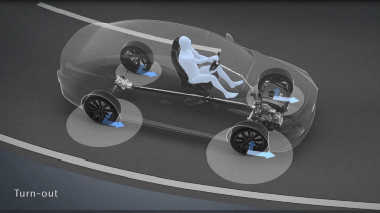

It's not a simple on/off based on a single parameter such as incline. Per Mazda: The MAZDA intelligent system uses 27 distinct inputs and also alters the intelligent steering system to adjust the control parameters up to 200 times per second. So in summary, it's constantly performing calculations based on those 27 inputs to adjust the drive system.

I think you’re thinking of it too hard. It isn’t necessarily linked to incline it’s linked to demand. You could cruise up quite a steep incline with it barely engaged on a light throttle. Conversely, if you accelerate down a steepish incline it could be fully engaged. Think of it as being linked to the gas pedal with influences from many other sources to bring it in more or in the case of heavy cornering it might back it off. It’s a “smart” infinitely variable coupling.
Upvote 0
Nice video with a bit of new information for me. Interesting that it sends drive to the rear during acceleration. Wish that would alleviate torque steer. Think I'll use the music to meditate by...well if I meditated...
