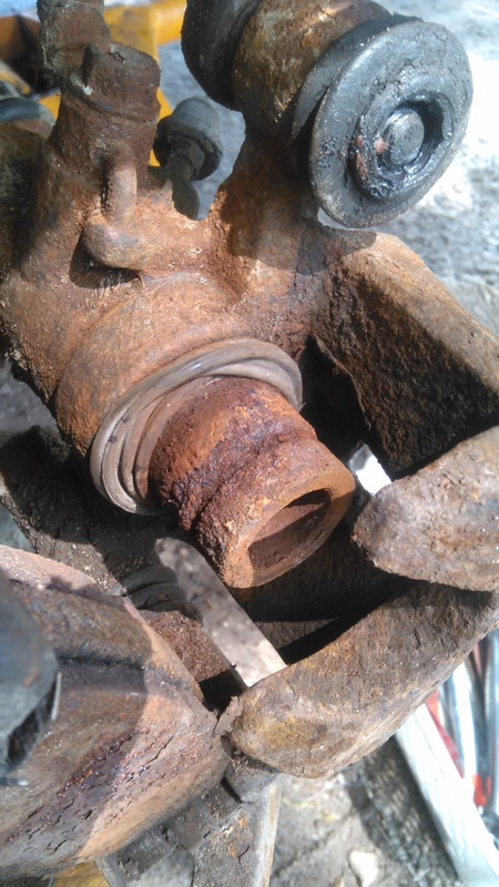

Your brake piston might be seized so the adjuster can't move it.
This is what mine looked like...

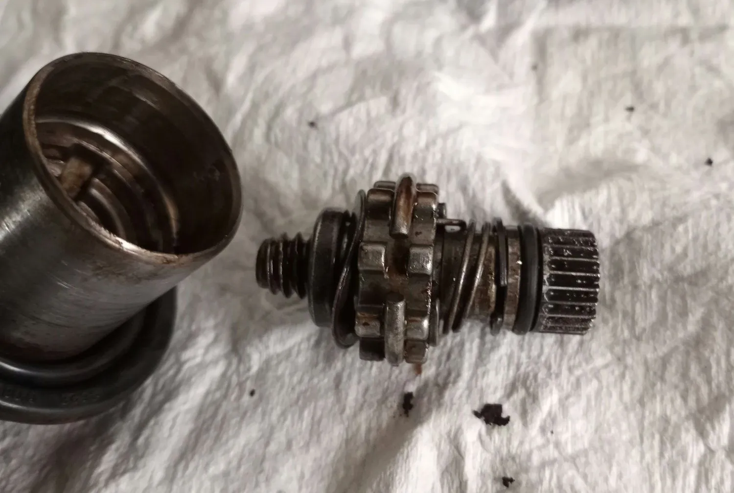

This is part of that weird ass adjustment mechanism...
This is where the P-brake cable attaches and goes into the caliper.
That pin is completely wobbly in the bore.
It doesn't matter if you replace the seal, because it will get completely mashed and start to leak.
To rebuild the calipers properly, you would need to bore out the hole and use an oversize pin to stop the wobbling.
