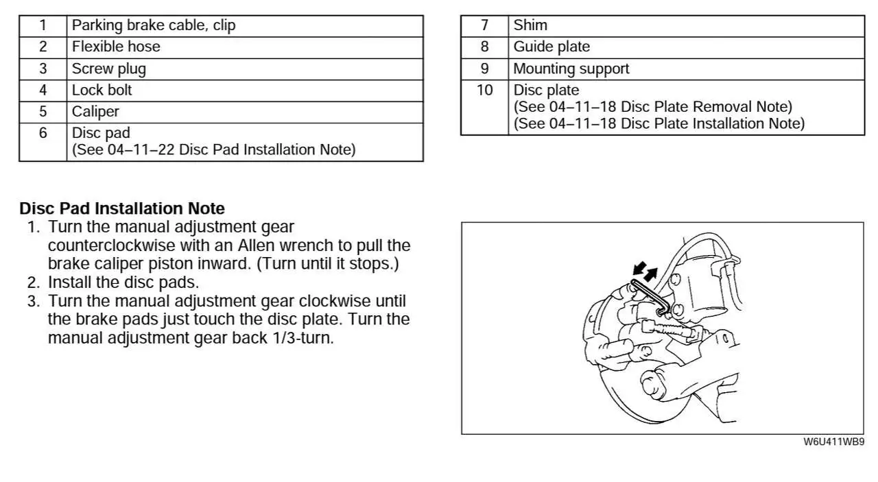

You're supposed to set the brakes by threading the adjuster screw until it stops then back it off ⅓ of a turn, but it sounds like your adjuster is stripped.

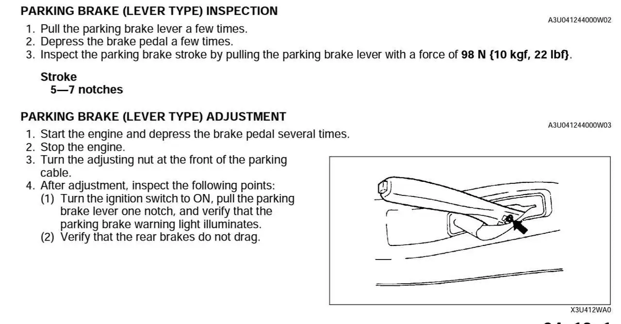

Check your parking brake after you're done.
If there are too many clicks on the handle, your P-brake may not hold the car.
If there aren't enough clicks, the self adjusters don't have enough movement to get them to ratchet out as the pads wear.
Cables stretch over time and you may need to tighten up your parking brake lever.

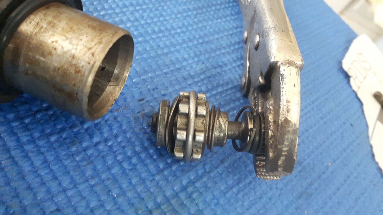

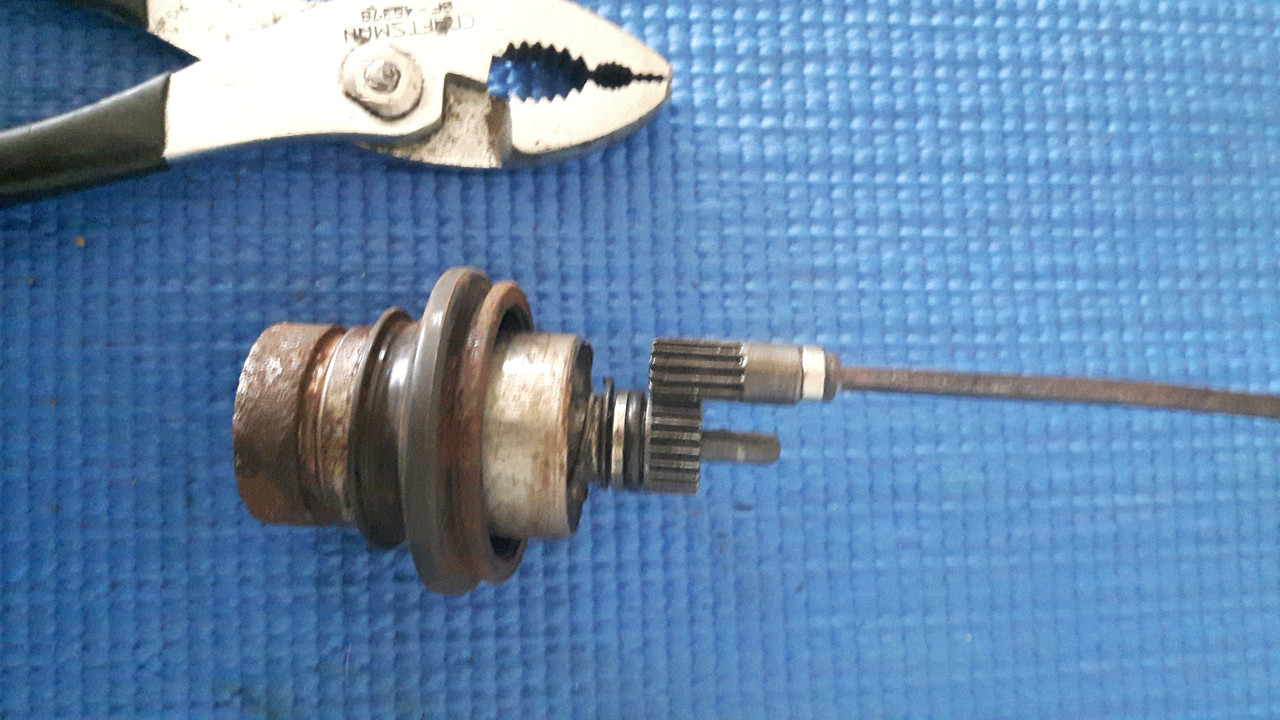

Here's a couple pictures of the adjuster mechanism,..
This is the connection point for P-brake cable.
It needs to have full movement on it to allow the ratcheting mechanism to push the piston out.
My P-brake cables were seizing up and the spring on that connection point wasn't strong enough to pull the wire through the cable, so I added a spring to pull the wire back into position until I got new brake cables.

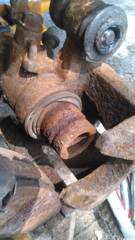

My brake piston was in pretty rough shape. Lol
Life in the rust belt.
