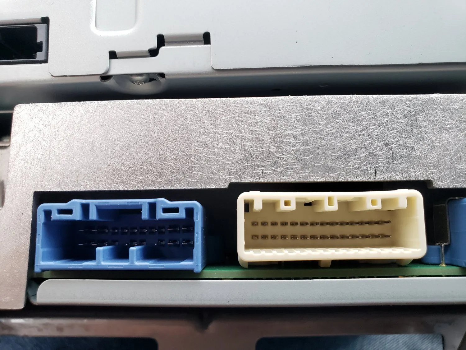

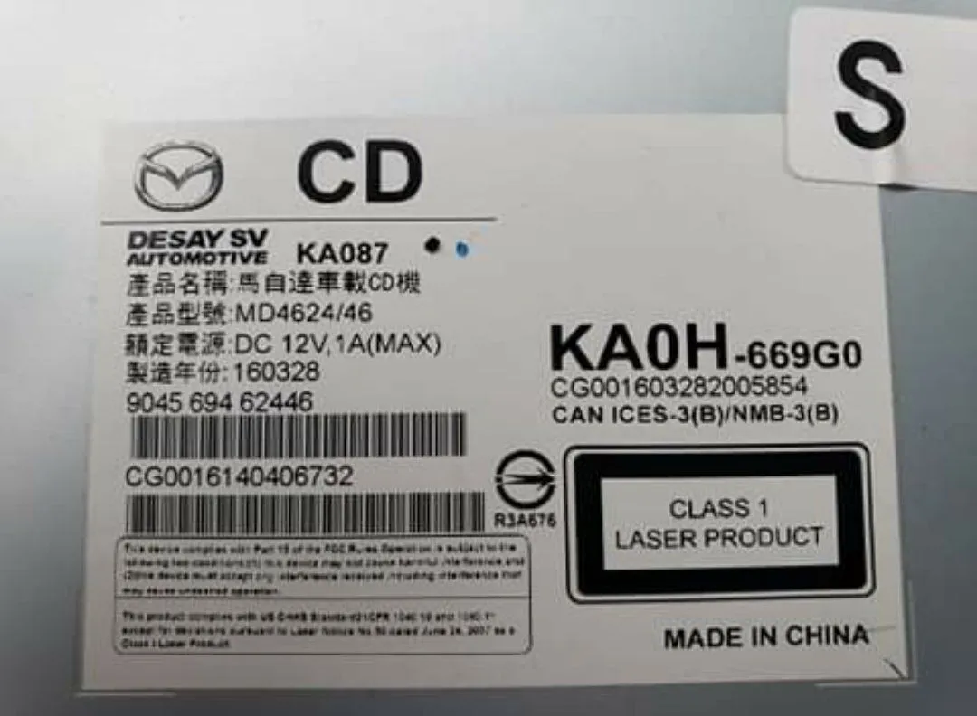

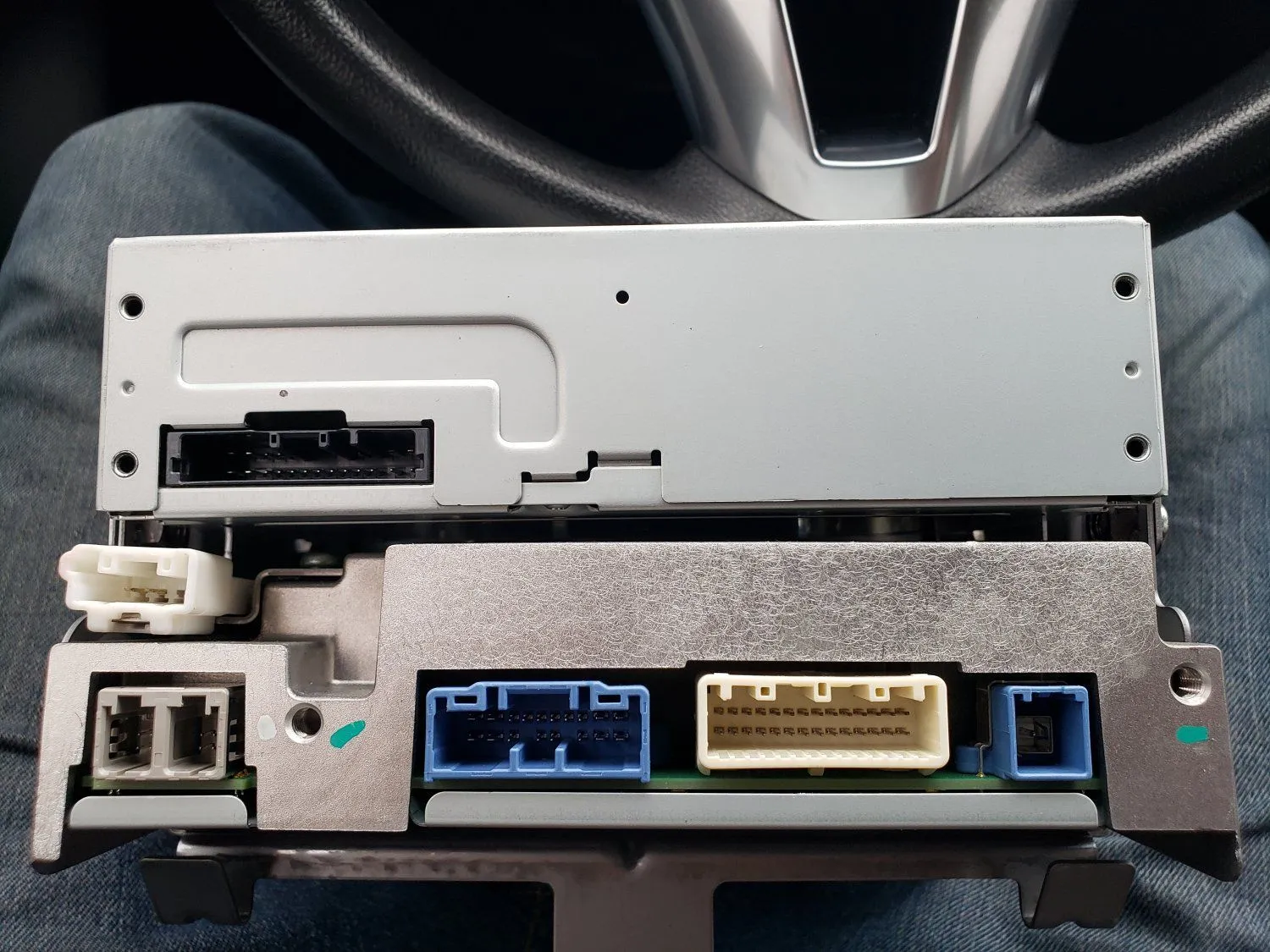

Radio Harness 2016.5 with Nav...Looking for T-Harness
Non Bose
2016.5 Cx-5 Mazda Connect Navigation
Budget: None
Radio: KA0H-669G0
Not looking to replace the head unit. I'm looking for the T-Harness to install an aftermarket amplifier.
Doesn't have to be a T harness, I just need the male for the radio and the female for the harness side and willing to buy multiple items to get them. I have been trying to get a wiring diagram for the factory head unit to no avail. I will cut into the wires if I have to but would like to make sure there was no other option.
similar thread:
Thank you however that thread is for a different radio which uses different connectors.
Correct. But there are a LOT of resources listed in this post:
None that I can use. Only
Thanks for the help however non of the resources are usable. The wiring is completely different for the 2016.5. The harness ends are different and the wiring is different. I'm currently trying to get a print out from mitchell Shopkey. I have gathered there is no harness in existence for this car so the only route is to get the wiring diagram and start cutting

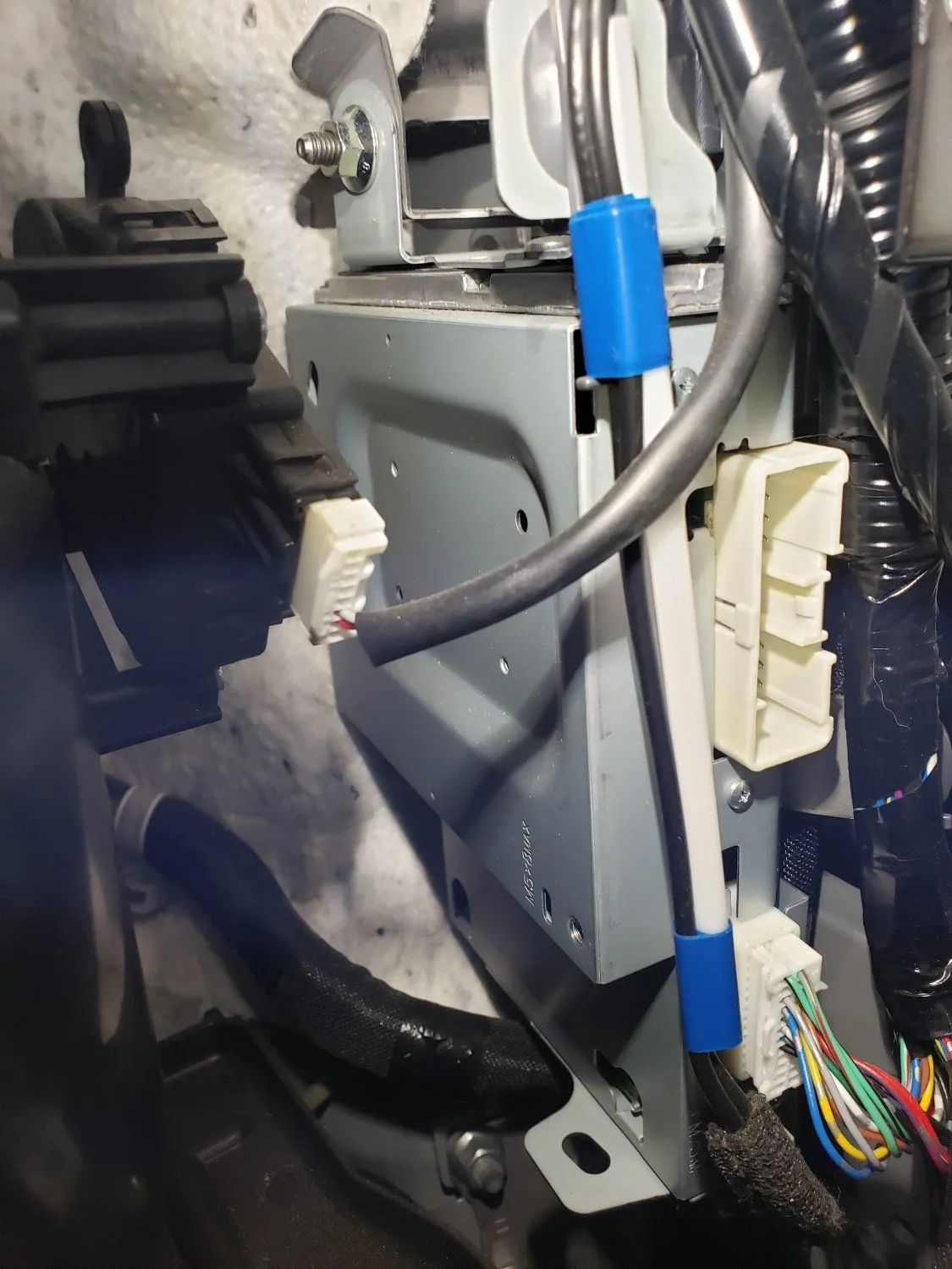

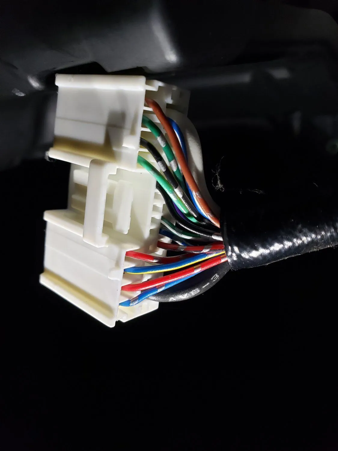

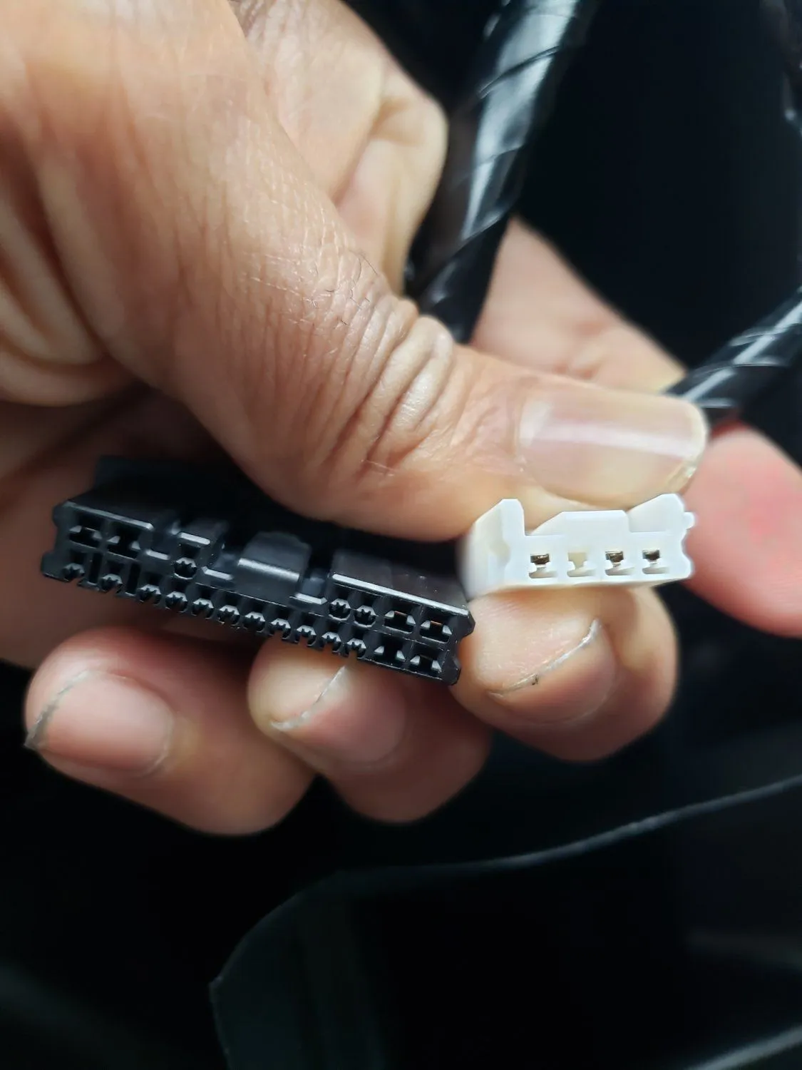

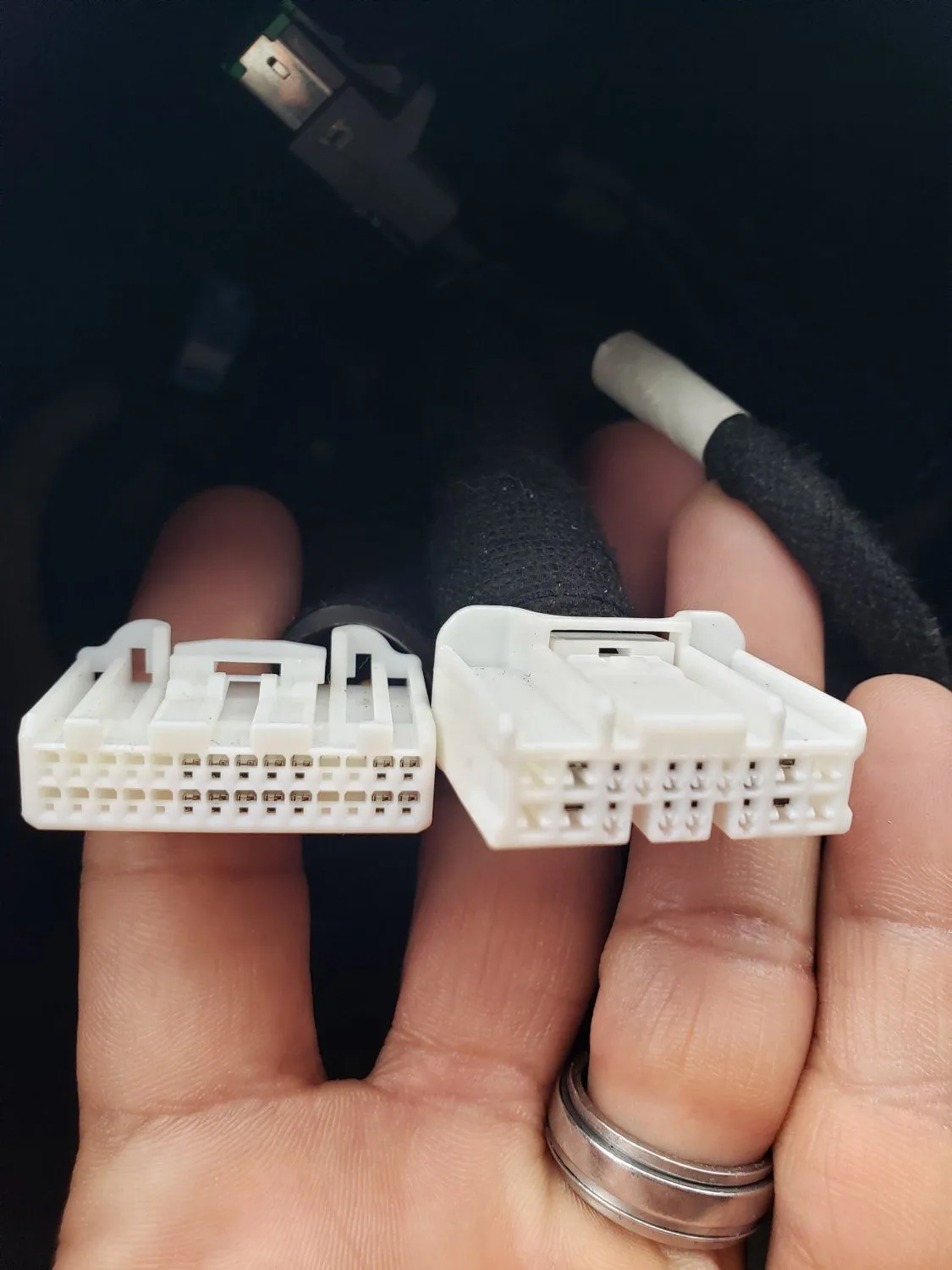

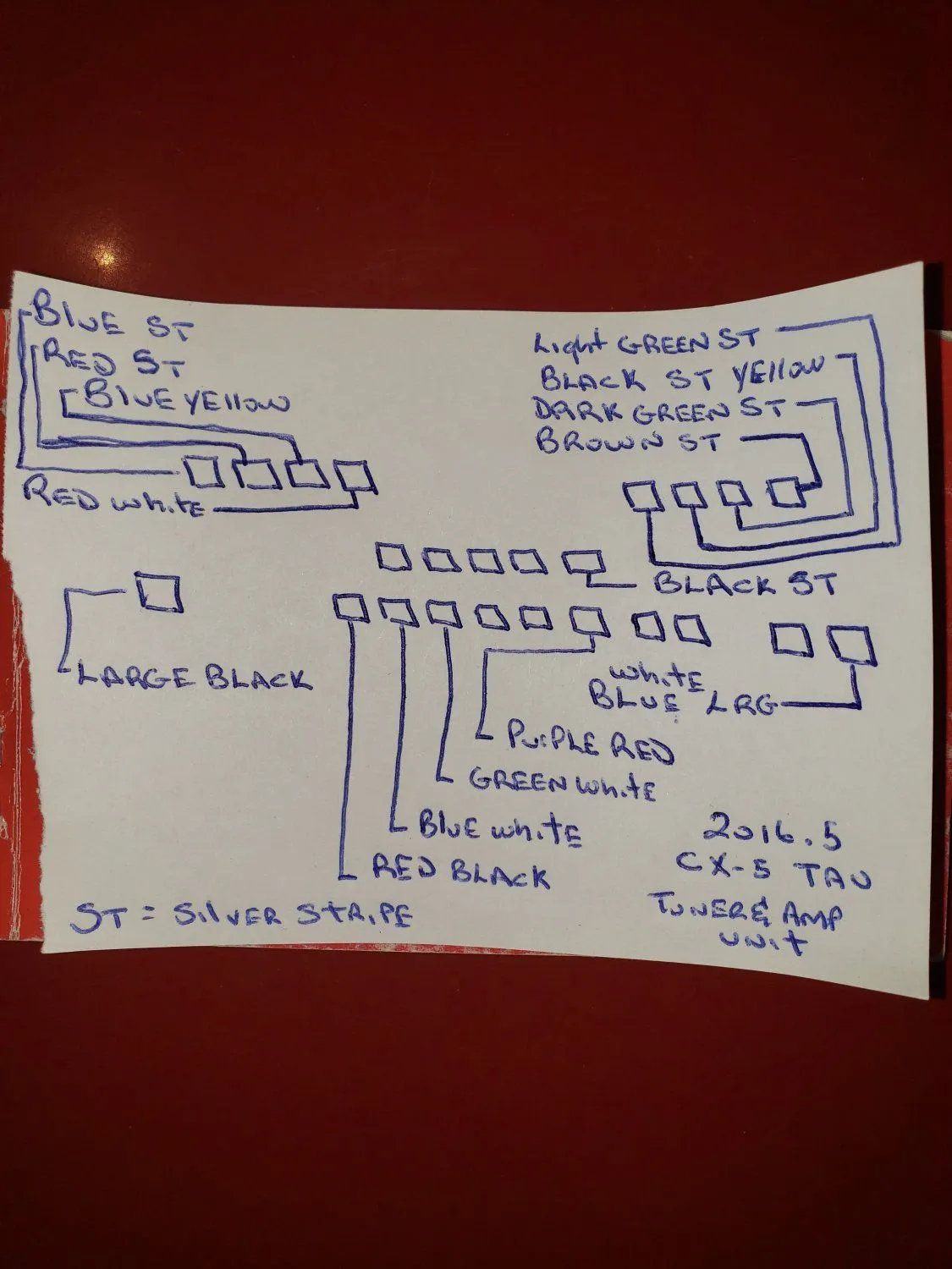

Tuner and amp unit located at right kick panel. From what I gather this plug is where all the magic happens. Its the same plug in all the mazda however I think the inserts are at different locations and maybe different colors. I have found universal plugs with a connection to all slots. I just need to find out what each color represents.
