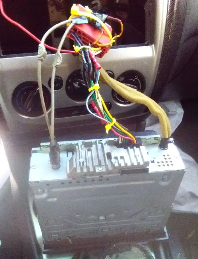

Panasonic wired correctly including factory sub... Protege5 sounds great until you turn the headlight switch on...Any ideas? TIA
- & It buzzed fm Dimmer before LED Hi/Lo 's & LED Hi beams & LED Fogs I installedI would try to quickly disconnect the head light bulbs and see if that clears it up. If there’s aftermarket LED bulbs it could be poor quality or bad resistors and such on that circuit.
Are you using the dimmer circuit to power the deck? It’s been a while since I’ve looked at wiring diagrams for stereos
Nope - using Fuse Tap in Radio Power slot in Dash Fuse Block & Scosche ConnectorAre you using the dimmer circuit to power the deck? It’s been a while since I’ve looked at wiring diagrams for stereos
No... we bought this for Son In Law to save gas expense in his V8 Toyota Truck so I wont see it until next Oil Change - First thing I'm gonna do is jumper out Dimmer Resistor to put Dash Lites on Hi w/no resistor inline & see what happens.any update Buck?
So glad you got it sorted out Buck! I was waiting on this conclusion lol.FIXED - Just disconnected the ridiculously large OVER complicated Dash Light Dimmer - Dash Lights Still Work!
So I mess around trying to jump it out at Connector,,, blow a Fuse of course... THEN figure out if u just disconnect the dimmer Dash Lites default to ON.So glad you got it sorted out Buck! I was waiting on this conclusion lol.
