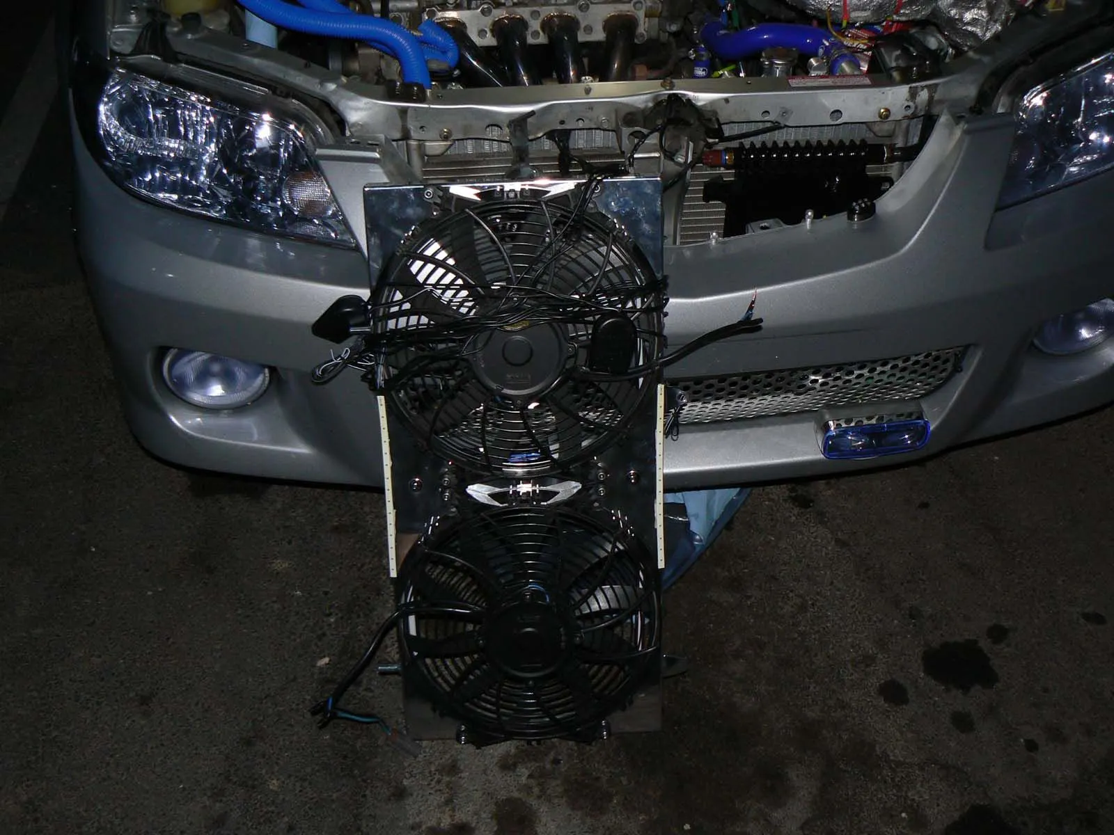

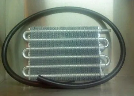

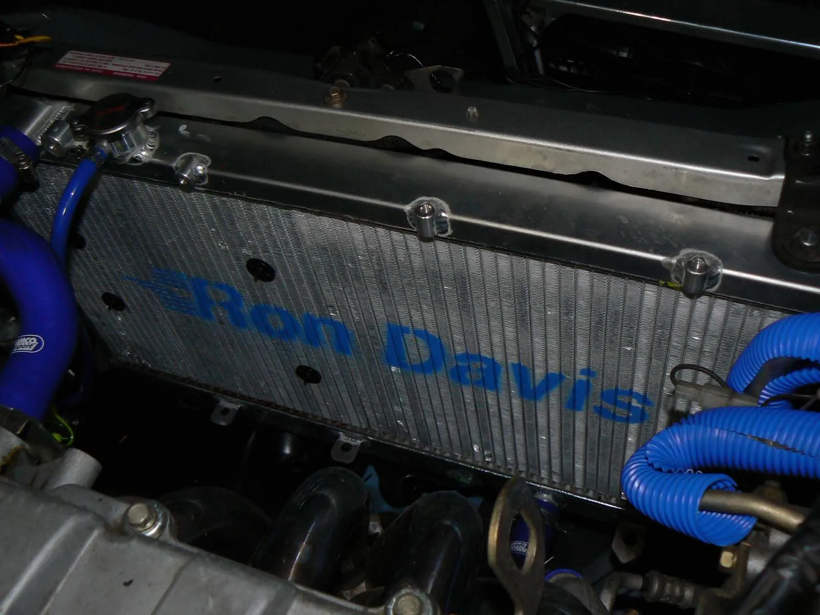

I have an automatic. I upgraded to a alum radiator several years ago I also purchased the lgr alum fans as well, got both from protege-garage. this radiator cools alot better than stock. All you need to do is purchase an additional oil cooler for the transmission oil and mount it to the front. its easy. so in short, you can buy any "manual" radiator and add an oil cooler for an "automatic."

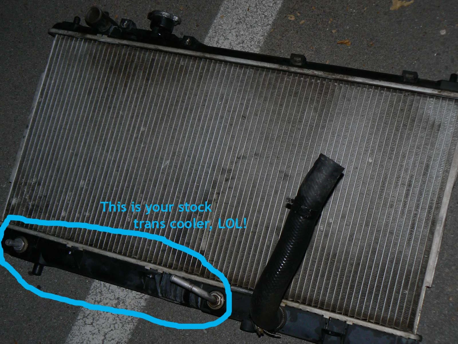

the stock automatic trans "cooler" is a joke, its just a single line that runs under your radiator. mounting any type of oil cooler to the front would be an upgrade.
some pics of my radiator install from 2007.
Hayden Transaver Stacked Plate ATF Cooler..................just like in the link above. Simple. Effective.
