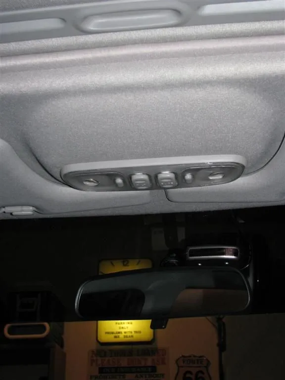

in my P5 I have mine mounted above the mirror. It's actually resting on top of it. I ran the power cord right in and spliced in to the 12v lines for lighting in upper console(map lights and sunroof controls).

Interesting. Pictures would be awesome, if you could.
I was looking at the rear view mirror thinking "how big are those radar detectors" and wondering if you need a mounting bracket or something up there.

bad night picture. I will take a better one tomorrow... only bad thing I know from having it resting on mirror is when the bass is hitting the thing ratttles a bit.

So you can get a nice mounting bracket for the mirror?
And I didn't realize the V1 was that small. For some reason I thought it would be twice that size.
Edit: Oh wait that's not the V1.

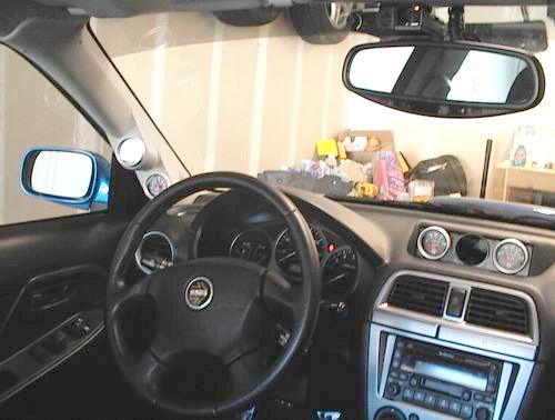

I think you want the detector as high as possible. The higher it is, the further "over the horizon" it can see... not to mention you want it to be above crash walls, other cars, etc so it can see radar around them.
I've got a V1 and it's amazing. I've mounted it like DeanSweet mentioned in several different cars placing the detector jus above the rear-view mirror... just run a fused 12V and ground up into the headliner and drop a small 4" piece of telephone wire down to plug it in. The V1 actually comes with a hardwire kit to allow you to do it that way. Makes for a very clean install.
On my truck, the power runs up the A-pillar, in my WRX it's wired into the power for the autodimming mirror, on the SVX it's tapped into the sunroof power. Just make sure it's on an ACC or IGN line... if it's on all the time, you'll drain the battery.
Edit: found an old ass picture of my WRX, the V1 is above the mirror:
