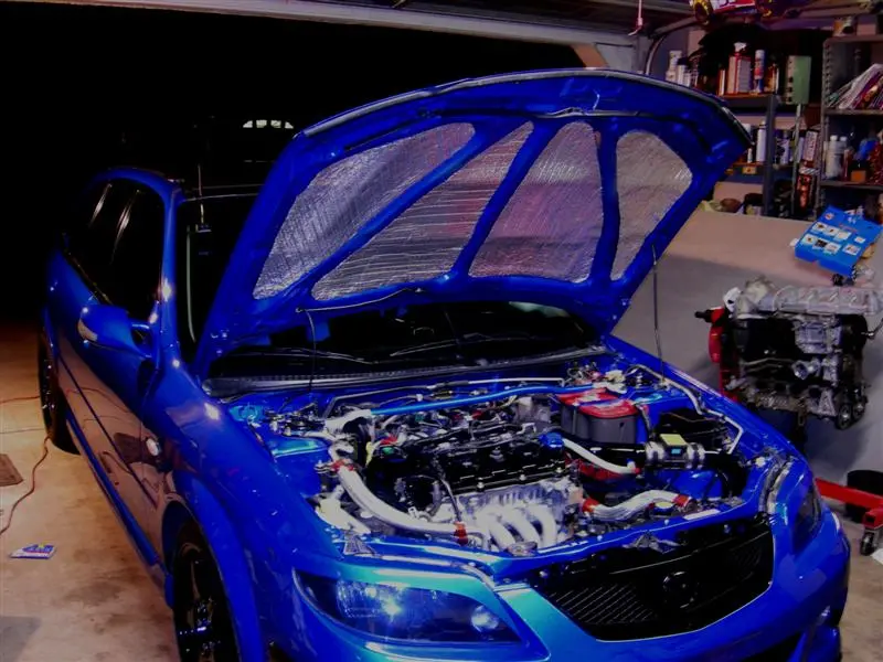

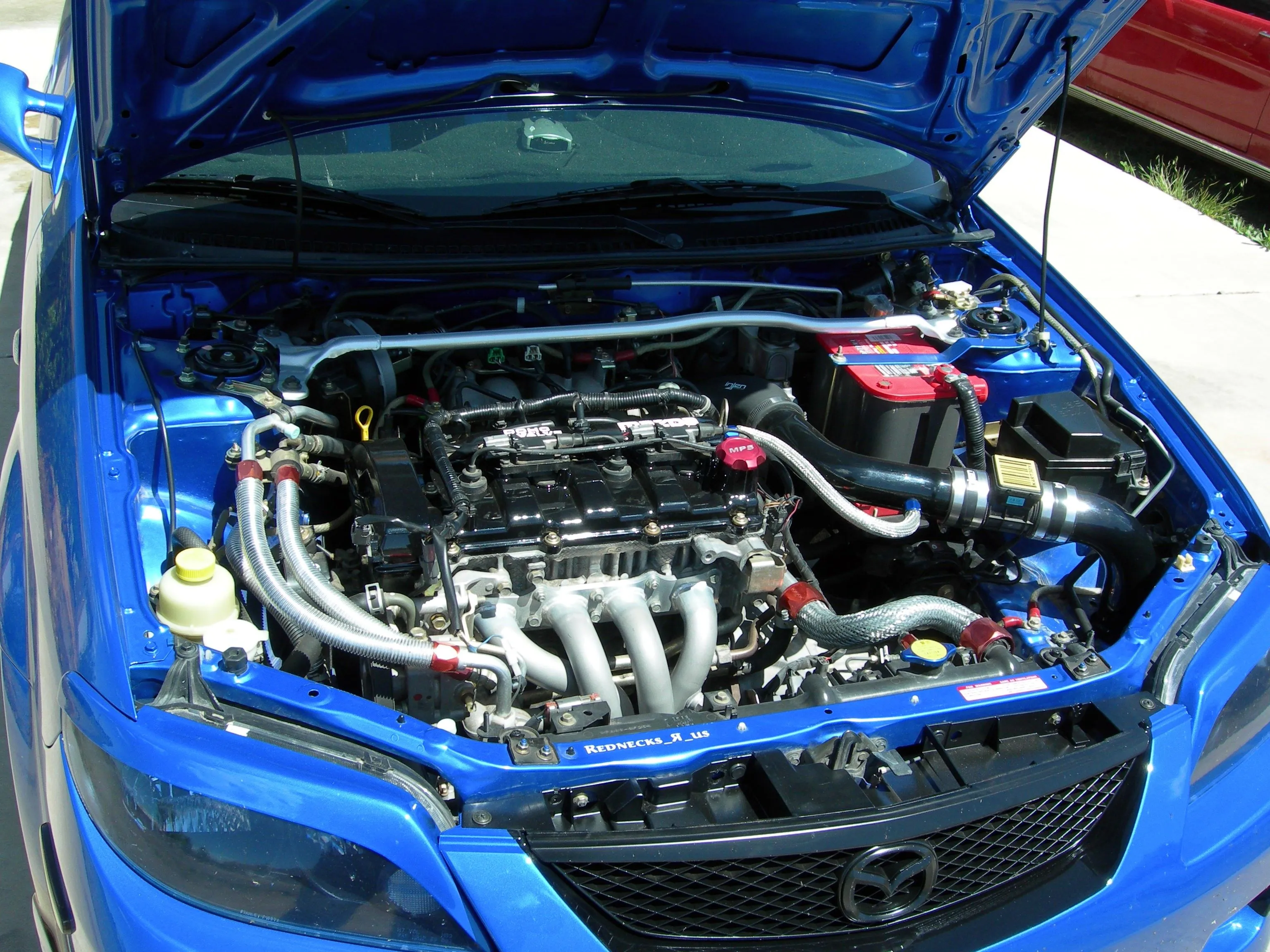

I have the ractive header. Its a 4-1 design. It only has one o2 bung. Mine fits fine but is really close to the oil pan.
I got a MAM midpipe with the o2 bung behind the cat. I extended the o2 wires and have not gotten a CEL.
I HIGHLY reccomend www.jet-hot.com before you ever install it. Jet hot is worth the money. Rust will kill this header in a short time and jet hot ceramic coating will prevent that.
http://mazdasports.com/joomsmf/gallery/v/members/rednecks_r_us/DSCN0503+_Medium_.JPG.html
