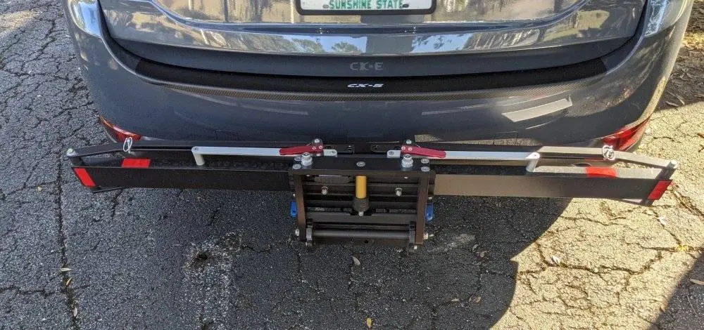

Anyway, I added two racks for hauling stuff. First I added a 2 inch hitch from Etrailer, model 98902, exact same hitch as the Curt 13315 but finished in matte black.

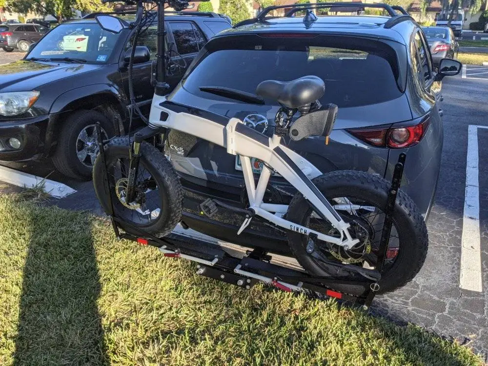

I have a fat tire Ebike (Aventon Sinch) so I installed a 1UP super duty single rack with fat tire adaptors. These are the best bike racks available, no straps etc just place bike on the tray and fold up the tire holders. I added a ramp to load my bike which weighs 70 pounds. If you have a lighter bike you can get a less expensive 1UP. If you want to carry 2 or more bikes 1UP offers bolt on extensions.
Rack folded up
Rack with bike

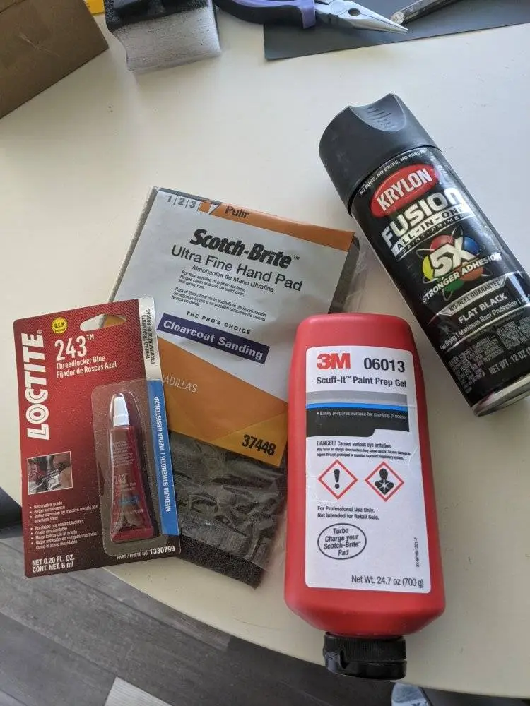

Things I used to prep and paint the rails.
I used Scotch Brite ultra fine scuff pad and 3M scuffing gel. You can do the job with just the pads but the gel makes it much easier and faster. The Krylon Fusion all in one flat black works great and matches the cross bars. I like this paint because it dries to the touch in 15 minutes. A couple tips for using it, put the spray can in a bowl with hot water 10 minutes before using, then shake really well for 60 seconds. Based on comments I read from users, I applied 3 light coats 15 minutes apart and then let rails dry and cure for a few days. Came out great and looks perfect on the Carbon Turbo as the flat black finish matches the trim on the car. Used Loctite 243 instead of 242 as it works better when aluminum is involved.

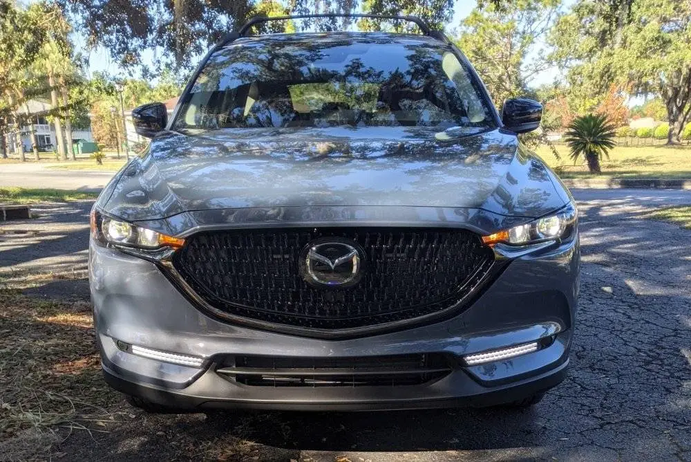

Finally, I got the idea to add LED DRLs/turn signals from this thread. Thanks to Charleston, YoungNYC and Candurin for the help.
It is an inexpensive mod that looks very cool and adds some safety/functionality to the car. You can buy the kits for less than $100 and if handy, install yourself. I paid a local stereo shop to install them, took 1.5 hours and the kid did a pro job, all wires are hidden, connjections were soldered and shrink wrapped. I had him wire the power using an add a fuse kit to an empty slot which prevents interaction with expensive headlights etc and the DRLs come on at ignition. I leave my headlight switch on auto so in daytime I am not using and wearing them out. These kits also function as sequential turn signals which look cool and also add safety. In the daytime the front turn signals are not all that visible, these kits definitely let oncoming traffic know you are turning.

Based on the original post, I also added the Etrailer 2" hitch & was going to to order the same 1UP single as the OP. A local bike shop price matched an online price on a Kuat Sherpa 2.0 that was too good to pass up so I opted for that instead. I do like the 1UP but the Kuat also suited my needs & has worked out well so far.
