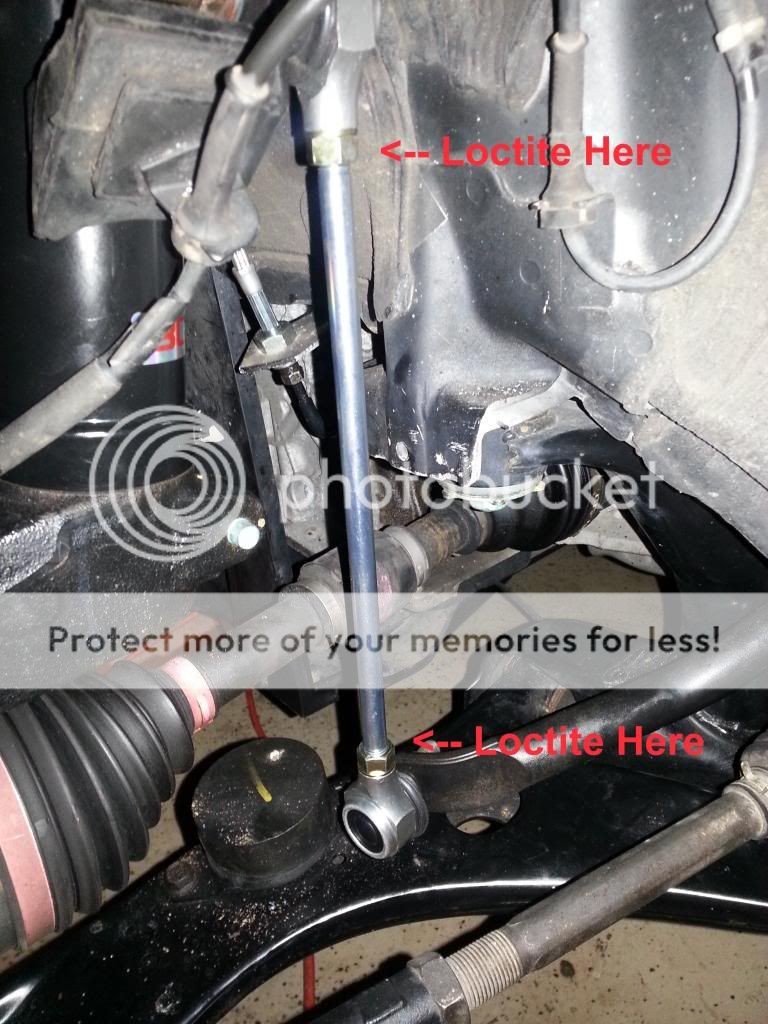

While recently installing BC coils on my 09 Touring, a test drive revealed a LOUD clunk. I had never had the clunk before so i assumed it was something with the coils. After my initial panic wore off i searched around here and found out it was the dreaded front sway bar bushings instead. I wasn't entirely wrong though. Because the overall height of the BC shock body was shorter, reconnecting the front sway bar end link was a chore. The distance between the shock mounting hole and the sway was smaller so the OEM link was too long. I ultimately forced it in there. This preloaded the sway bar, placing the already failing bushings under even more strain. The tension was so great it even clunked from just turning the wheel!
To solve for this condition, i ordered a set of Racing Beat adjustable links. Solid aluminum beauties with a good range of adjustment both larger and shorter than the OEM links. I haven't installed them yet though. Seeing that i have to replace sway bar bushings anyway, i went and sourced some used MS3 front and rear sways. I ordered new OEM MS3 bushings and clamps and hope to get it all done this weekend.
At $95, the Racing Beat links are priced fair. Compared to PowerGrid @ $155, Whiteline @ $135, and the AutoExe @ an INSANE $335! In the end i bought the cheapest ones. After all, it's just a stick with threaded ends. I refuse to believe that $335 AutoExe's do this simple task better than the Racing Beat solution.
You'll see from the pics below, the end links are well made and direct replacements for the OEM units. I've laid them in the shortest and longest settings as it compares to the OEM links.
