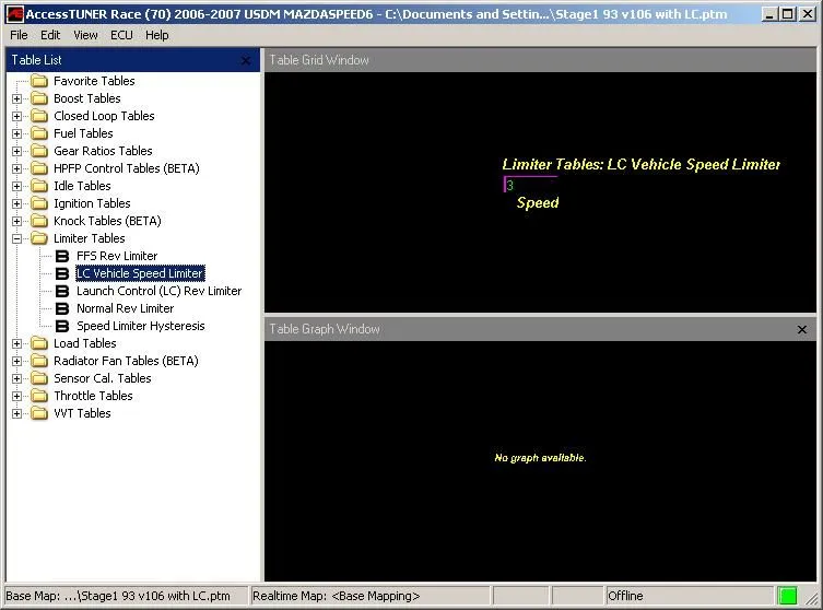

Set my flatfoot. At 5200. And got on free way. And it hit 4500 and was Doin the whole launch control thing. Is there something I'm Missin?!? Y would it rev limit at my lc rpm?
You need to set the launch control speed. This is the speed at which the LC rev limit shuts off and it goes to the flat foot rpm limit. By default it's some really high number. I set mine at 3. Here's a screen shot- untitled.JPG
Ha ha. Dam. Ok. Sweet. I was like WTF. Sweet. Thanks guys. How is launch on these cars. Pretty effective? And ffs. Is it worth having. ?
The flat foot shifting is awesome. It totally gets rid of the hesitation when getting back on the gas after a quick shift our cars have. I've only used the LC a few times. It's a lot easier to get a good launch and nicer to the drivetrain then my non LC launches at the strip.
Good info. Can't wait to run it. I was confused. I thought the speed for lc. Was when It engages. So I put 0. Thinking at 0 is when it would work. But I was back ass wards. Lol. Thanks man.
you want the speed at like 15 cause this is the point where it is disengaged.
