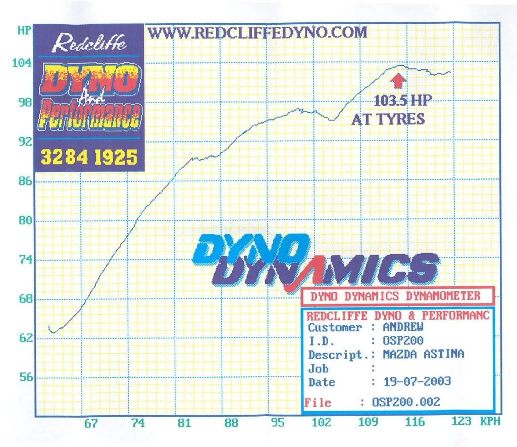

ok boys and girls....before numbers. i have just come back from the dyno. thought it migh have been a little higher, but the run was done in the middle of the day and was one of the last cars run....so there was still lots of exhaust fumes haning around and the air was warmer.
anyway, i got 103.3HP at the wheels. will scan the graph etc tonight and post when i can....talk about dip for the VICS!!!
sorry it was 103.5HP at the wheels - see attached graph...oh and also another thing that probably reduced the overall power - my oil is almost 5000km old
Excuse me for my ignorance because I dont have the funds for the proformance mods, but if you got 103.5 hp at the wheels then what in the hell does my 130hp stock engine get for hp at the wheels?!
you're probably looking at (going off what i've done etc), 97/8 hp at the wheels
as a pretty general rule of thumb for fwd cars, what the engine produces in kw at the engine is what you'd expect to see at the wheels in hp.
so, the mp5 is 130hp at the engine in the usa right? that works out to be 96.9kw....so, you'll be looking at around 96.9hp at the wheels. i know that's really general, but it's a good way to work it out.
here in australia our engines produce 98kw at the engine (131.4hp), so at the engine, i've got an increase of around 7.4hp.
i spose in the conditions, i'm pretty happy with that
