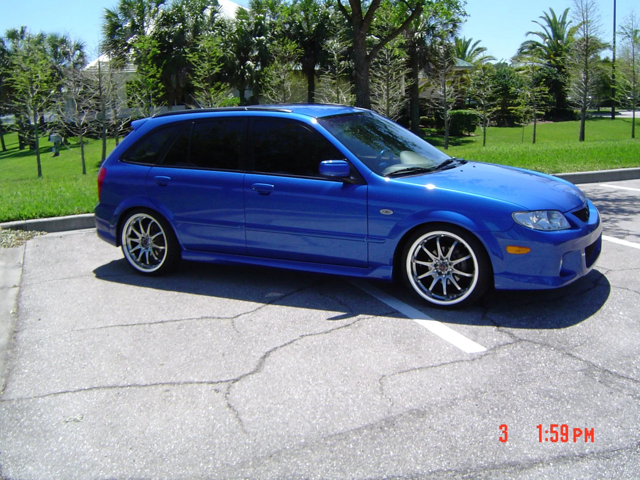

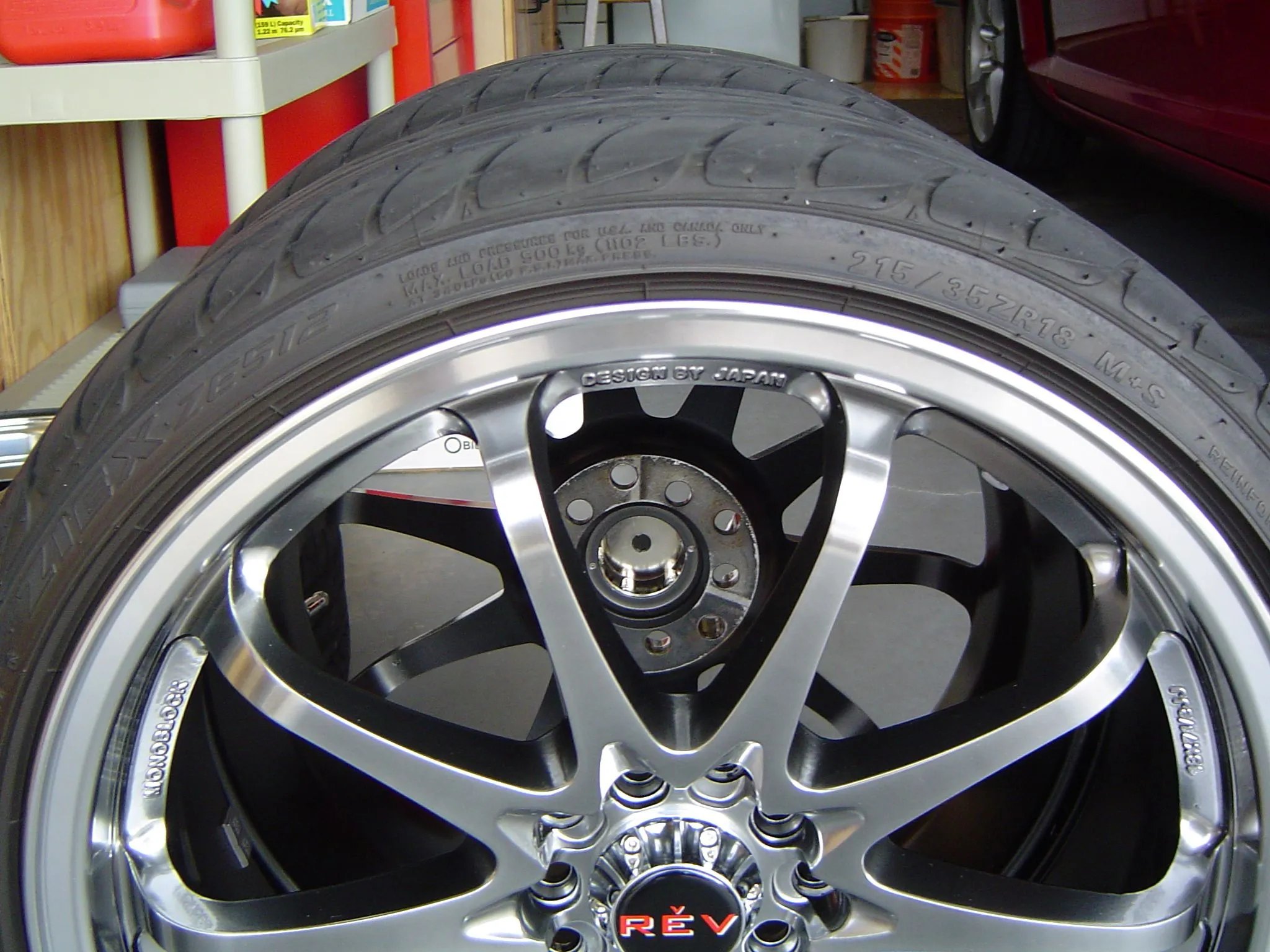

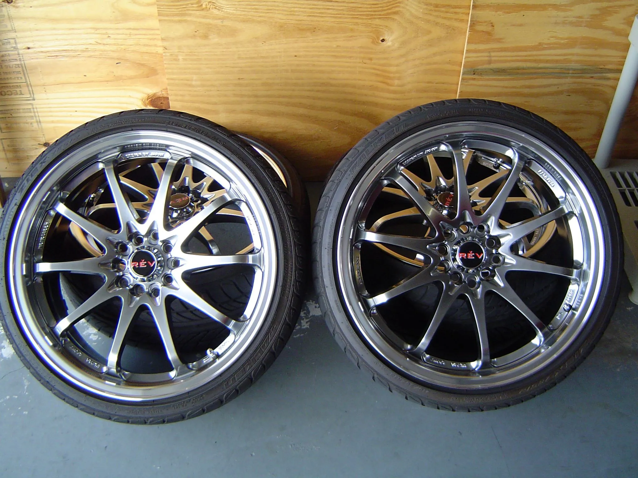

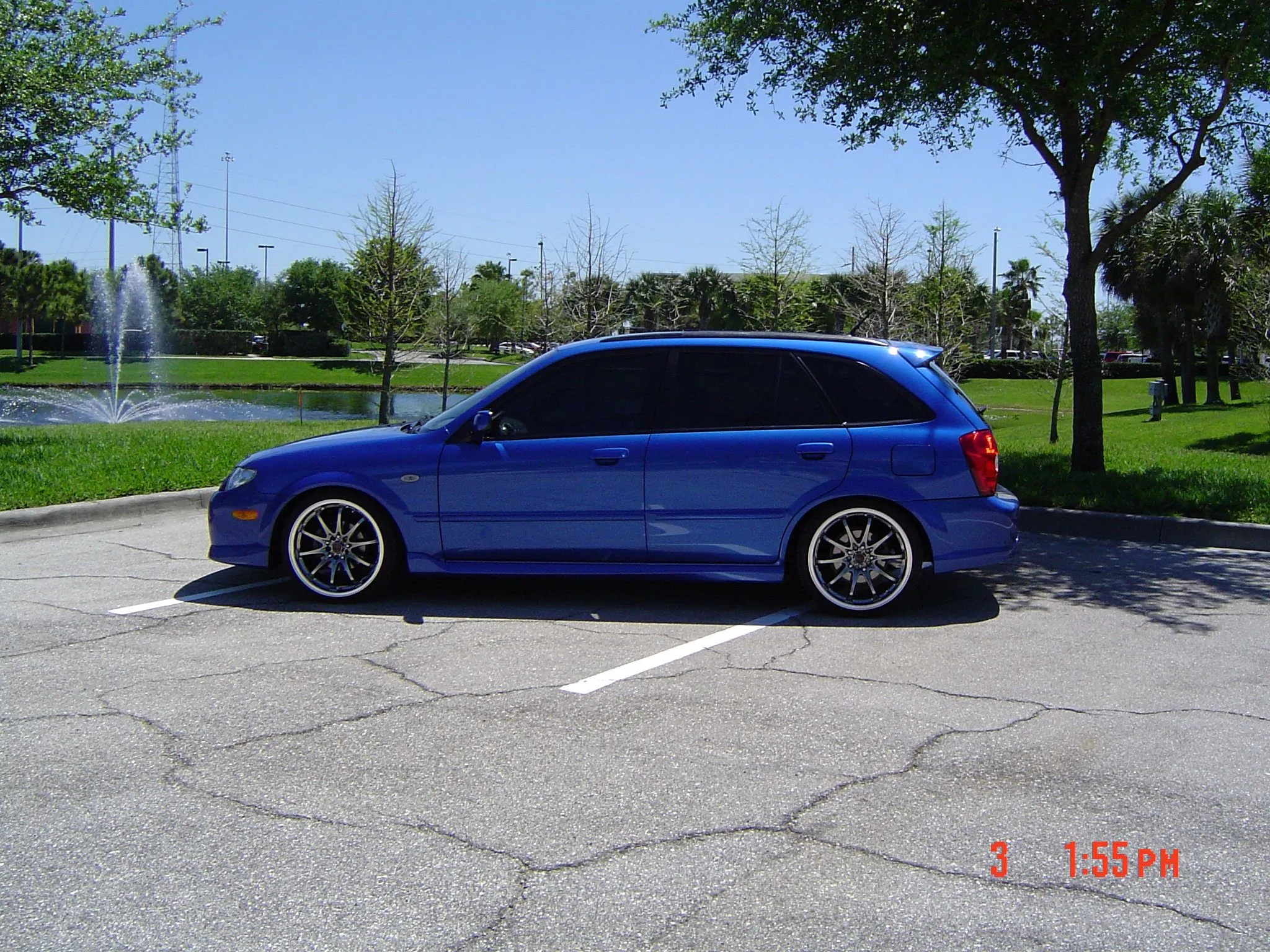

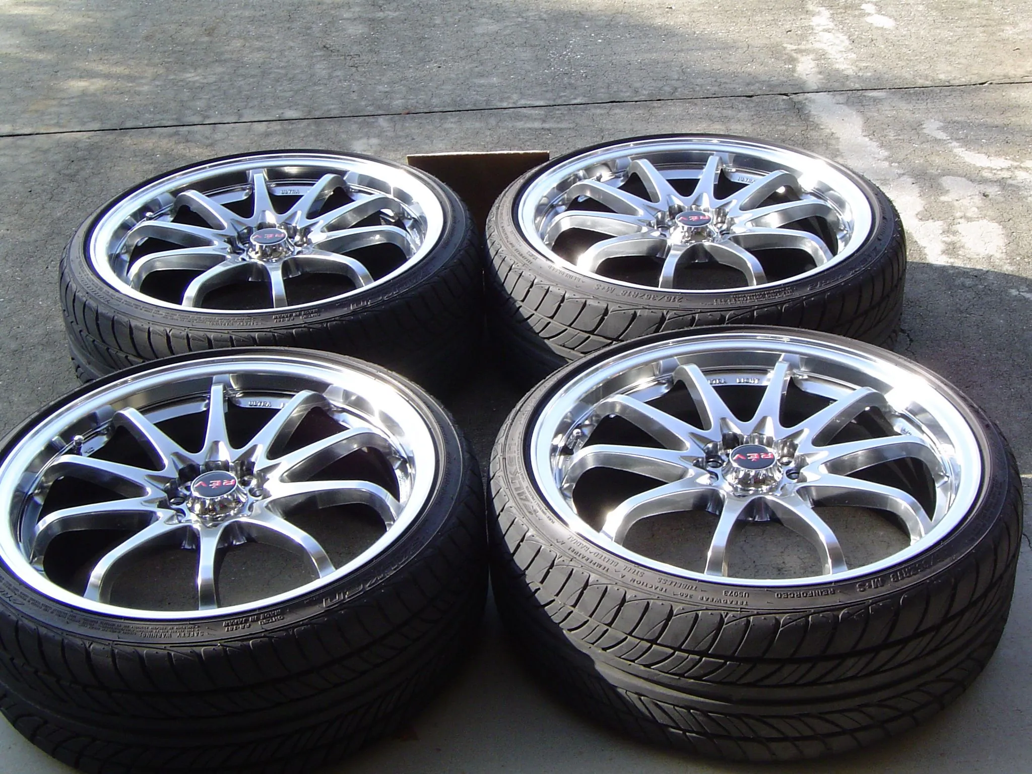

I've still got some 18's for sale. 18x7.5 +45 rev model II, 215/35/18 falken 512's.
These were on my p5 lowered with tein s-techs.
