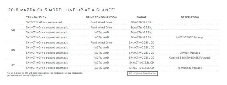

I definitely don't have a GS. It looks like I have a GX, which, according the brochure you linked does not have cylinder deactivation. It is explicitly asterisked under only the GS and GT.
The 2018 CX-5 Canadian base model GX comes with a 2.0L NA with a 6-speed manual which has no CD. But I’d imagine your CX-5 GX has an optional AT which comes with a 2.5L NA with CD.
This screenshot from the brochure indicates there is one Canadian GX trim with a 2.0L and three with a 2.5L. None of them have the CD label that is present on the GS and GT.
I will confirm tomorrow that I have a GX (I am like 75% certain, as I don't have power seat adjust) but it looks like if I have a GX I avoided CD.

Edit: I called Mazda Canada and they confirmed it is a 2.5L GX AWD built for the Canadian market, which according to that brochure does not have CD.
