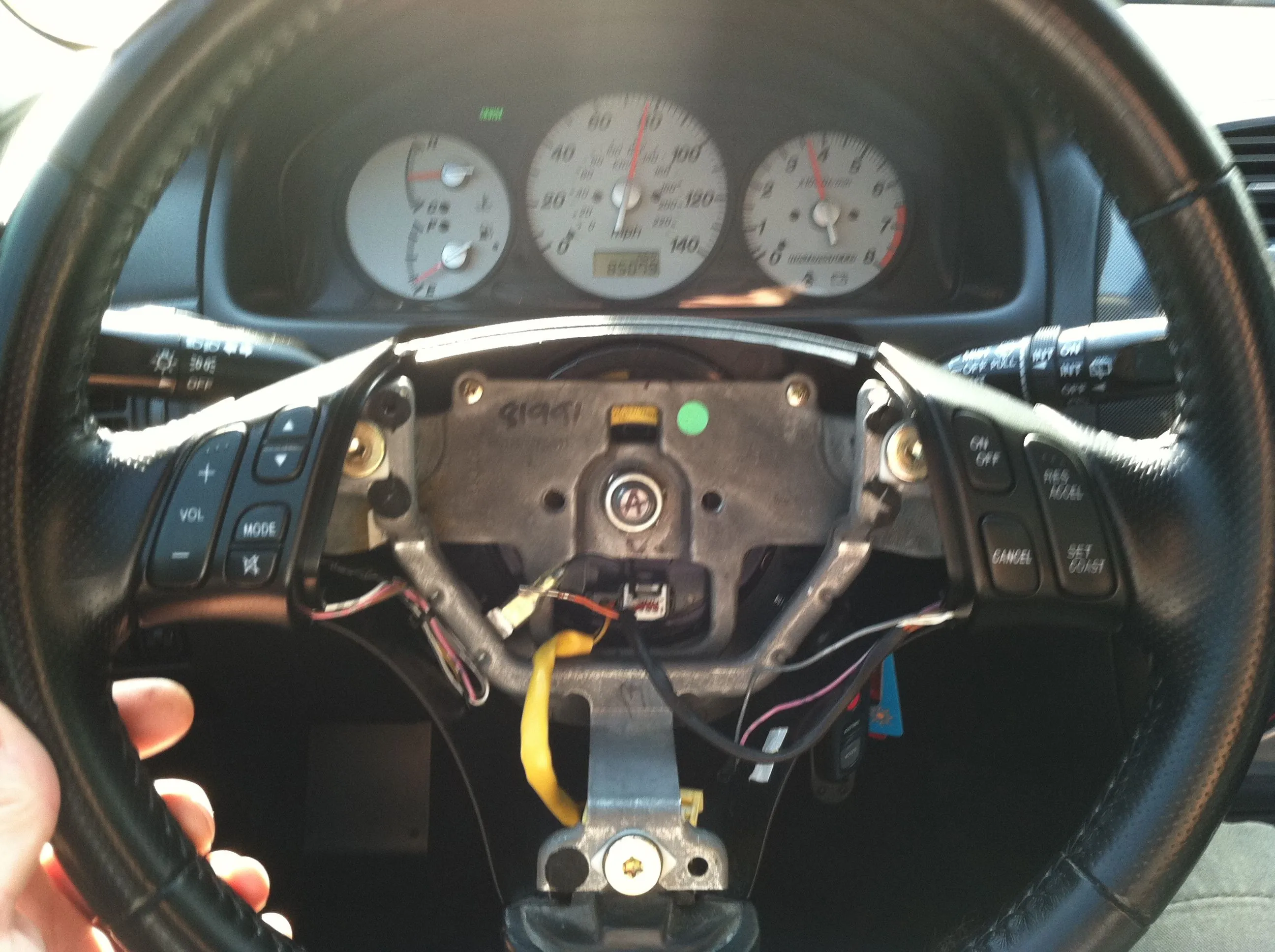

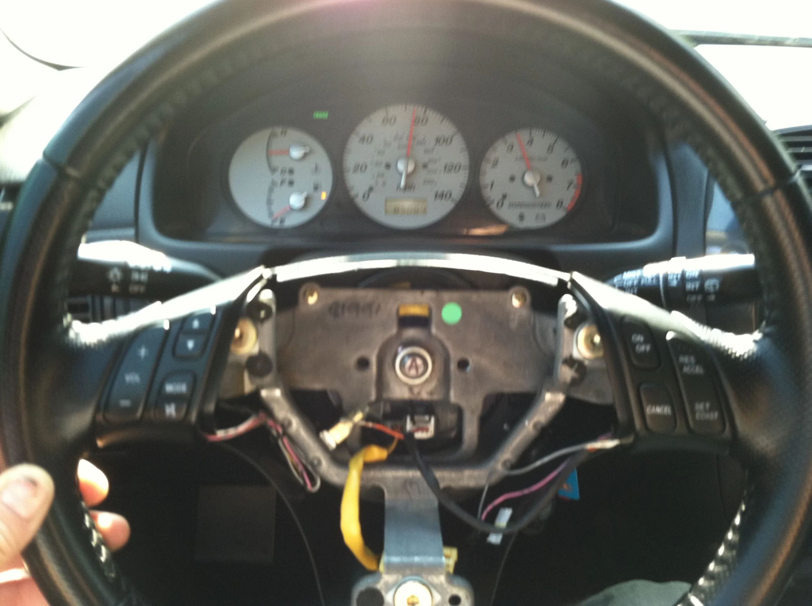

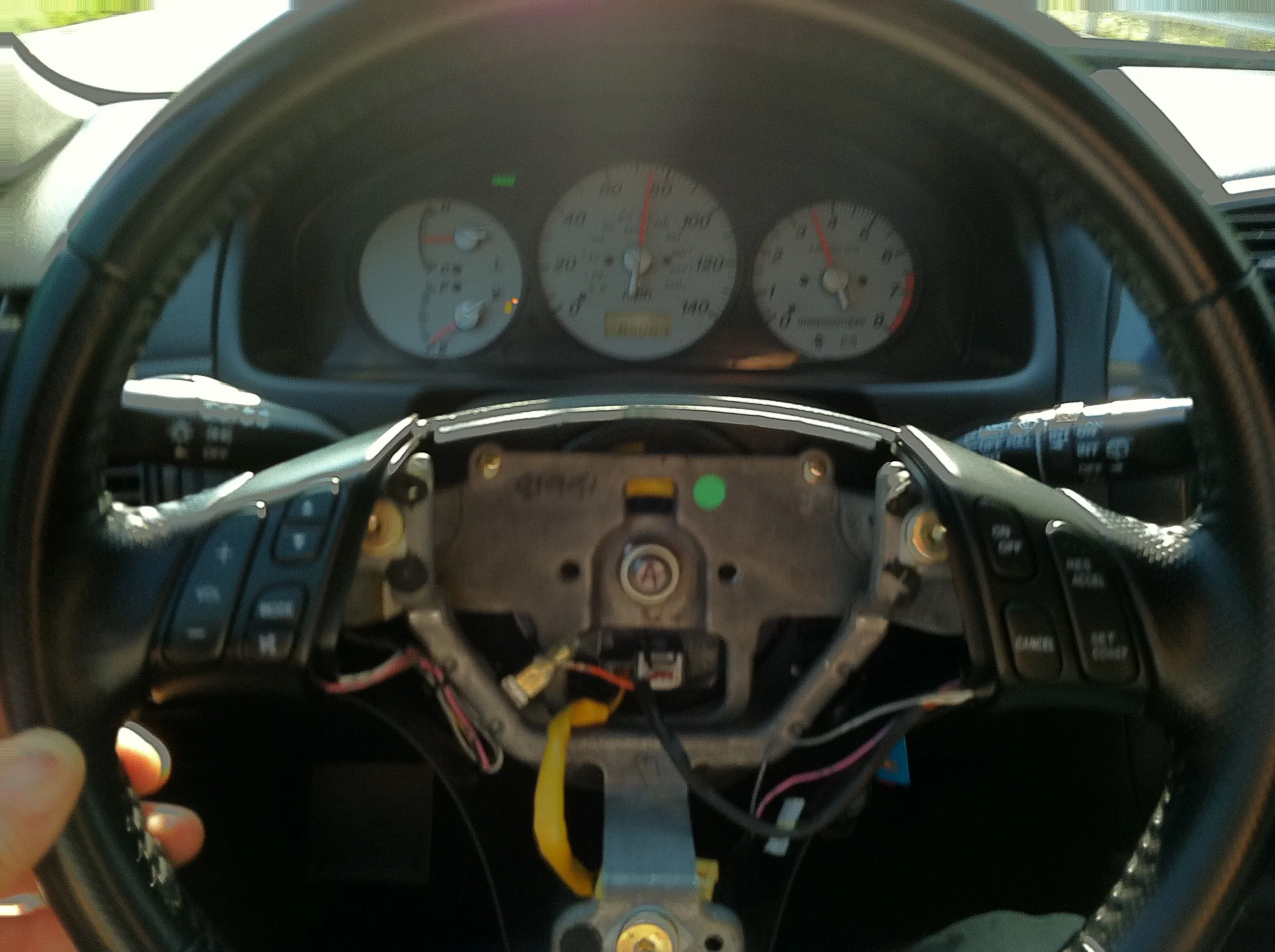

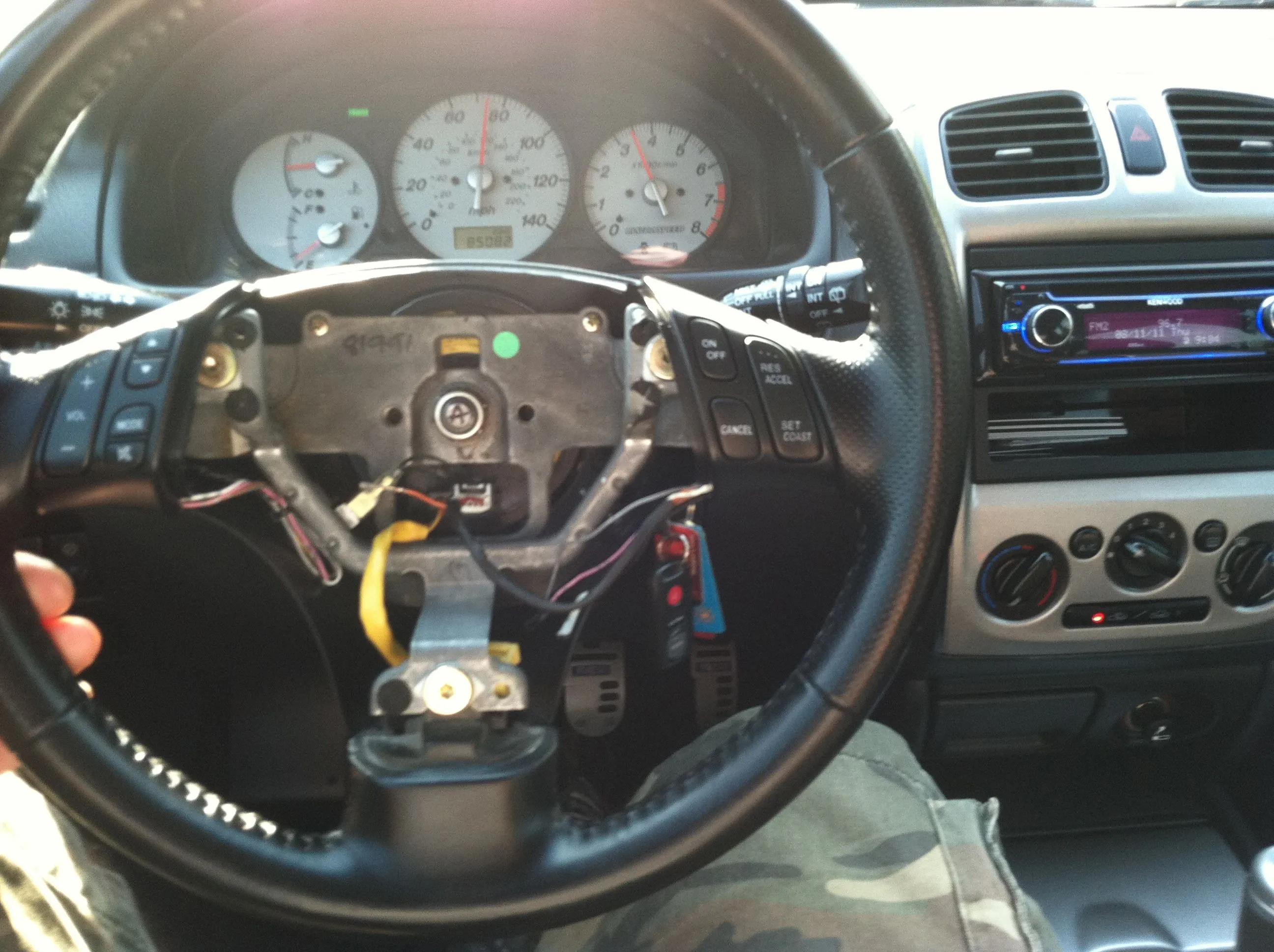

Very possible not that complicated i have a 2005 mazda 6 steering wheel in my protege 5.. And Love It!!

Does it use the same factory plug used in the Pro5 or did you swap in the new "clock spring" from the Mazda6?
Do you have the use of all of the buttons on the Mazda6 wheel too?

my main concern is the airbag, the controls wouldn't too hard.
are the plugs the same? will it still trigger with the rest of the system?
