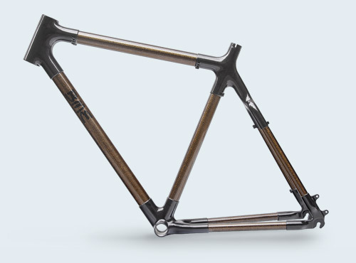

How can you bond two pieces of bamboo together and still retain the structural rigidity? How can you guarantee that there are no flaws or micro fractures?
Well, on the newest and greatest racing bikes, they are building carbon joints which the bamboo poles are fitted into. Some of the lightest racing bikes are not made from carbon frames anymore, but a mixture of carbon and bamboo. This is fairly recent and I have a big hunch its going to become really big in the next few years. I have no idea how you can guarantee their are no flaws, like I said there's still a a lot of debate about bamboo as a building material in the U.S.

OH, and heres a picture referring to how they build the bamboo bikes. This is exactly how I would also do it.
