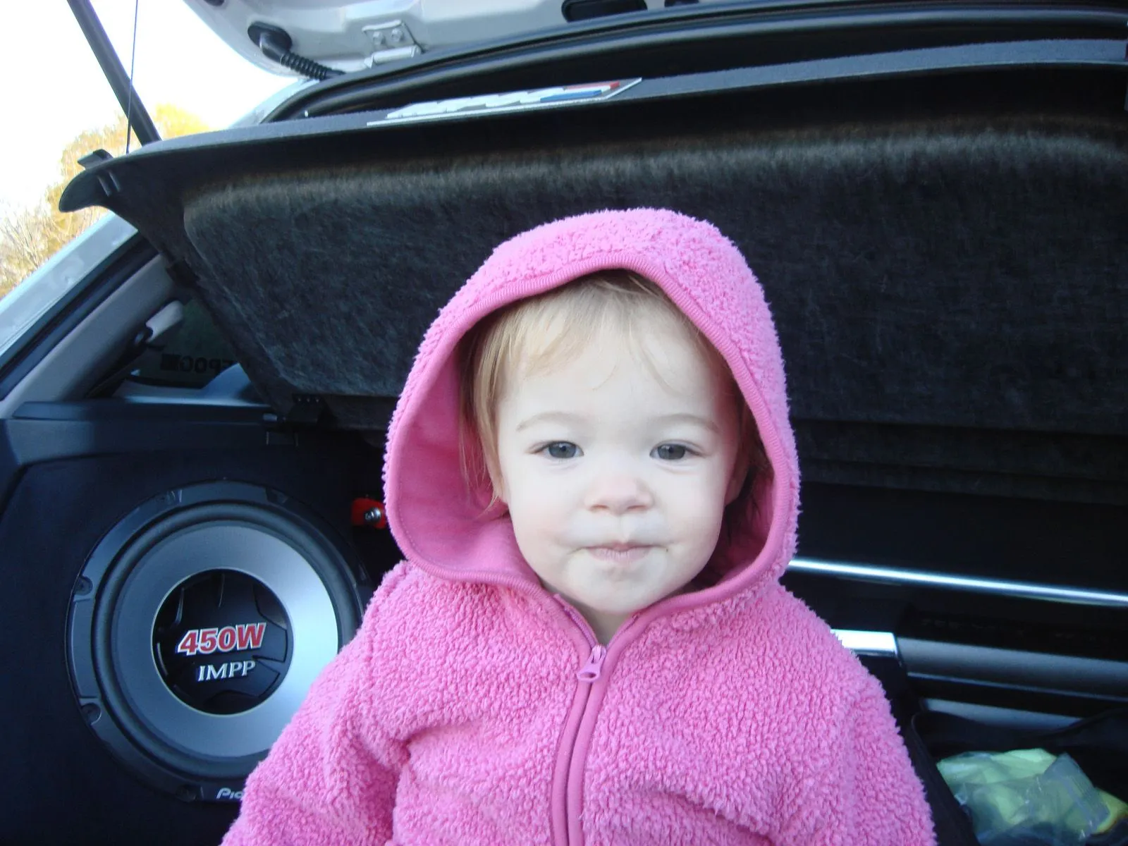

+1...he did a great job!

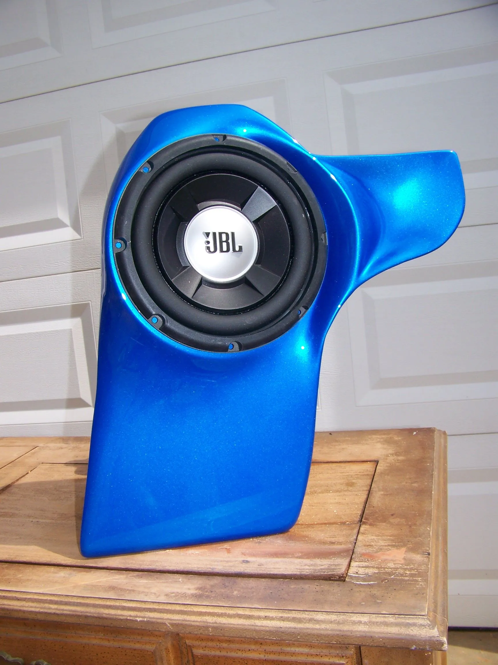

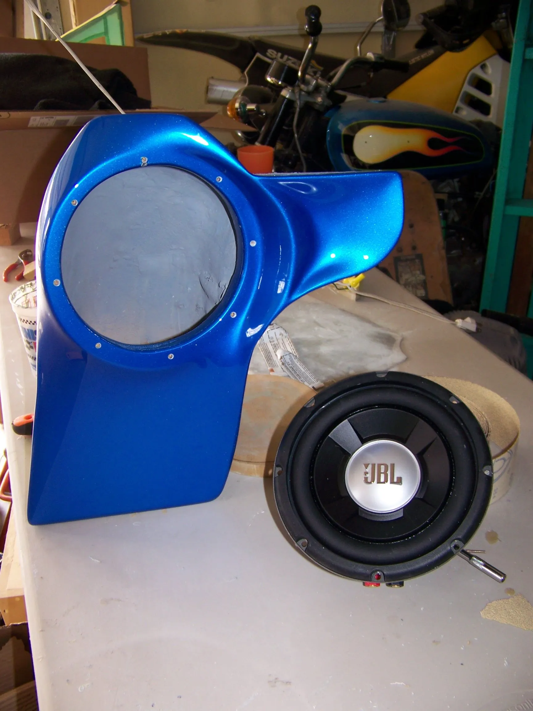

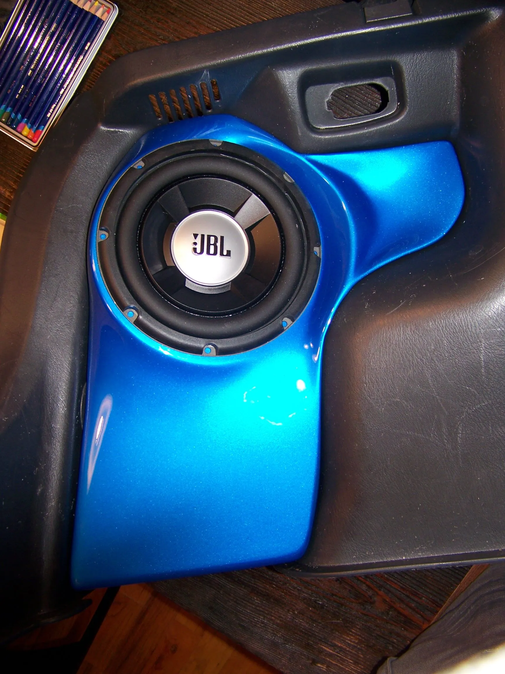

Thanks for the writ up it motivated me to build this for my Wife's car!!
