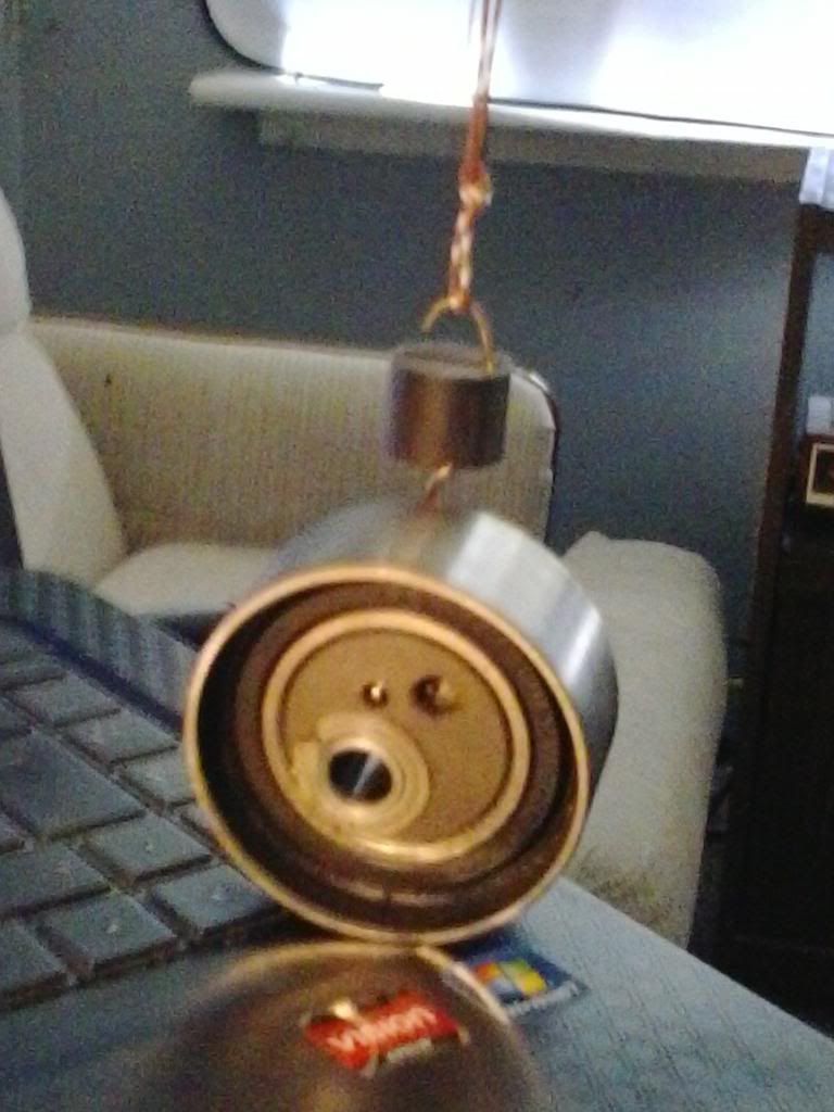

Install tensioner and idler pulley
See what number hex wrench fits in the new tensioner, mine was #5
Set aside the tension spring and install the tensioner, not fully tight
Rotate the tensioner so the spring hole is at the top, then tighten the bolt
Install the tensioner spring and loosen the tensioner bolt
Install the idler pulley
,... I needed to attach the tensioner spring to the tensioner pulley before installing it,... it couldn't be attached with the pulley installed.
The tensioner pulley is free floating with the bolt tightened (there is some damping friction though).
I attached the tensioner spring to the attachment pin AFTER installing the T-belt. The spring is a critical part and can very easily become over stretched while installing the belt. I attached a piece of wire (loosely) (or maybe string) to the spring and draped it up and over the fender so I could pull on the wire afterward to attach the spring to the attachment pin with the help of a small flat head screwdriver (its really hard to reach in there to attach the spring after the T-belt is installed). The wire (or string) needs to be attached loosely to allow it to be removed after the spring is on the pin.
