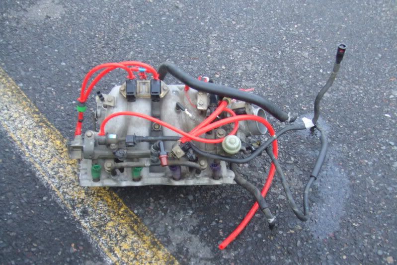

Here is a pic of the old intake manifold before swapping everything:

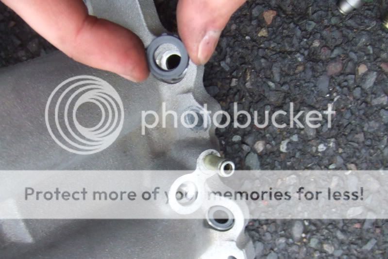

Here is a pic of the injector o-rings that are easy to forget:

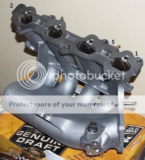

Here's an update. The car has been idling really low and almost stalls so I decided to check for a boost leak. I made a leak tester very similar to the one here. It revealed a leak off the manifold by the passenger side which is unfortunate. I'm going to loosen all the bolts and retorque them. Is this the proper torque pattern?
Well crap. I loosened all the bolts and retorqued correctly at 15lbs and used my leak tester but it shows a leak at the same spot! I'm going to put another gasket where the spacer and intake manifold meet. Do you guys think this will solve the problem? What is my next step if it doesn't?

the spacers are not perfect. there can be and most likely are imperfections on the surface. my spacer had noticeable imperfections around some of the runner holes. not a big deal... i cleaned each side up as best as possible to ensure they were as smooth and flush as possible, then i added the gasket.
Alright, but what did you do to clean the spacers? Sandpaper?
just used a straight edge to knock any burs loose. i also LIGHTLY ran a file across the surface to even it out. i would not use sandpaper.
most likely, the additional gasket will fix your problem.
I agree, use a straight edge to make sure the circumference is flat on both sides of the spacer, this is the most important thing to make sure it seals. If not then use a really fine file to make sure it's flat. Better to file it a bit then to risk a vacuum leak. And of course you need 2 gaskets anyway to run a spacer, one on each side.
I put the new gasket on and I don't have the nasty knocking I had before. I hooked up the leak tester and I could still hear a very faint hissing. I sprayed some choke cleaner all around and the idle didn't rise. I'm wondering if the JoeP Fuel Pressure Regulator is pushing some air out of it when I pump air into the system. Any thoughts?
