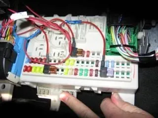

I used the add a fuses from auto zone instead of tapping into sources. Right under the glove compartment extended the electrical about 12" or so for all 3 found a good gnd and it all worked great.
Red wire/ fuse 37 White/ fuse 81 Amber/ fuse70.

I got 3 for like 5 bucks....... its goes in replace of the fuse in the box and you then put the actual fuse in the top and the wire that comes out you connect to the guage.... look here
Pic taken from (javanc)

If you want before you go spending more $$ , just try the orange to the horn lead under the stearing colum. I have no idea the what wire it is thought thats why i went to the fuse block..lol
where exactly is this fuse box under the glove compartment?
In the ms3 it is right under a cover right behind the glovebox.... Sorry man I didnt realize you had a mp3.... I did a little searching and it seems its in the same place on the mp3.. If you feel around right under the glovebox there is a plastic cover and under that is 2 plastic tabs one on the left/right. You just turn them both to unlock the panel and it should drop down.
