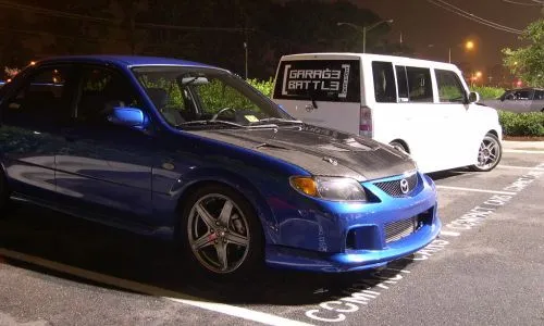

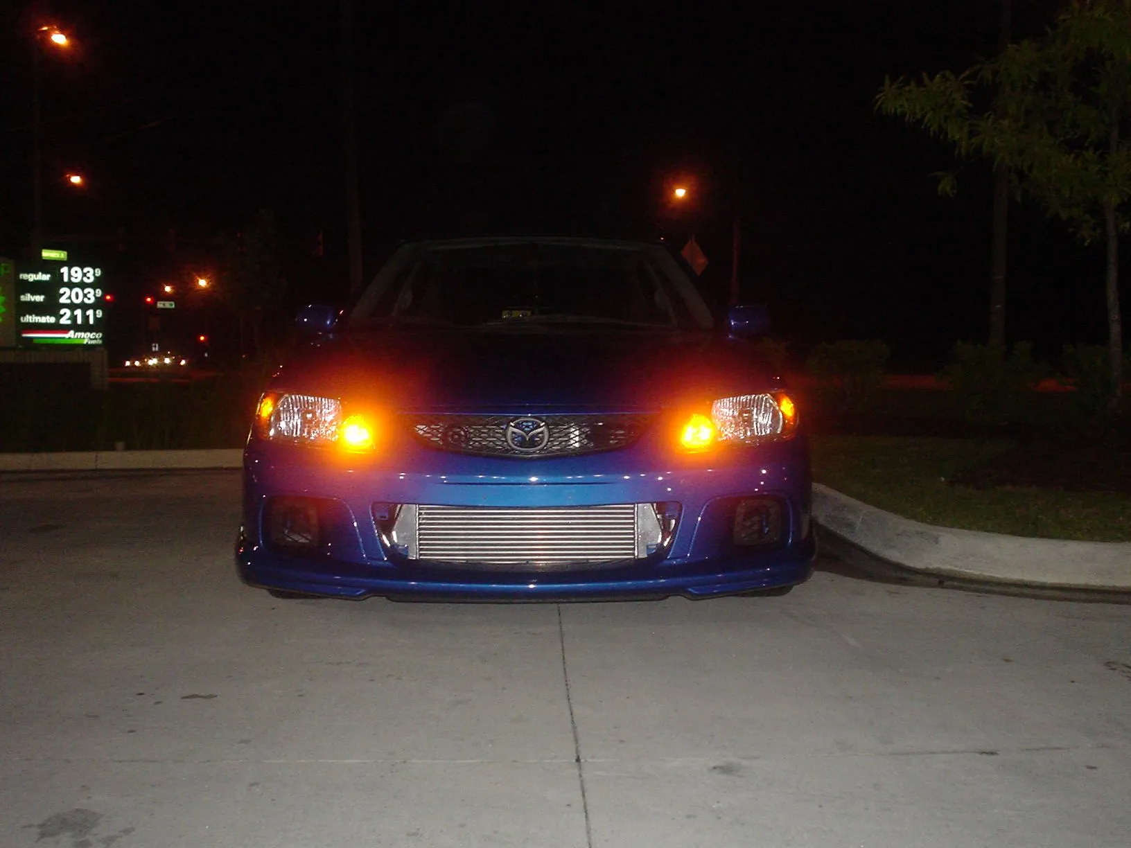

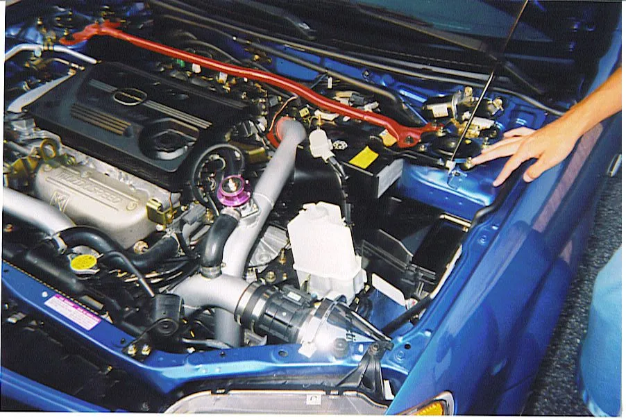

Mine has never had any problems. Sounds just like the type s should and I dont have a duel bov setup. Here are some pics. PM me if you have any problems.
You are re-circulating. I think we are debating over vented BOV's without a dual setup. And yes Notorious i will agree each MSP is different however i know it can work because mine has worked, along with other people. I guess it's just the luck of the draw.
