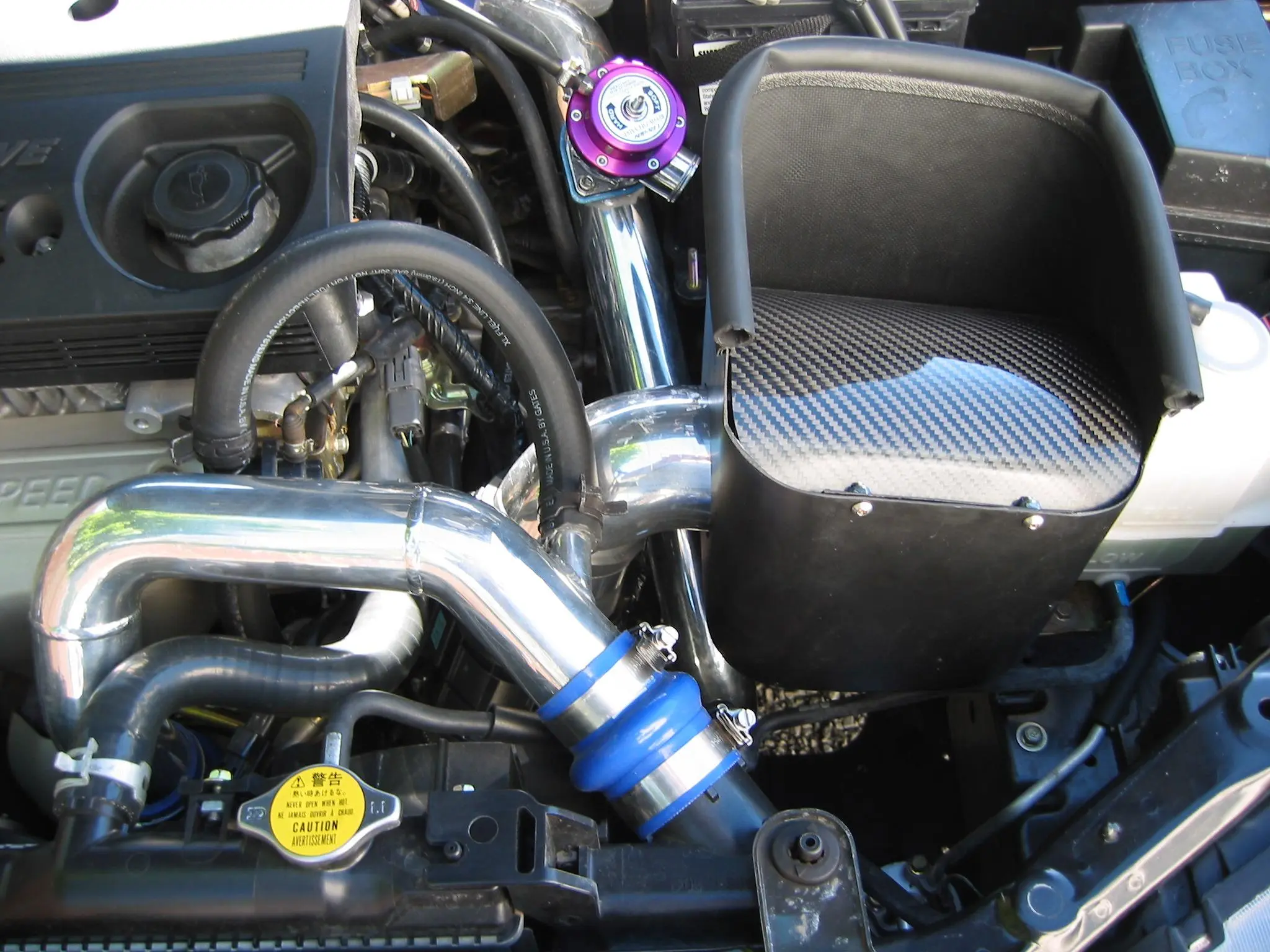

Hey Youre explanation of this whole topic is the one that helped me understand the best. Does anyone have any pics they can post of what the "dual setup" should look like. I have a greddy bov installed and im not sure if my installer did the correct dual setup. Pics help alot!!
Here is a pic. You can see the Greddy (purple) on its flange venting to atmosphere with a vacuum line attached. The large hose from my Turbo-IC pipe is running to my stock BPV (also connected to a vacuum line) recirculating to the intake. You can't see the BPV because I have a short SRI with the Ram-air duct and the BPV is connected right before the turbo. Gives you an idea of what you have to do though. Once you have this done all you have to do is adjust the screw on the BOV until you don't stall. The louder you get the BOV sound (the less pressure required for it to open), the more likely you are to stall. Mine never stalls and let's off a loud sound at 4K+ rpm.
See, my setup looks alot different than that. Ima try and take a pic and show uu guys, maybe u could give me some tips. Thanks..pic coming soon
