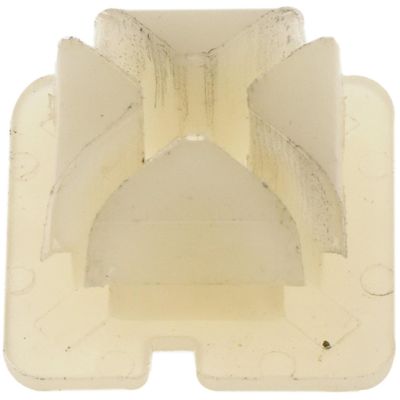

Then I bought a nylon push-in bolt like this one:
4
and it did the work. I used nylon screws to make sure that it will not rust again.
I had a similar problem with mine when I removed the former owner's license plate to put ours on. I believe one came out, but the insert within the door was loose and would not allow the screw to go back inside because the insert was spinning. The screw on the other side would not turn at all, so I cut it off with my angle grinder. Being that the door was made of plastic, I think I used something like the clip shown above. I filled the old holes with black silicone (because our 5 is black), drilled new ones just beneath it, installed new clips, sealed around them with the black silicone, and away we went... I used stainless hardware to prevent corrosion. The plate still covers the old holes. If you do it carefully you'll never see it once the plate is on.
