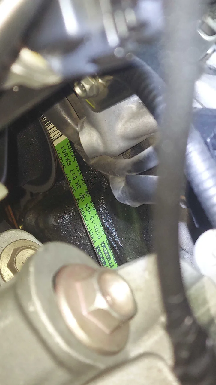

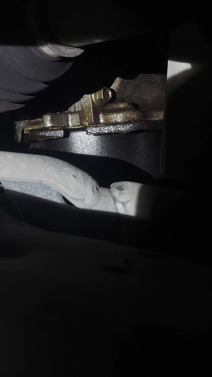

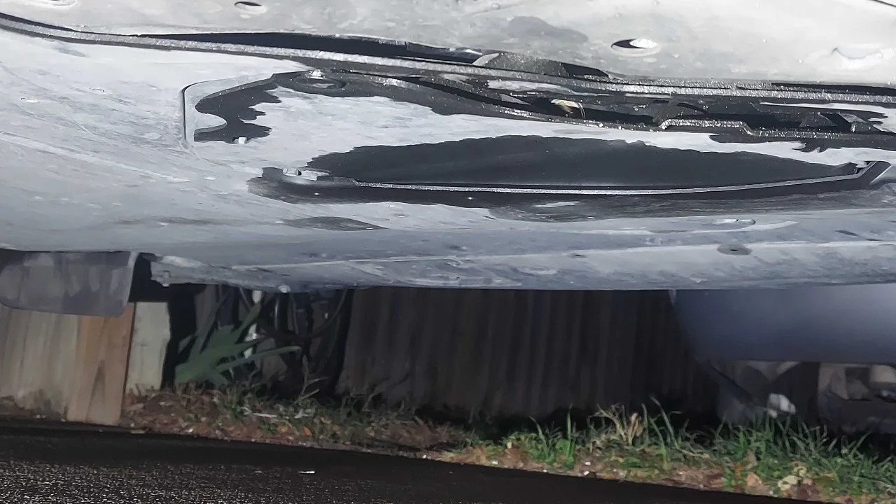

PPI noted possible oil leak on 2021 CX-5 I'm thinking of buying
Took back to dealership and they say they fixed it, citing valve cover leak.
I don't recall seeing oil around the valve cover after the PPI. I took these photos after the inspection that seemed to be telltale signs of a timing cover leak based on what I've seen from others here. I didn't smell any burning or feel loss of performance or misfires which seem to be common valve cover symptoms. The shop I took it to recommended a dye test. I plan to ask the dealership if they performed that test. Considering this is a car I'd be buying from them, I'm a little skeptical it's a valve cover leak especially since I changed a valve cover on my 05 Altima. Plus, this being a known issue with these cars, I have feeling they're just saying it's a valve cover rather than timing cover to avoid a longer job on a car they're selling.
I let the car run and didn't see any drops on the ground.

pictures are not very good but appears like the notorious leak of the timing cover.
Its on the expensive side if you gotta pay for fixing it.
Valve cover rarely leaks on those. Its either the timing cover/pan or the oil control valve that leak.
Assuming its not a crqcked head issue, unlikely.
How many miles? I would probably pass on that car

Yeah I had no luck getting the camera in a good spot but there's definitely wetness on the cover.
The car has 67k miles on it. The price is $22k but they offered to take off some for transmission and differential fluid changes. That was before the PPI find of the oil leak. The sway bars had some play too, mechanic said it's not bad but will be something to be addressed in the future.
