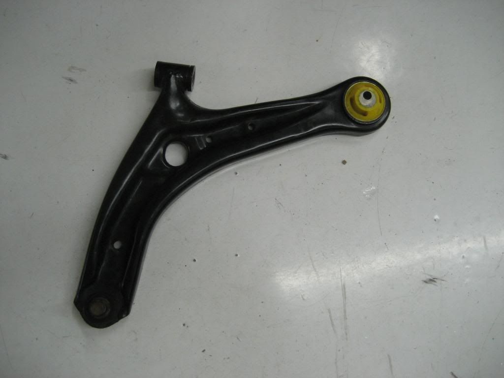

The ball-and-socket control arm bushing is not legal for SCCA STF competition, but is a really nicely designed piece if you aren't autocrossing the car. Instead, I used a Whiteline part (yellow) for that one bushing as seen here. You simply install it as shown (see offset center hole) to maximize the additional caster. It isn't much...about a half degree or so. No huge deal.

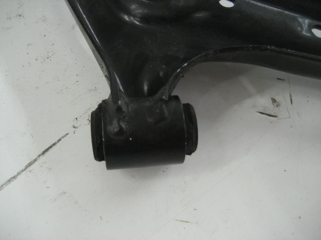

Here's the stock version of that part. The slot is not for adjustability, but instead allows it to be more easily installed. Installation is simple with a press, and some sockets or other tube receivers used to press out/in the bushings. Make sure and get the depth right as the bushing does not bottom, and the orientation.
To do the smaller bushing, you first cut off the rubber ends of the OE bushing with a suitable tool (hacksaw, dikes, knife, etc.). This allows it to more easily be pressed out, and also allows for a receiver to be positioned on the one end.

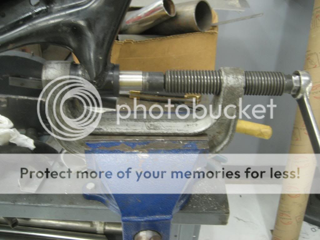

Here's the tool I used for the smaller bushing, since it is a challenge to get it on a press. This clamp-style bushing press is available from Harbor Freight for cheap. In this pic, you can the center sleeve of the Powerflex bushing going in.
