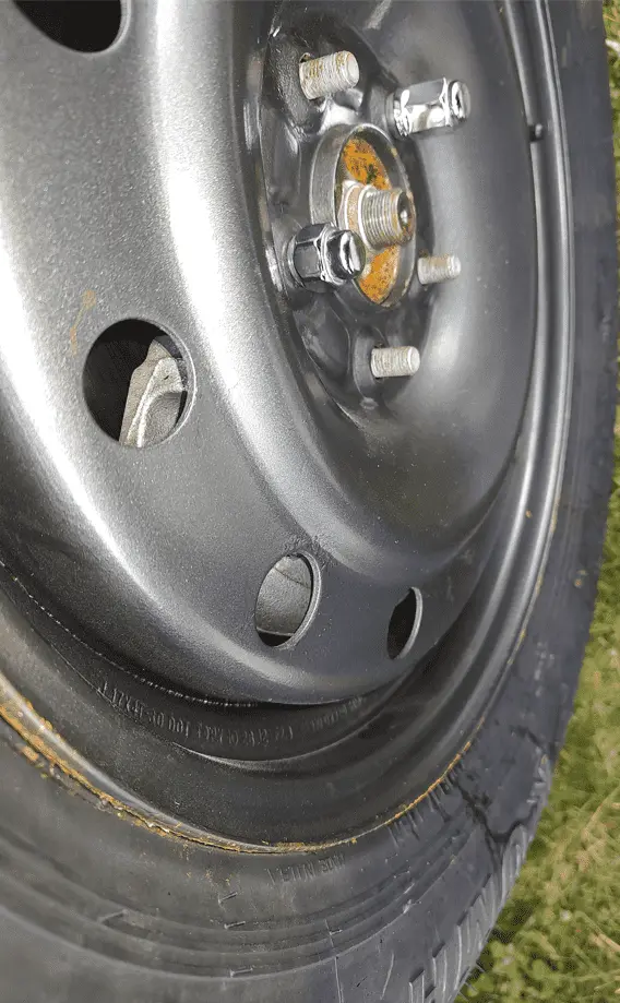

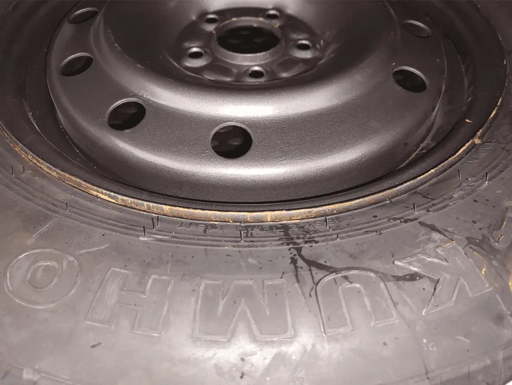

Update:
For anyone considering painting their rims.
Rims take alot of abuse.
My DIY of a Kia Sorento spare went well with corrosion/rust removal and priming but the final finish and clearcoat did not hold up to the tire mounting process.
The process on a steel wheel involved:
Rust removal involved vinegar gel, steel wool, and wire wheel. Scuff up paint, sand, Wash, Dry few days(outside sun and in heated bldg.)
Removed all the rust except for that rust which was unreachable (by traditional methods- sandblasting would have got it all). Unreachable rust included rust stuck in rim crevice or some rust that may have been within the pitted areas.
* Note the paint did not fail at the rim crevice or pitted areas. It failed at the flange.
Then 2 coats Rust-Oleum Rusty Metal Primer, sanding in-between. Final sand. Dry.
Then 2 coats matte black, sand, 1 coat semigloss clearcoat, Dry several days.
Had tried to scratch surface and appeared paint was well adhered.
However, upon mounting, the black finish & clearcoat finish separated from the primer leaving the brownish red(rust colored) primer visible along the flanges of the tire.
While still ok for a spare that is rarely used and kept in boot, the final product is not acceptable for the full-size rims that are driven in harsh conditions and seen every day.
Spent past few weeks trying to figure out what went wrong with process but just don't think a DIY process is for painting the whole rim(unless you are just maybe painting the face)
Have decided to spend the winter searching for a good sand-blaster that will use delicate abrasives as well as good paint shop that will professionally paint/not powdercoat the rims.
May have to ship to a shoppe if nothing local within an hour.
