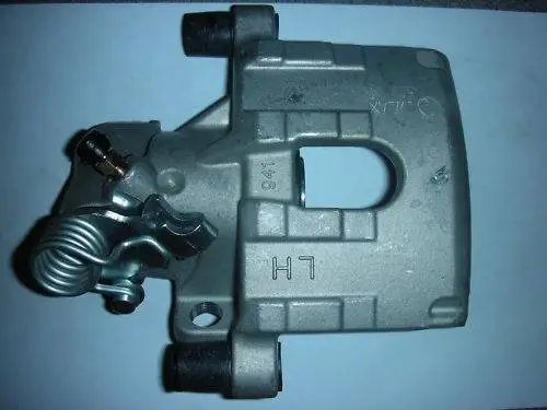

Parking brake is a mechanism linkage. I suspect the ‘silver’ spring in this pic was reinstalled incorrectly.
Try to manually engage the parking brake cable at the rear wheel. That little part that looks like a gate latch? That’s the one. Spin your wheel, pull on that. If the wheel keeps spinning? The caliper is at fault. If it it stops? The cable itself may have stretched or snapped somewhere.
