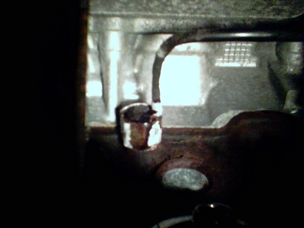

  • One weird thing I found after pulling the exhaust shroud) was the lower left exhaust manifold bolt (facing the engine from the front of the car) was hanging on by only one thread, and covered with oil. I've never done any work to the exhaust - dunno how that bolt didn't fall out unless the shroud was keeping it in. I'm sure my cat is now toast given all that oil coming out of the exhaust.

On initial start I was blowing smoke from both ends - engine and tail pipe, but I think the engine part was just oil from the exhaust manifold and seems to be mostly gone now. To reinstall the bolt I found dangling I had to loosen all the exhaust manifold bolts because the metal gasket was in the way - hope that doesn't mean a bend or tear. It's on my list of things to replace, provided I can get the car running right in the short term (otherwise I'm going to take it out back and shoot it!). I left the shroud off so I can keep an eye on it.
