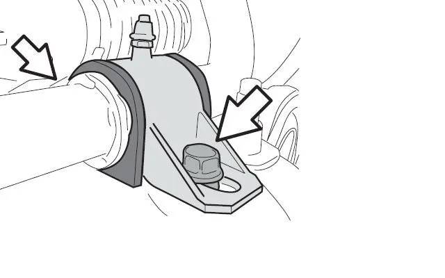

I get a popping noise when i drop the clutch. I just installed a cobb Front sway bar and it soulds like it is hitting the frame. Did anyone esle have this issue. Maybe the bushings brackets are in the wrong location.
Your problem may be the endlinks

I recently installed a Cobb RSB and after a few weeks I noticed a popping every now and then. I retightened my endlinks and bushings and it went away. I guess the bar had to settle in and be retightened.
