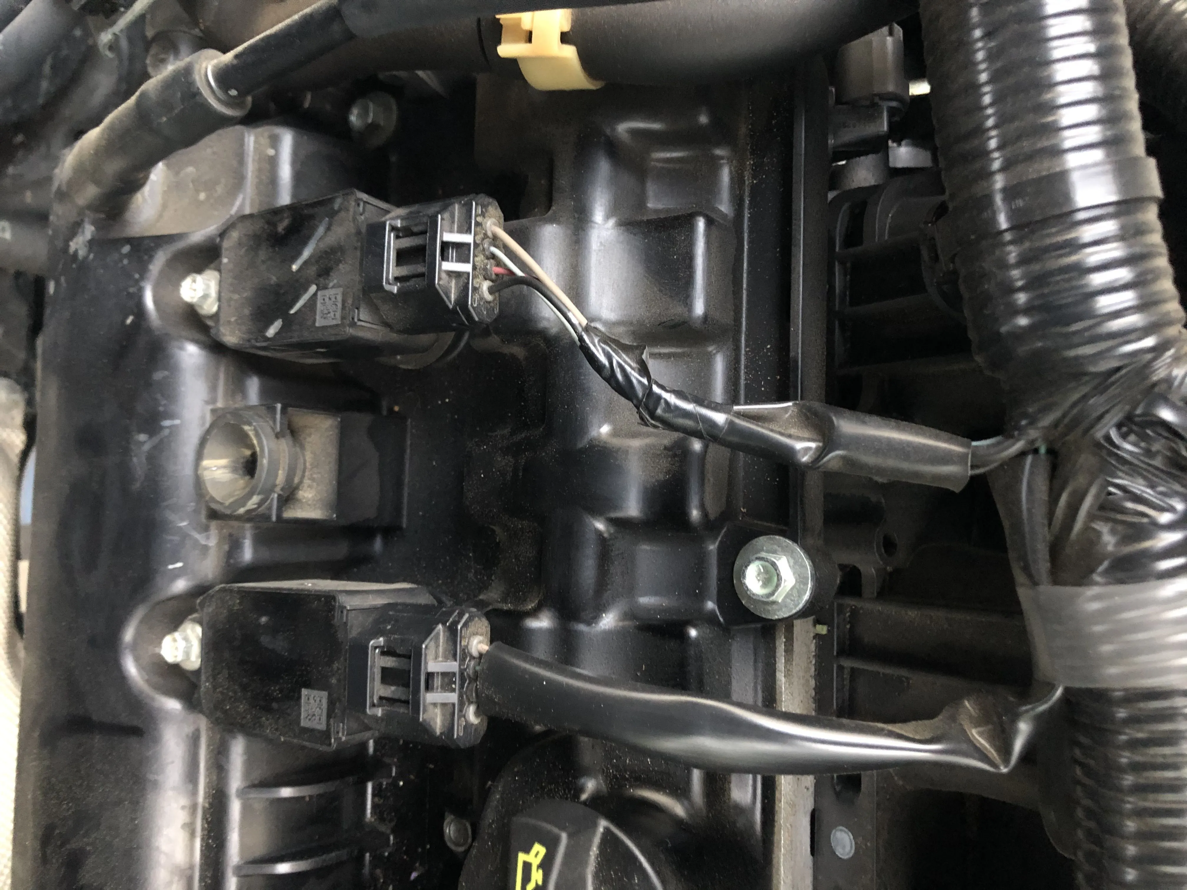

Today I decided to take a look at the plugs and I noticed my drivers side ignition coil has electrical tape on the wires leading to it where the others do not... Is this common on these vehicles. I've owned it since new and I've only had it serviced at the dealer or by myself.

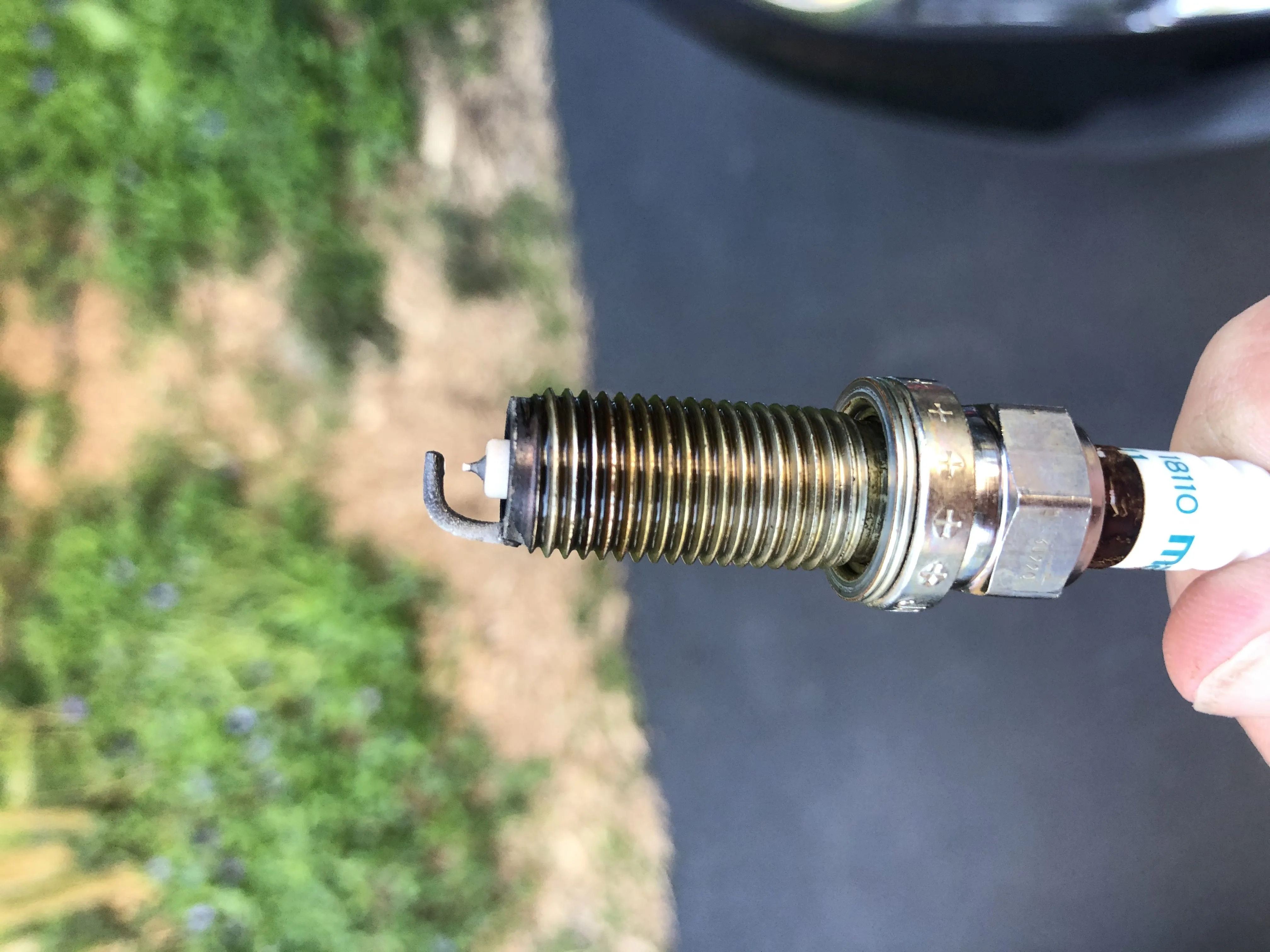

Second, it seems that there is oil coming up from my cylinders, there is a film of oil on the threads closer to the cylinder, and become clean as you reach the top of the threads near the valve cover...

That spark plug looks excellent. I would look at all the spark plugs and check for a oiled one. Then do a compression check. Then do an injector leak-down check. Ed
Agree, the plug looked great. If the other look the same, all good. I have tape on the wires leading to cyl 4 coil pack as well. Assume factory. As for MPG, does it have good power?

Okay spark plugs are good. Got it.
Wires going to coil 4... odd but factory. so I'm less worried.
