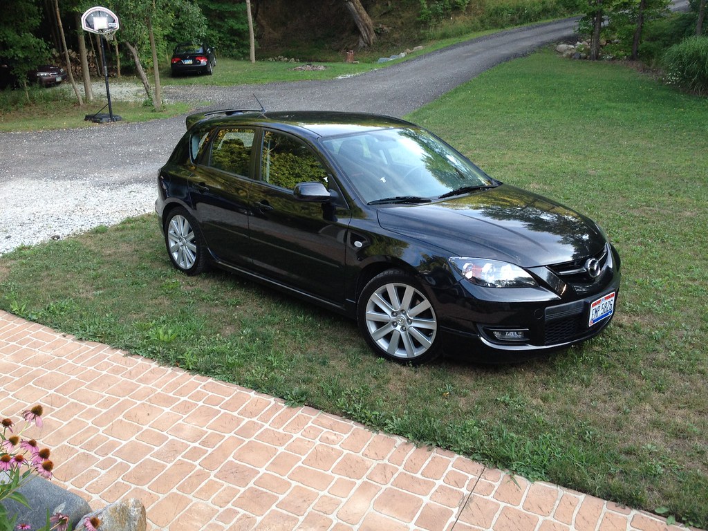

So a little bit of background on the car. I am the second owner, purchased July 23rd 2012, from a very nice 65 year old man. He admitted to the car being his mid life crisis, but he never modded the car and had an overabundance amount of paper work for the car. It was completely dealer serviced and taken car of by the same dealer every time.

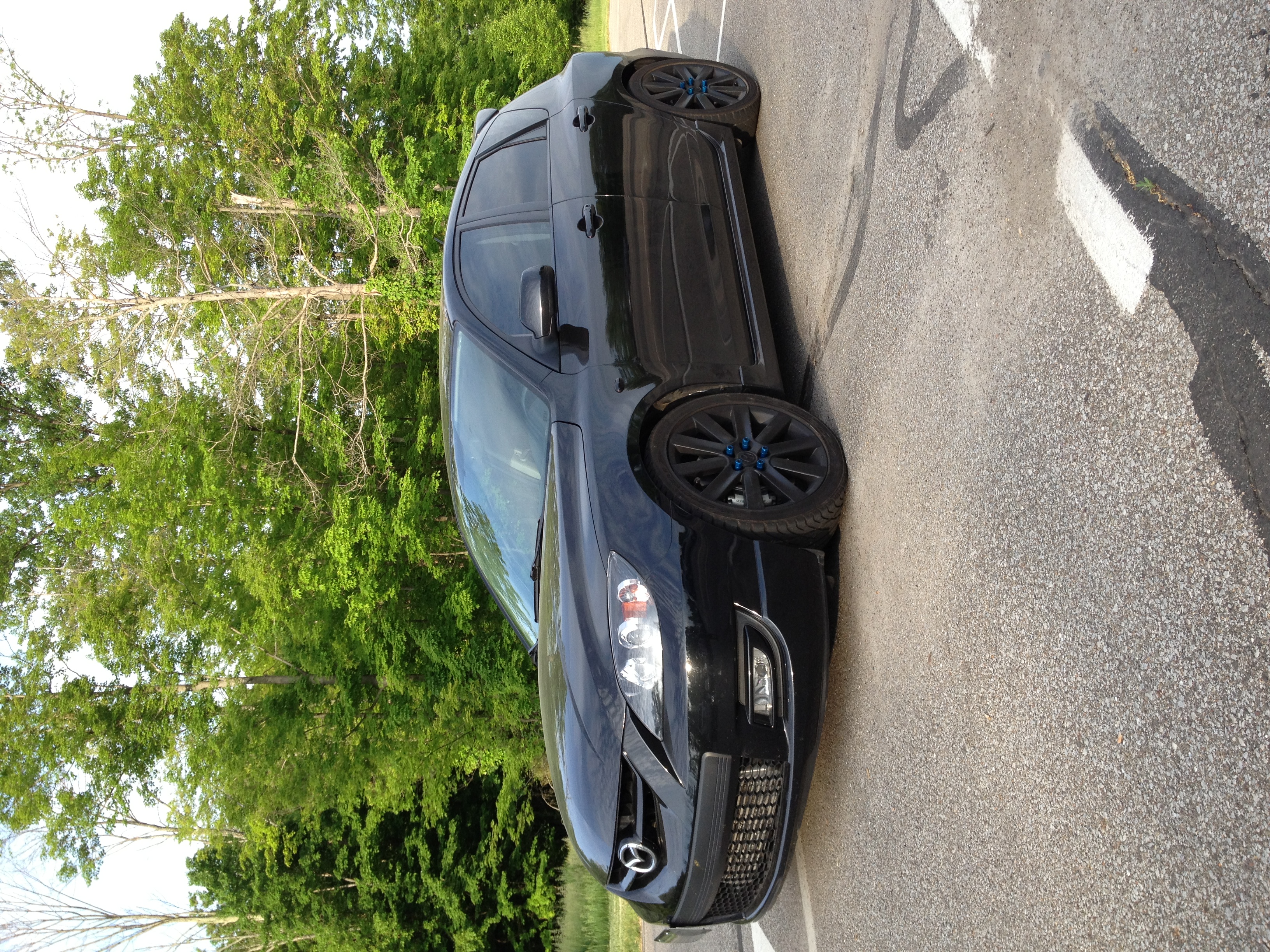

The day I brought her home:

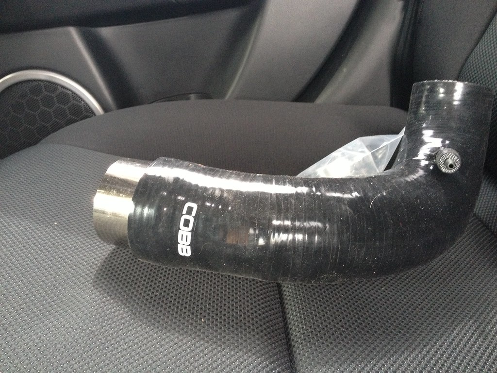

So I bought the car and told myself I like it just the way it is and I am not going to mod it because it has plenty of power... Well that lasted a full week and a half then she got a cobb intake and turbo inlet hose.

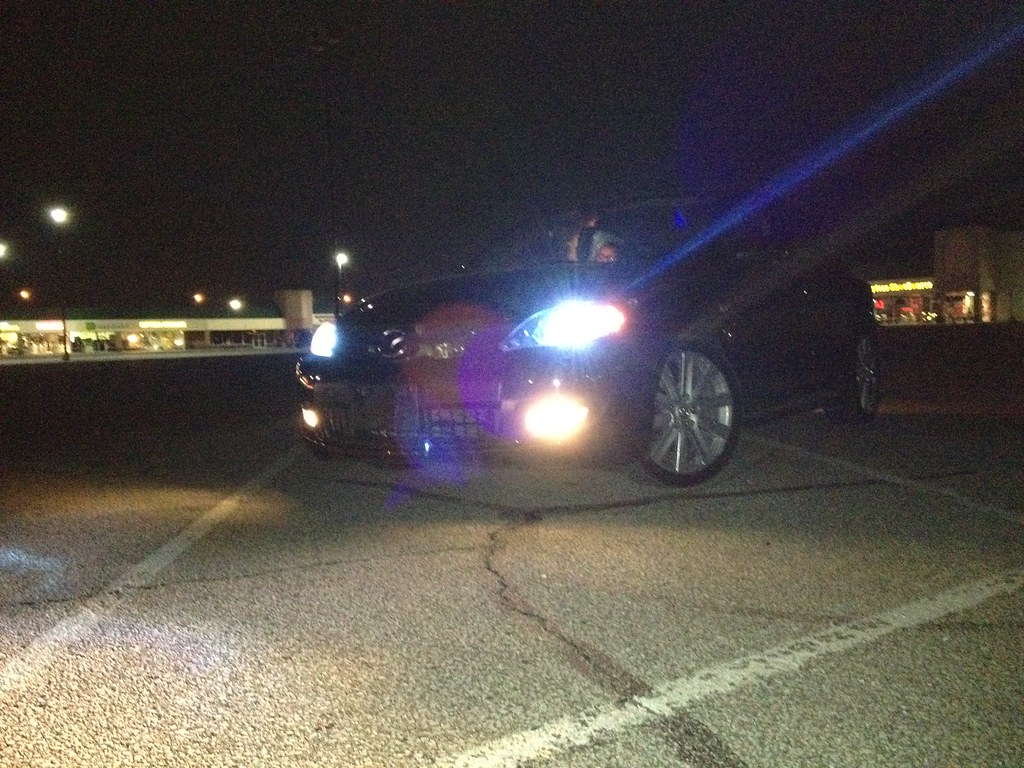

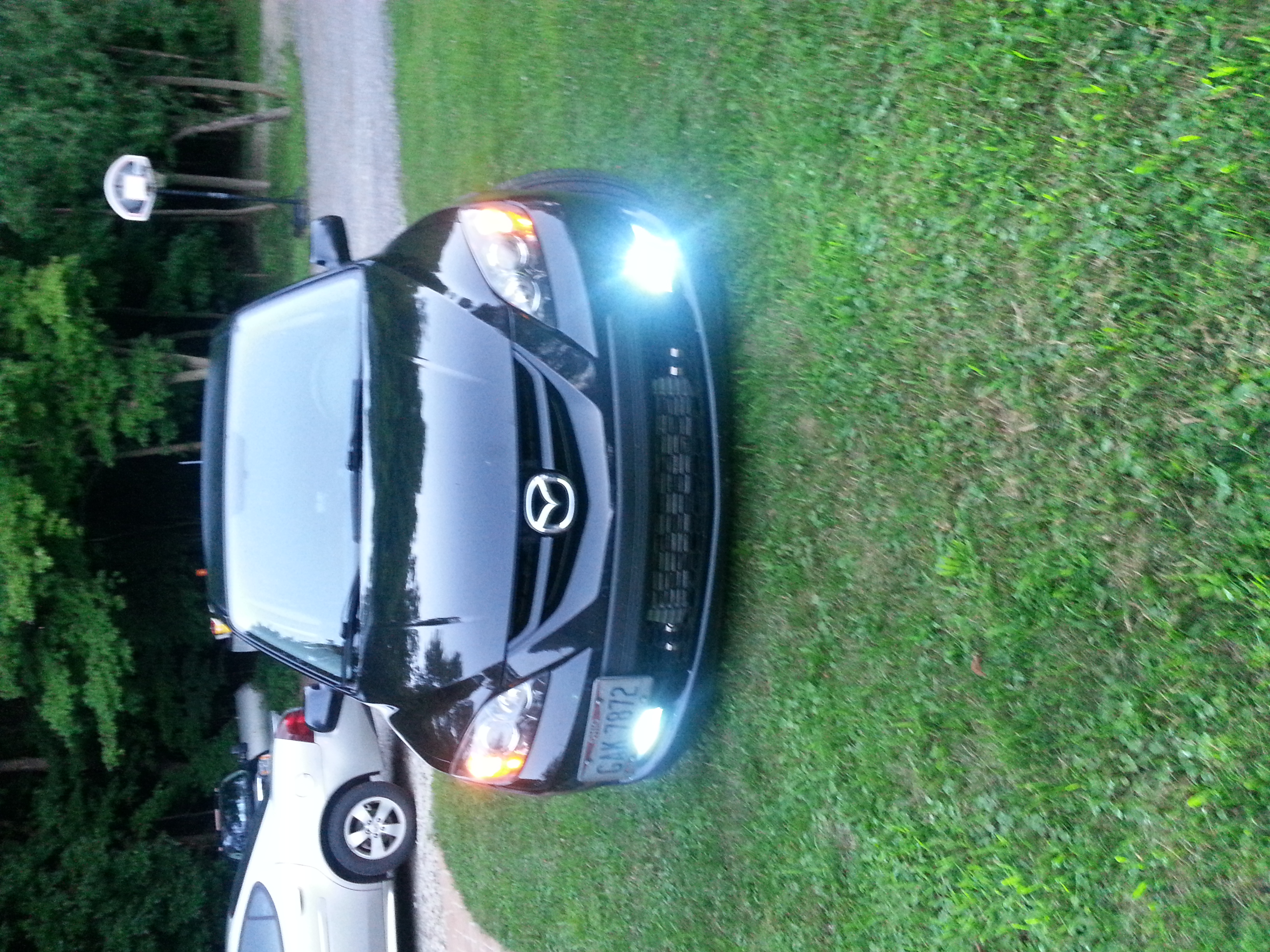

Same week I got a set of 35watt 8000k hid low beams

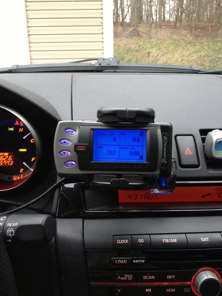

I got a dashhawk for an amazing price off Craiglist so I could monitor all my vitals and it would be one of the best purchases I every made for the car.

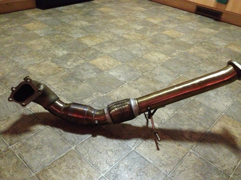

Soon after the RMM came the CNT Racing catted downpipe from the same friend mentioned above. I know I know I did all this before the internals. Do as I say not as I do. The car never blew up so I am good. Did have a few times that the fuel rail pressure dropped really low.
Now the car was running great it could breathe.

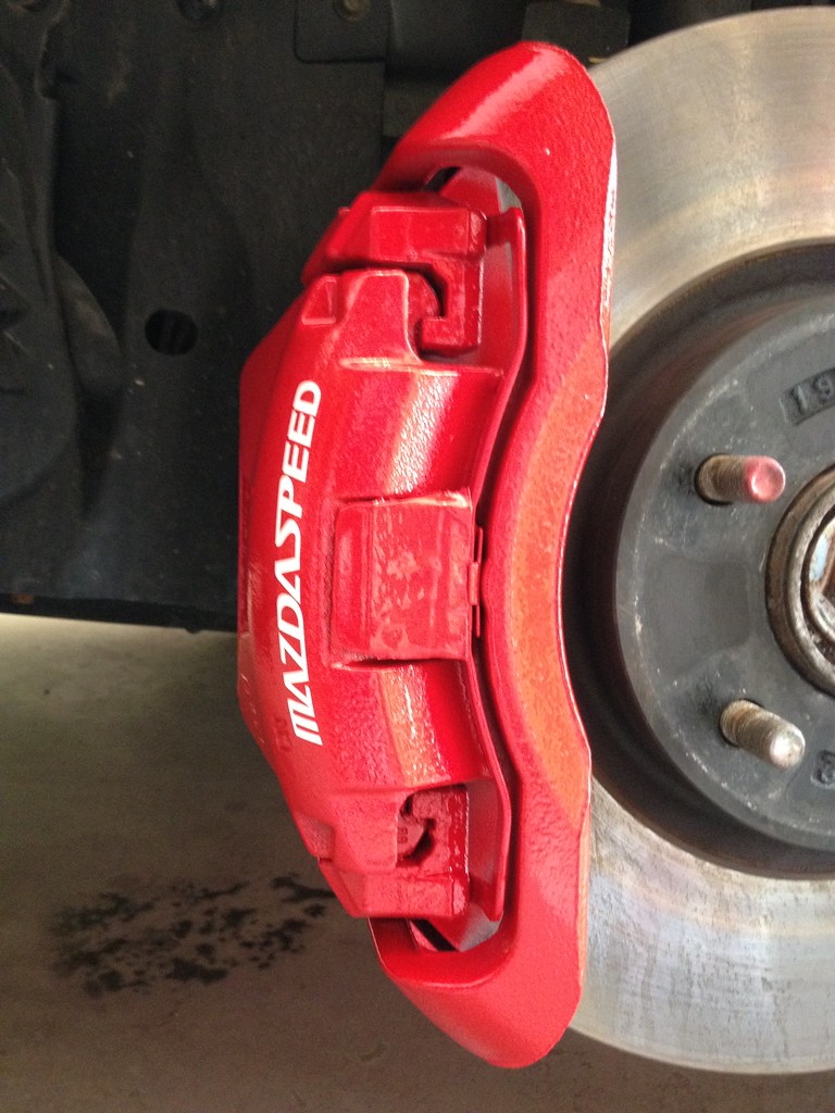

I painted the brakes now the first of a few colors Red

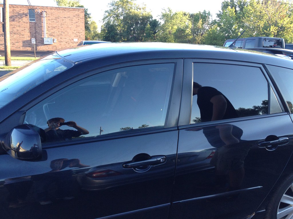

Tint: 50% front 5% rear also where I met a the first friend out of the mazda bigsho

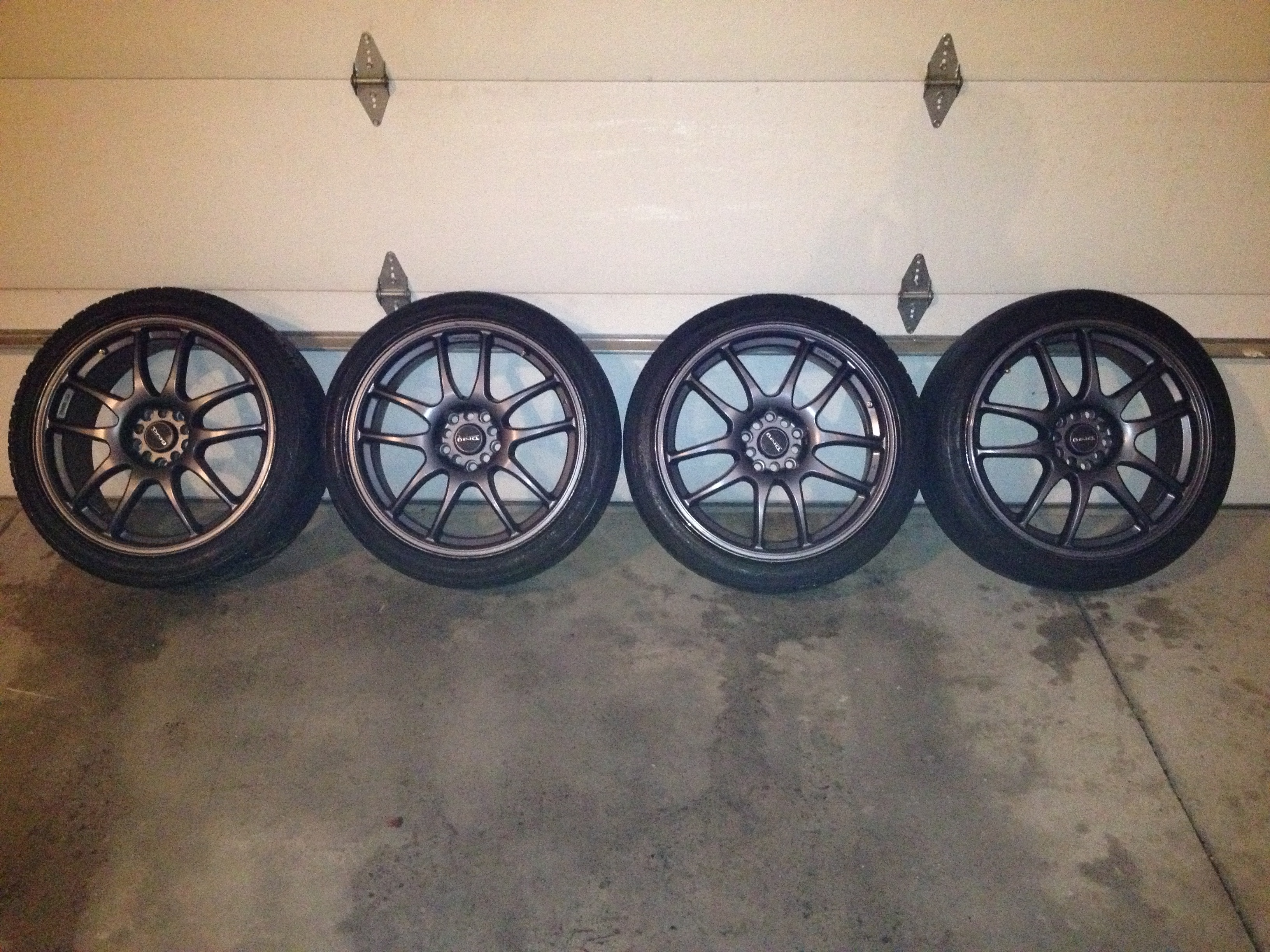

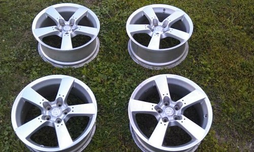

picked up a set of rx-8 wheels on trade for a cheap netbook I had
first of many sets of these. What a world of difference

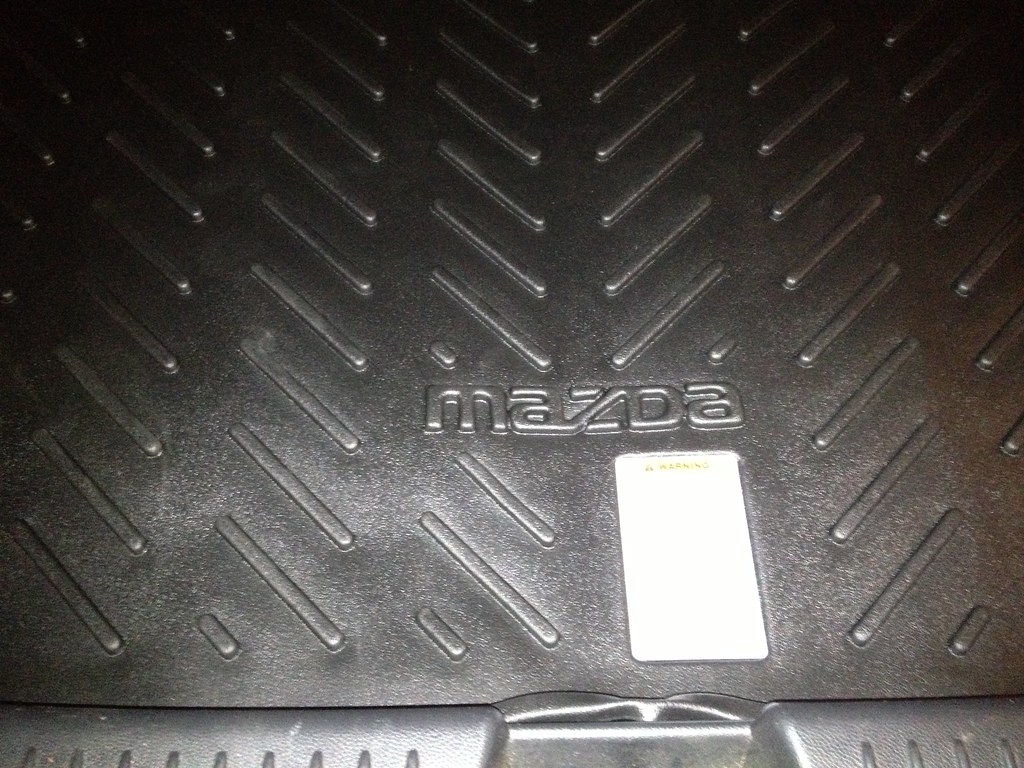

Mazda Cargo mat

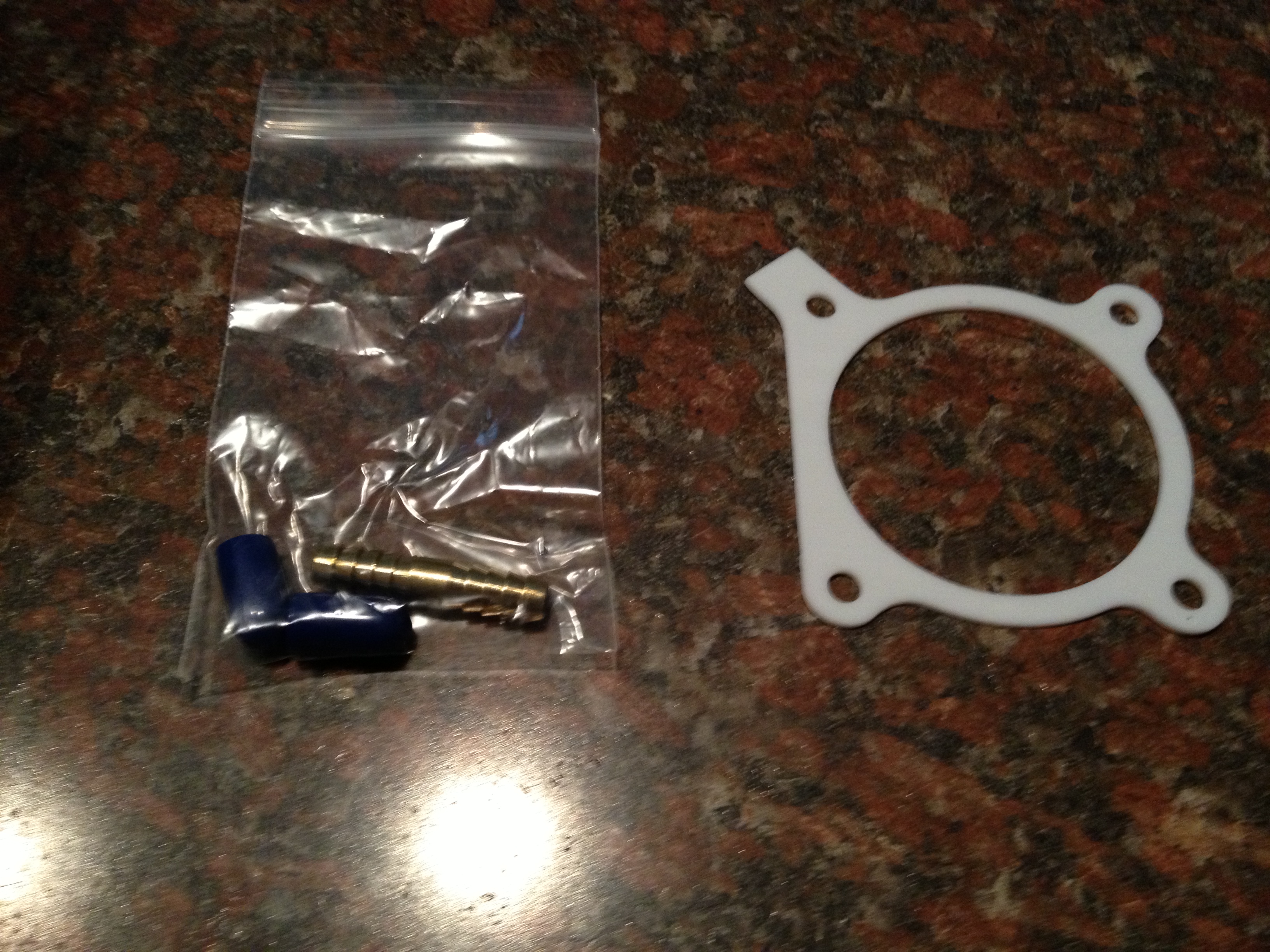

Mishimoto OCC

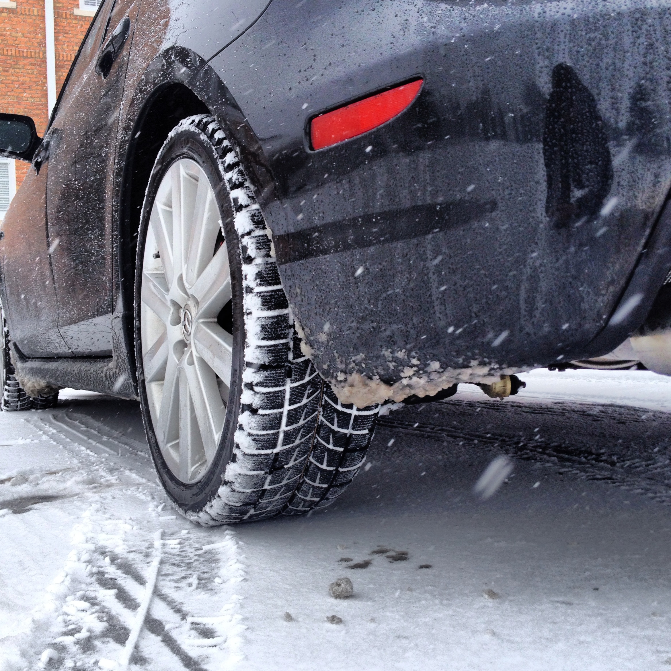

Picked up a set of life saving blizzaks

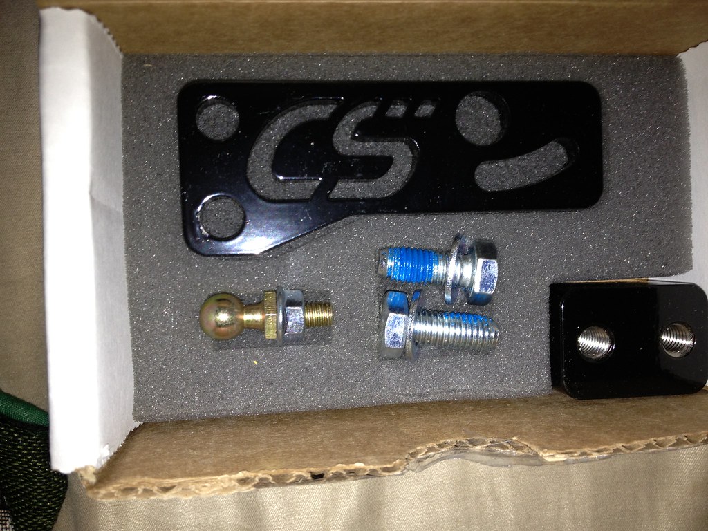

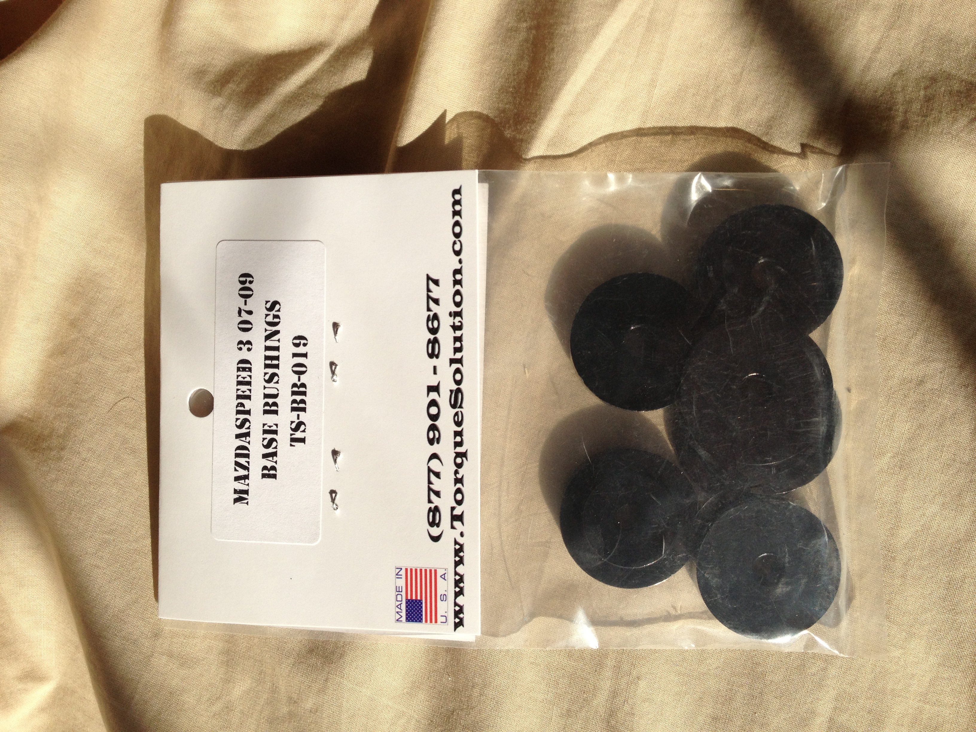

Also got a set of shifter bushings for Christmas as well

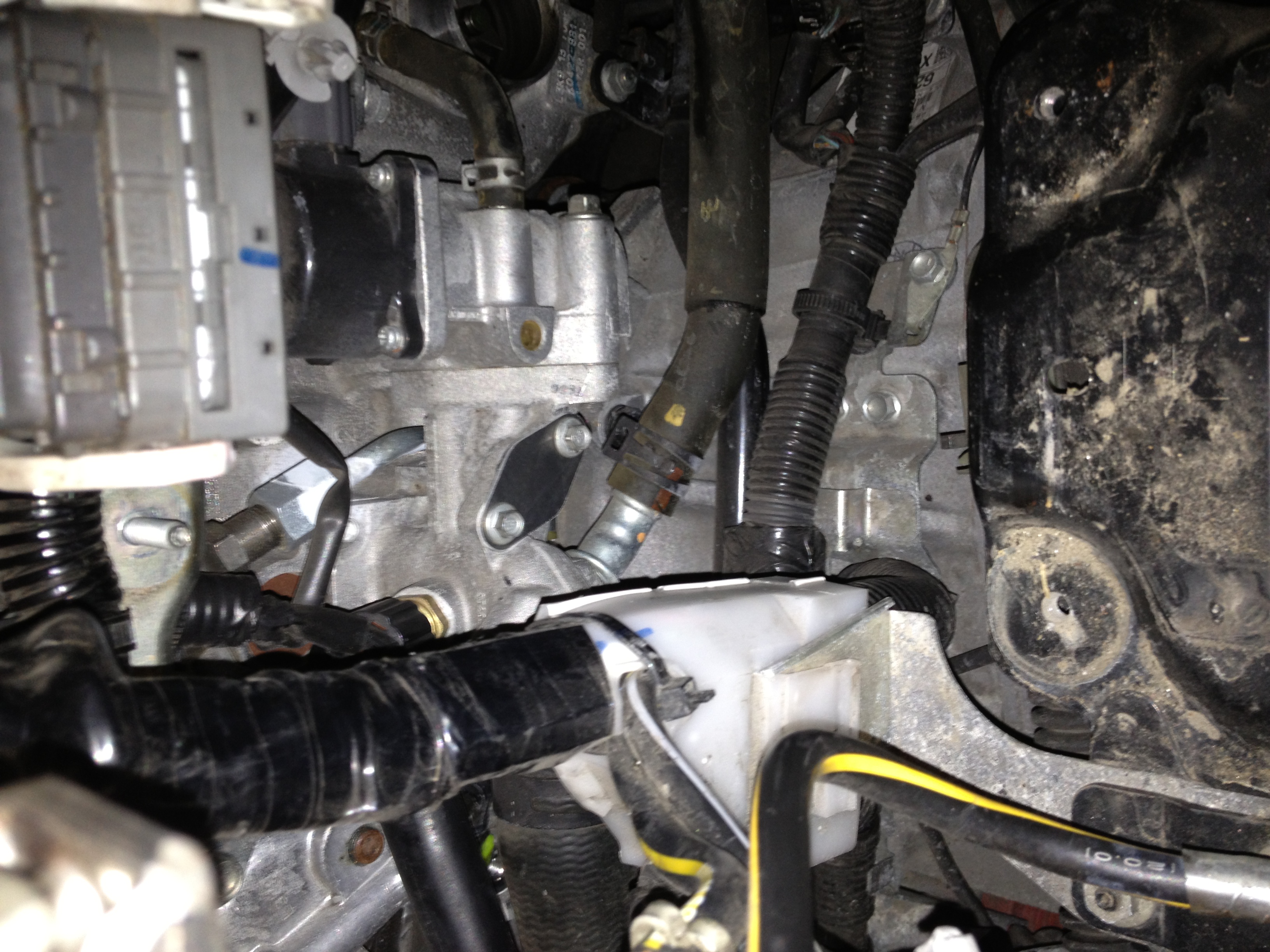

JBR EGR block off

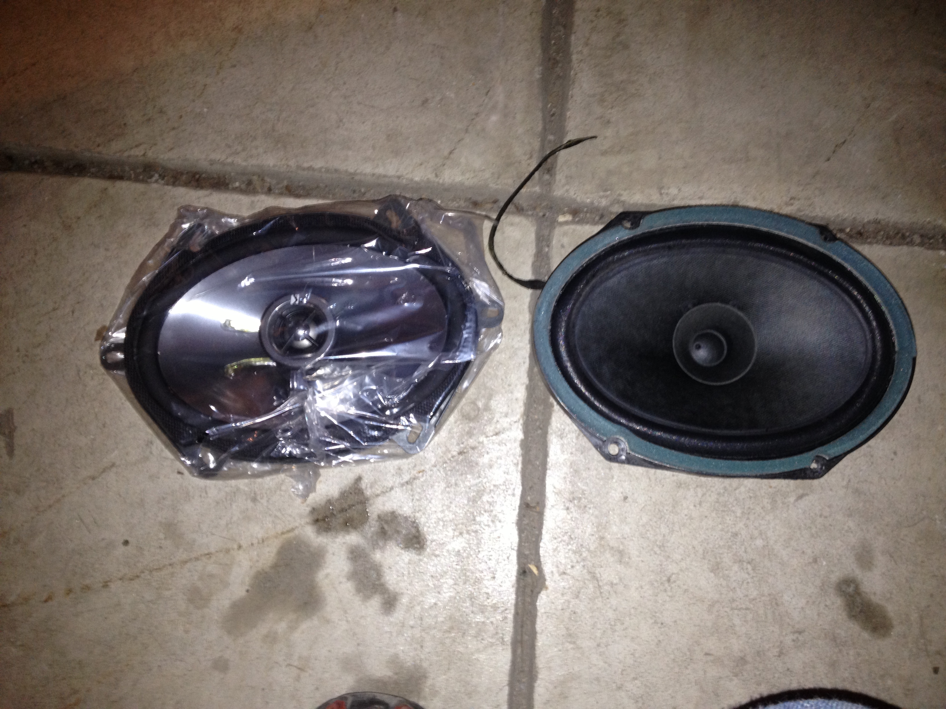

Mom and Dad got me the Speaker upgrade

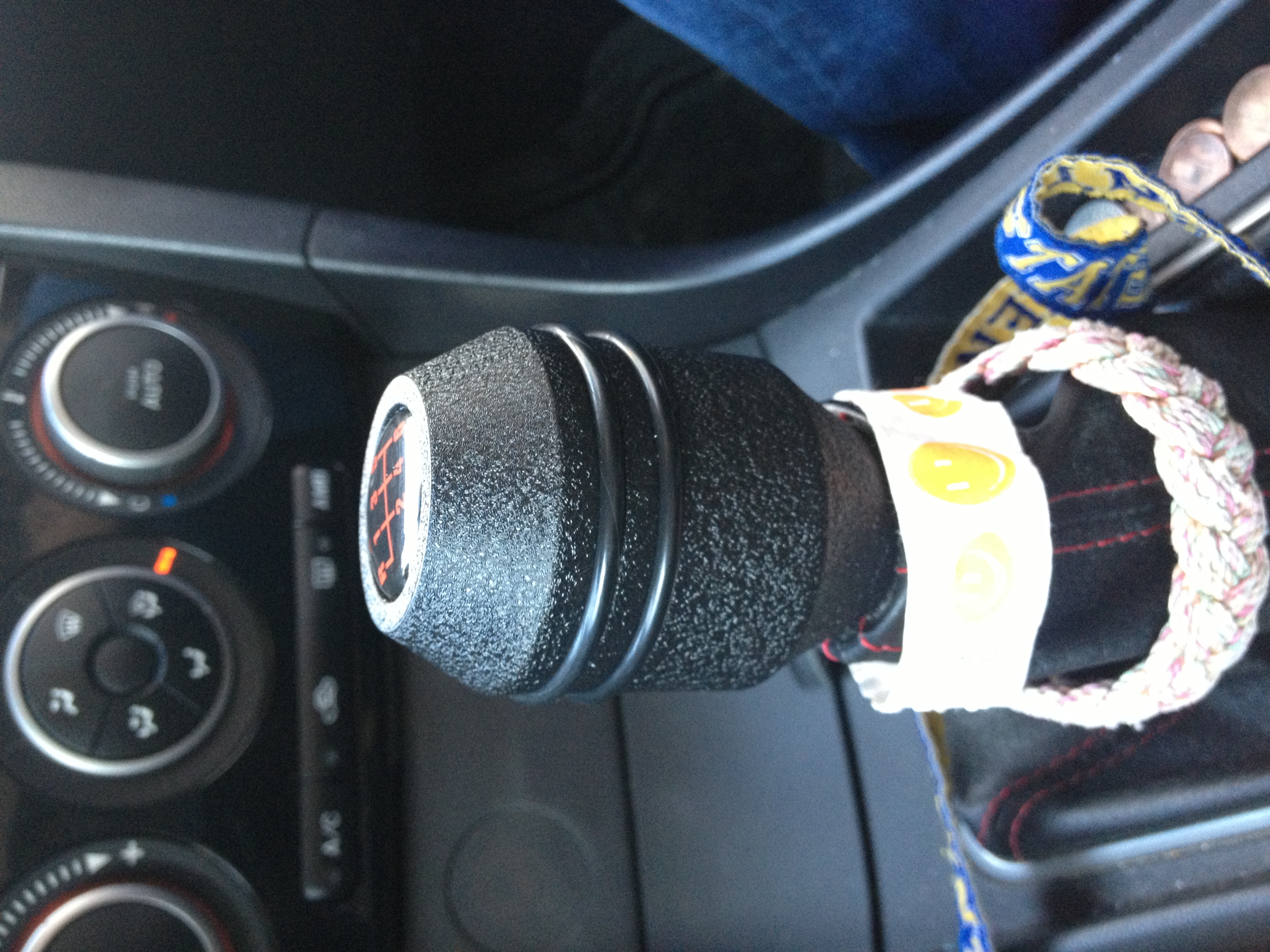

Aunt got me the JBR knob

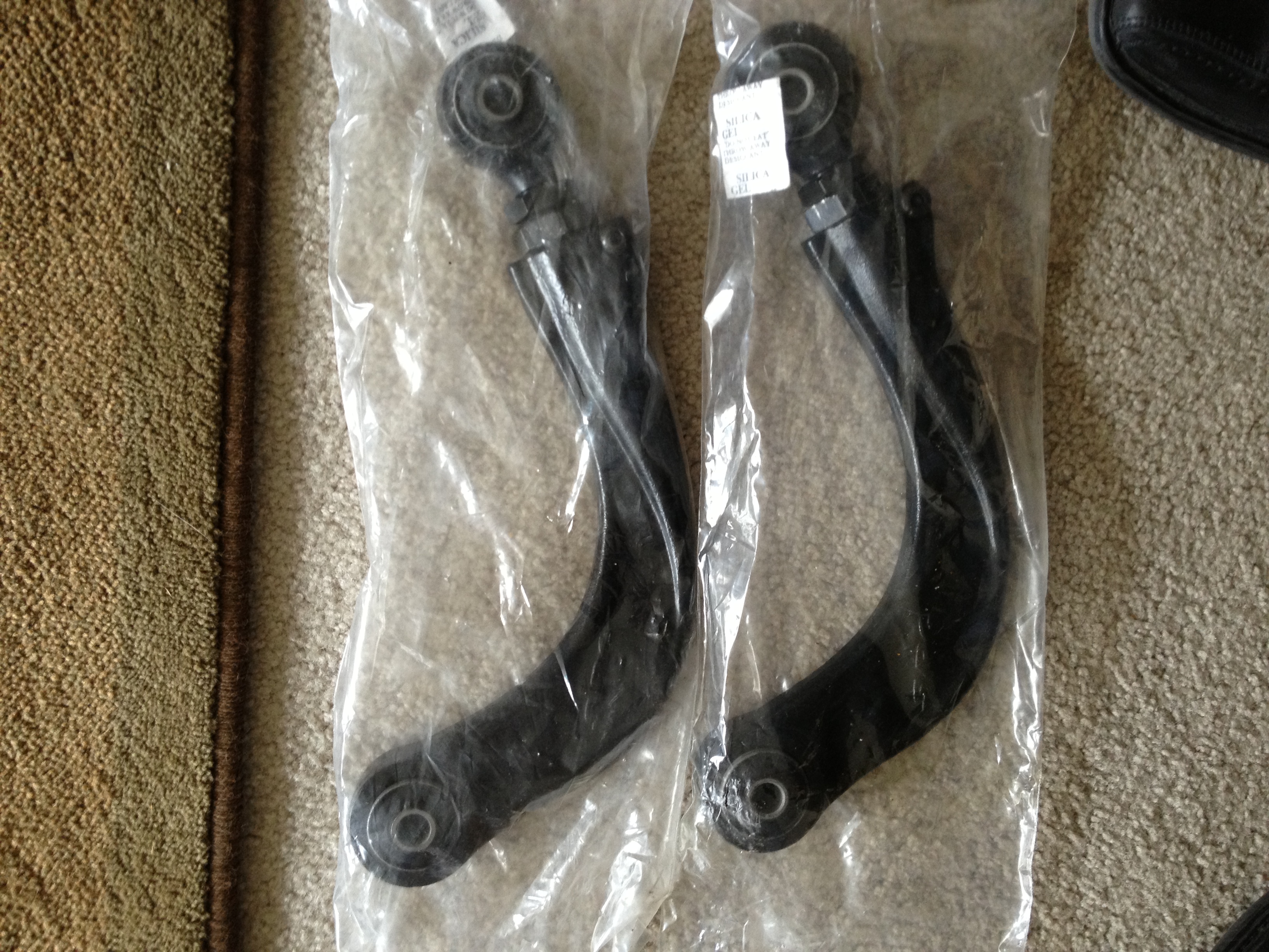

Next was the H&R coilovers, with the SPC adjustable rear camber arms

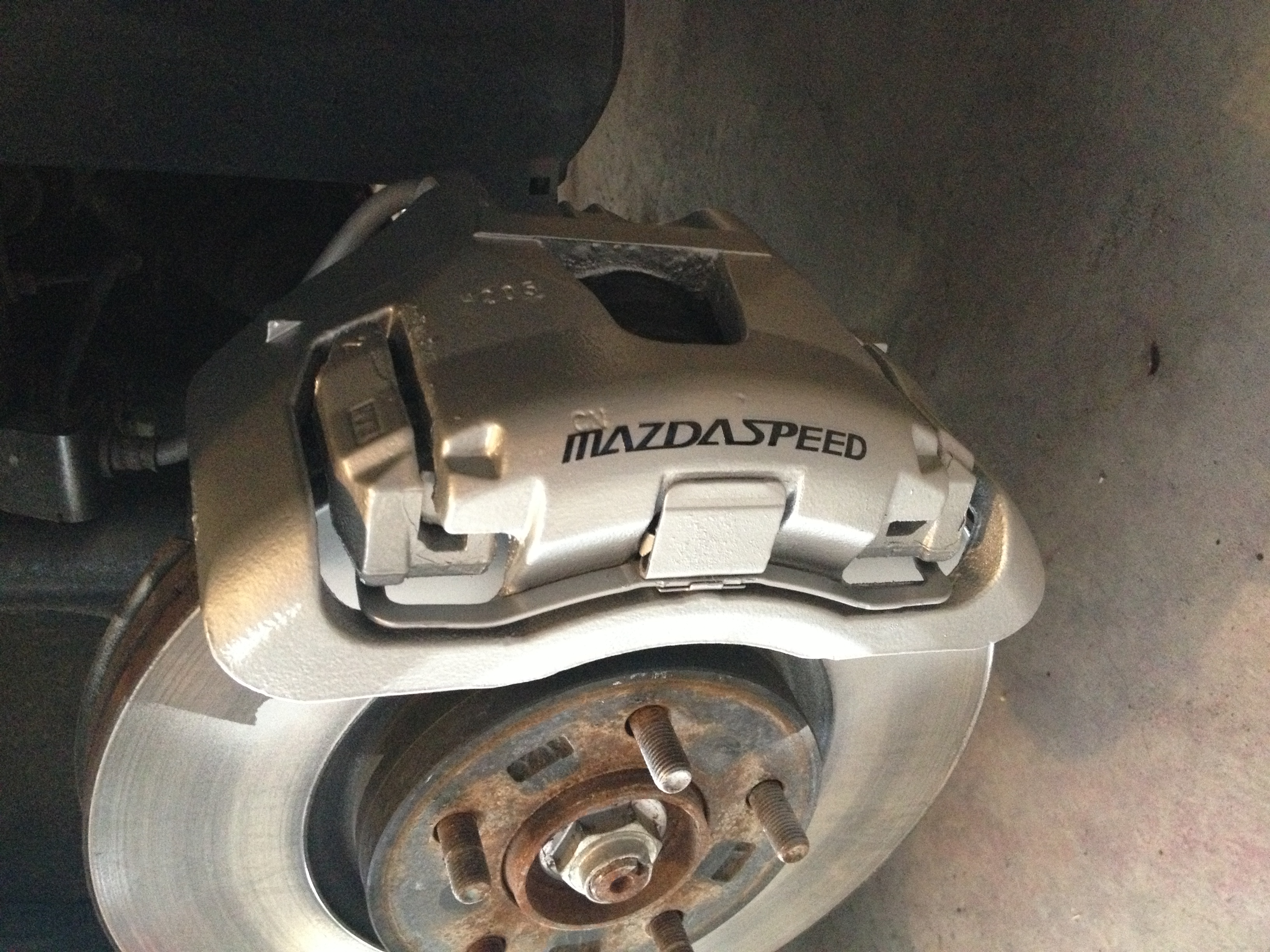

Onto the second color Silver

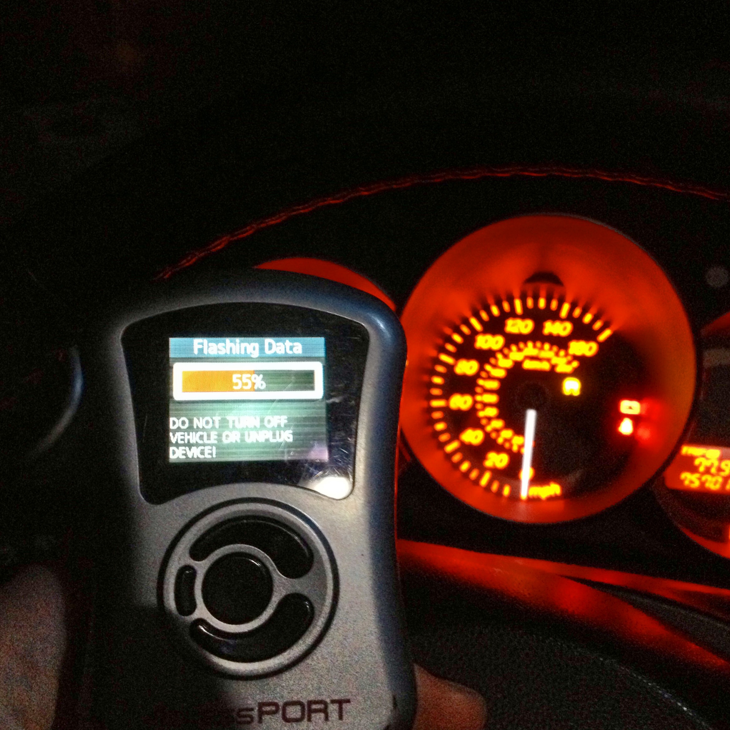

Time for a tune. I used Mike from Stratified Automotive Controls. He was great and set me up nicely with a 93 octain tune as well as a 29% E85 tune. I love ethanol and hate it when I have to come off of it.

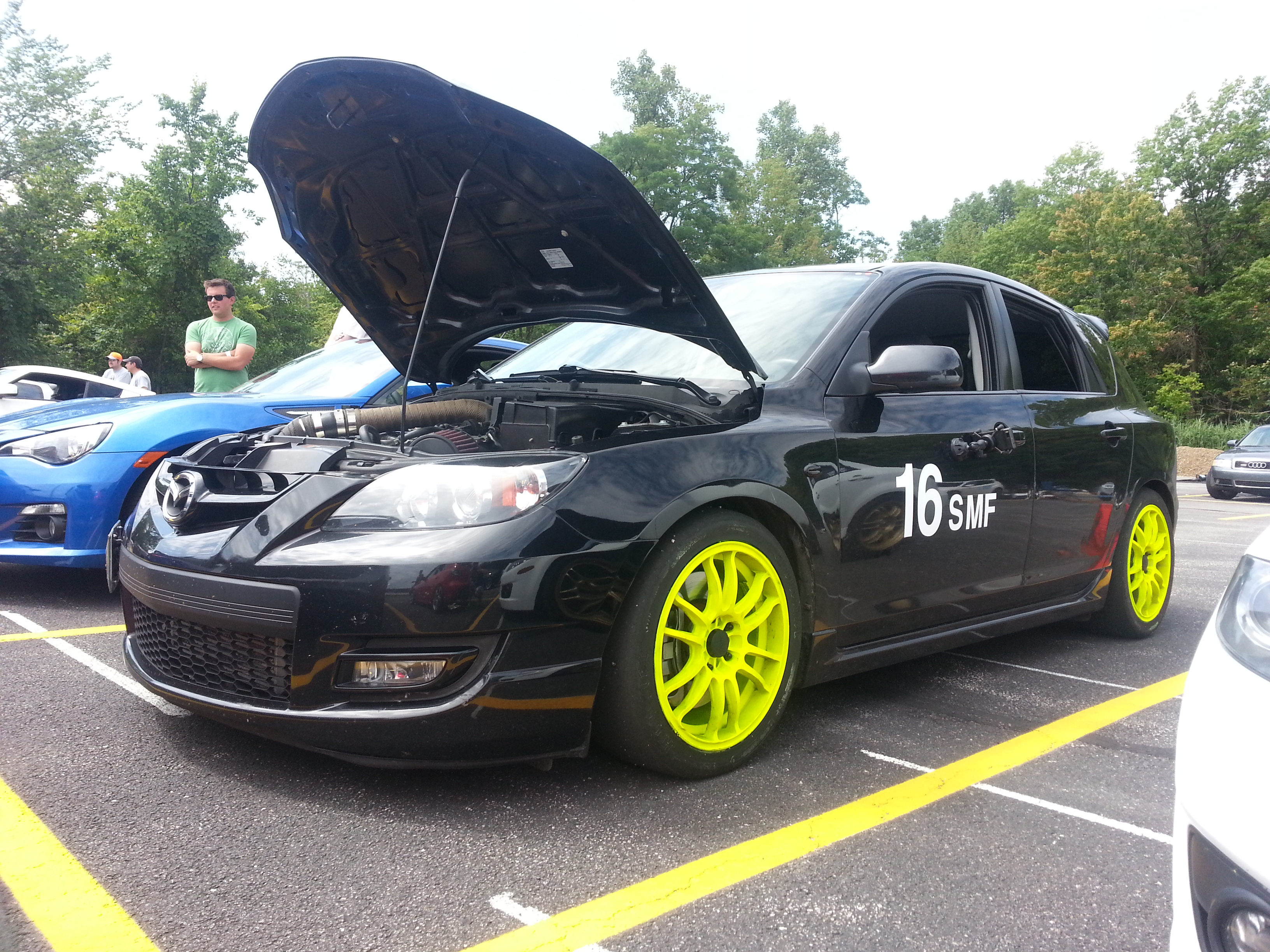

After that I knew my biggest limiting factor were my tires so I picked up a set of 235/40/17 Hoosier and a set of Drag DR-38's 17x8 and plasti-dipped them blaze yellow.
Here is my latest autox video one of the other guys in the SMF class (#2) beat me by 0.066 of a second

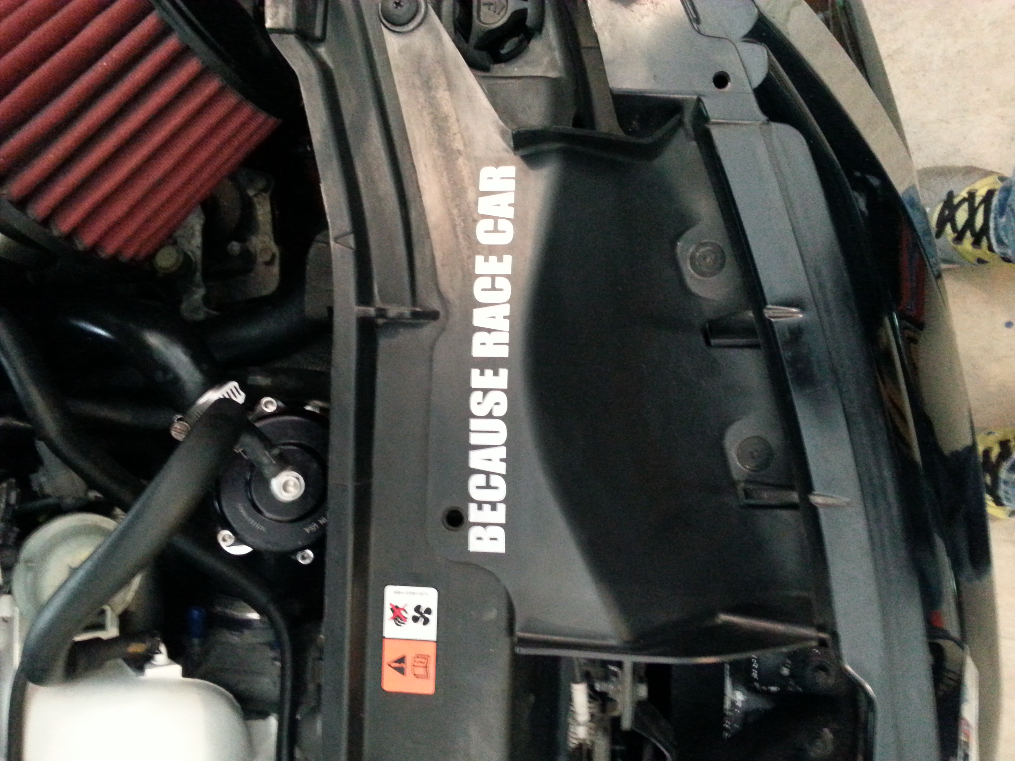

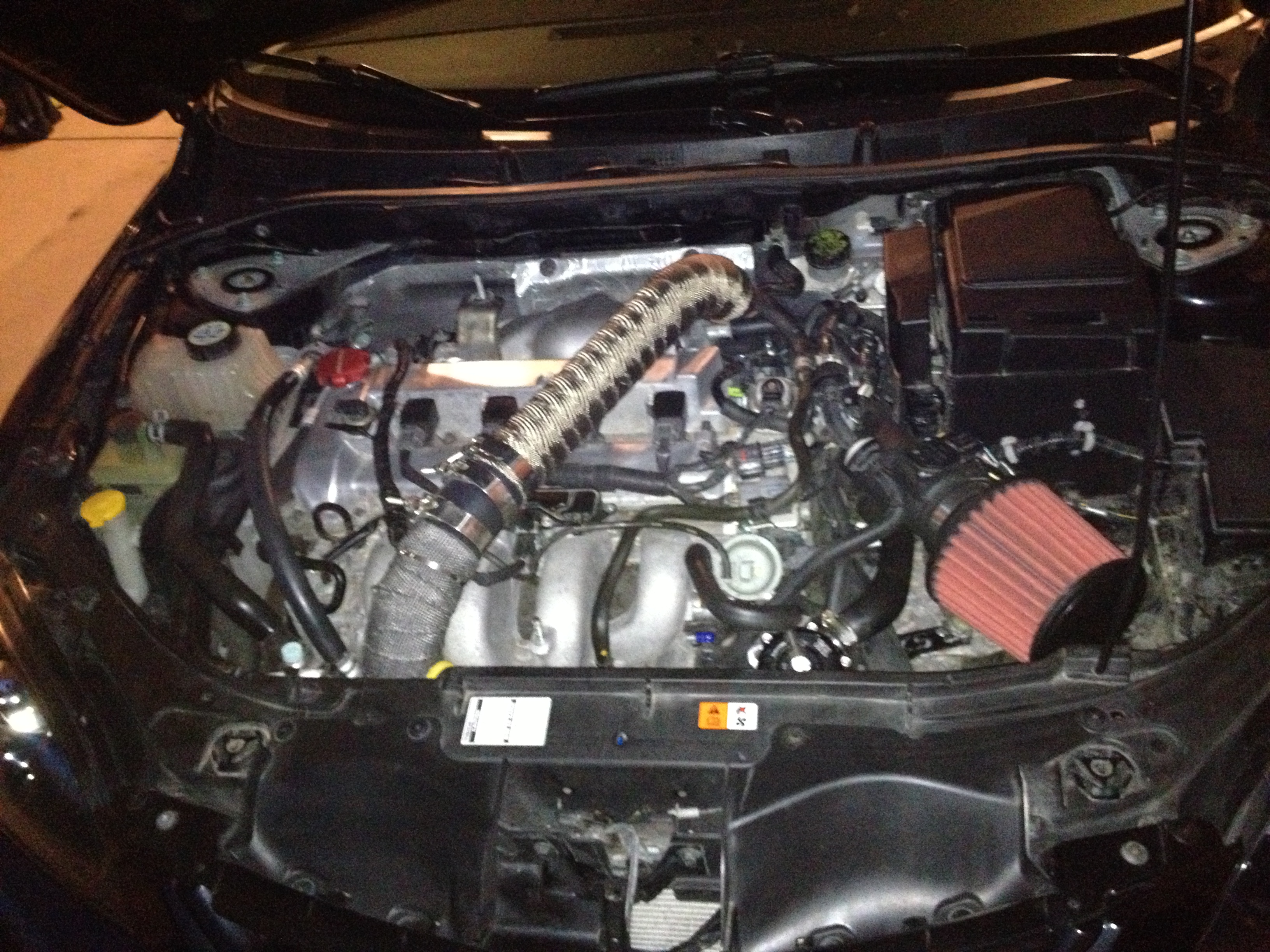

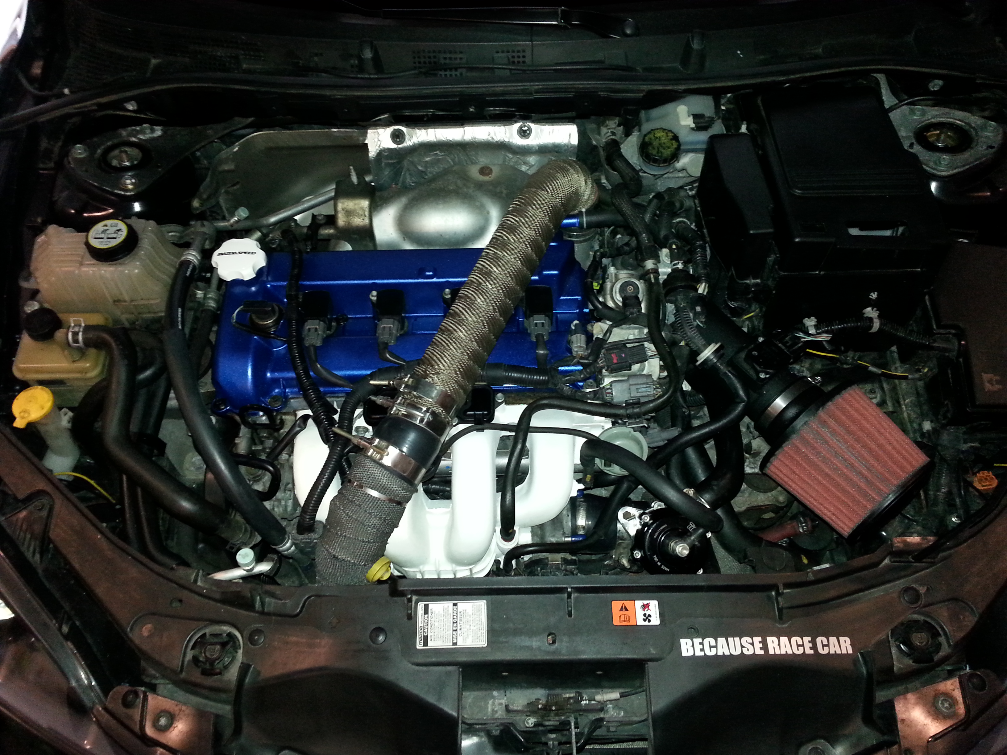

With a little time and effort I cleaned up the engine bay
Thanks Will :D
