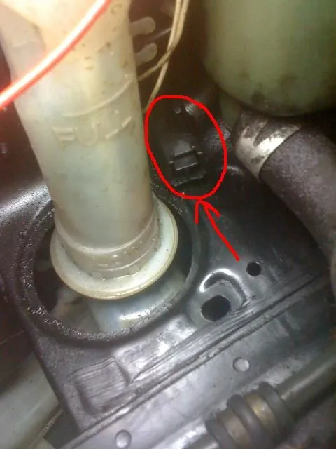

Please help i dont know why nothing is plugged to this!
Protegekid504
2000 Mazda Protege ES
I have a 2000 mp3 es and i found this connector between the ps bottle and washer fluid bottle anyone know what its for????
The explination i got was this.......
Ok so I think I have figured it out. The rear harness (injector, coil, VTCS, etc) on our cars currently have the A/c and PS pressure sensor connectors in that one.
BUT there must be another rear harness that does not have that those connectors or they just updated the rear harness and that connector is another location for those wires to go to. Maybe it was the original place, but because of a problem they had to redo the rear harness to include these. OR the front harness is off of another model..... Most likely at the ecu those are not connected and the ones that are in the current rear harness are.....
Looking at the diagrams this there is 2 locations for the PS pressure switch, one on the rear(B2-26) and one on the front (X-02)
They don't even list a connection for the compessor clutch but thats the other wire.....
