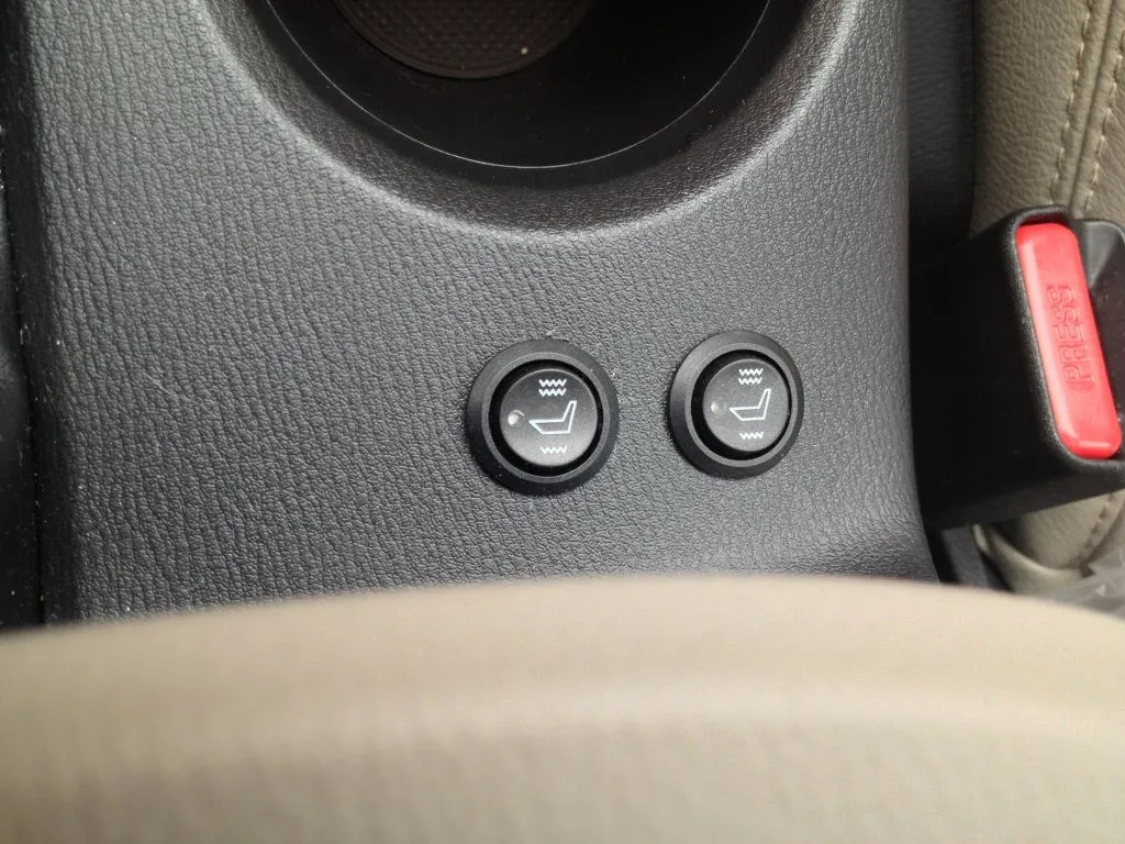

I also really wanted heated leather but didn't see the need to get the GT w/tech, so I opted to have heated leather installed through the same vendor (in PA). Didn't pick the custom colors, figured that black & sand interior is enough - they matched the colors perfectly. So happy I did it - and also I had them put leather on all 4 door panels!
Heated seats buttons
I promised to take a pic of the buttons for heated seats, so here it is.. I took 2, one close-up and another a little further so show the placing. Hope this helps.

Your seats are awesome. I have ordered Katzkin leather and seat heaters for my Touring CX-5. I am going to try and install them myself. Instructions provided with the heaters do not indicate how to "power up" using an existing Mazda wiring harness. If possible could you check your seat wiring and determine if the heaters used existing OEM connectors or something else? I am asking for a big favor and any information would be appreciated.
