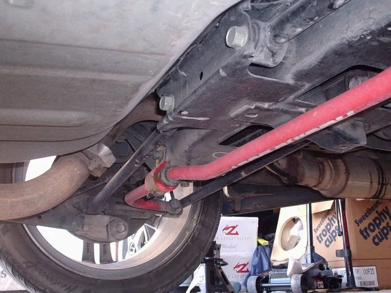

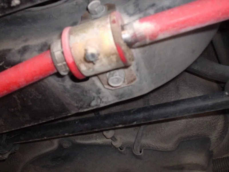

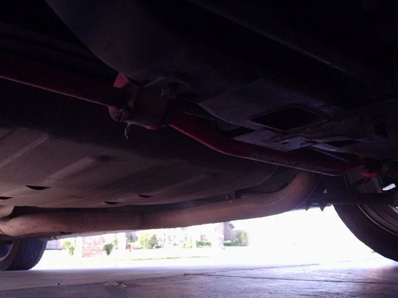

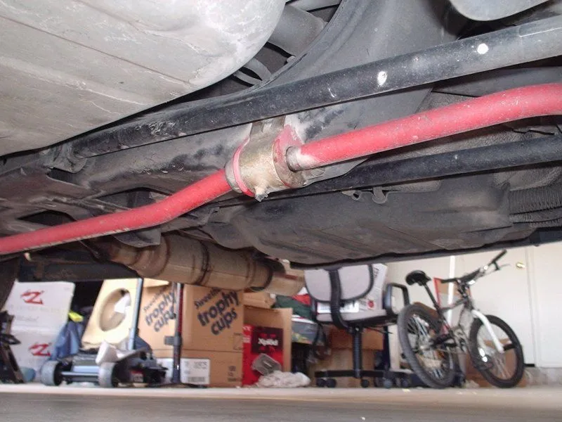

Energy Polyurethane Bushings with the brackets bent to the same shape as our stock brackets

let me see if i can find the box they came in, i believe it was the 20.5mm bushings though, i think u can order a 19mm from energy but when u bend the brackets the 19mm wont fit around the bar.
i'd like to know how......... they havent't sqeaked yet, no sounds of any kind, the bar doesnt slip when cornering even with very hard cornering, the car even handles flatter than it did, so explain why it wont work?
IIRC, someone tried this last year. I won't jump and say that your fix won't work for sure, but I am pretty sure that it won't. The problem is the location of the brackets, not the bushing itself. Mazda keeps making new bushings, when they should just move the brackets outward so they can do their job easier. Mine is clunking after about 5 months on the E bushing, and I have given up hope that there is a fix for this by using different bushings. I think that Dave from Delsing Motorsports has the right idea with his bracket relocation kit.

as for mazda keeps making new bushings....yes they do, but they keep making new rubber bushings, not polyurethane..... who knows this may not work but so far, its working fine and im sick of mazda's half assed attempts to solve the problem.
