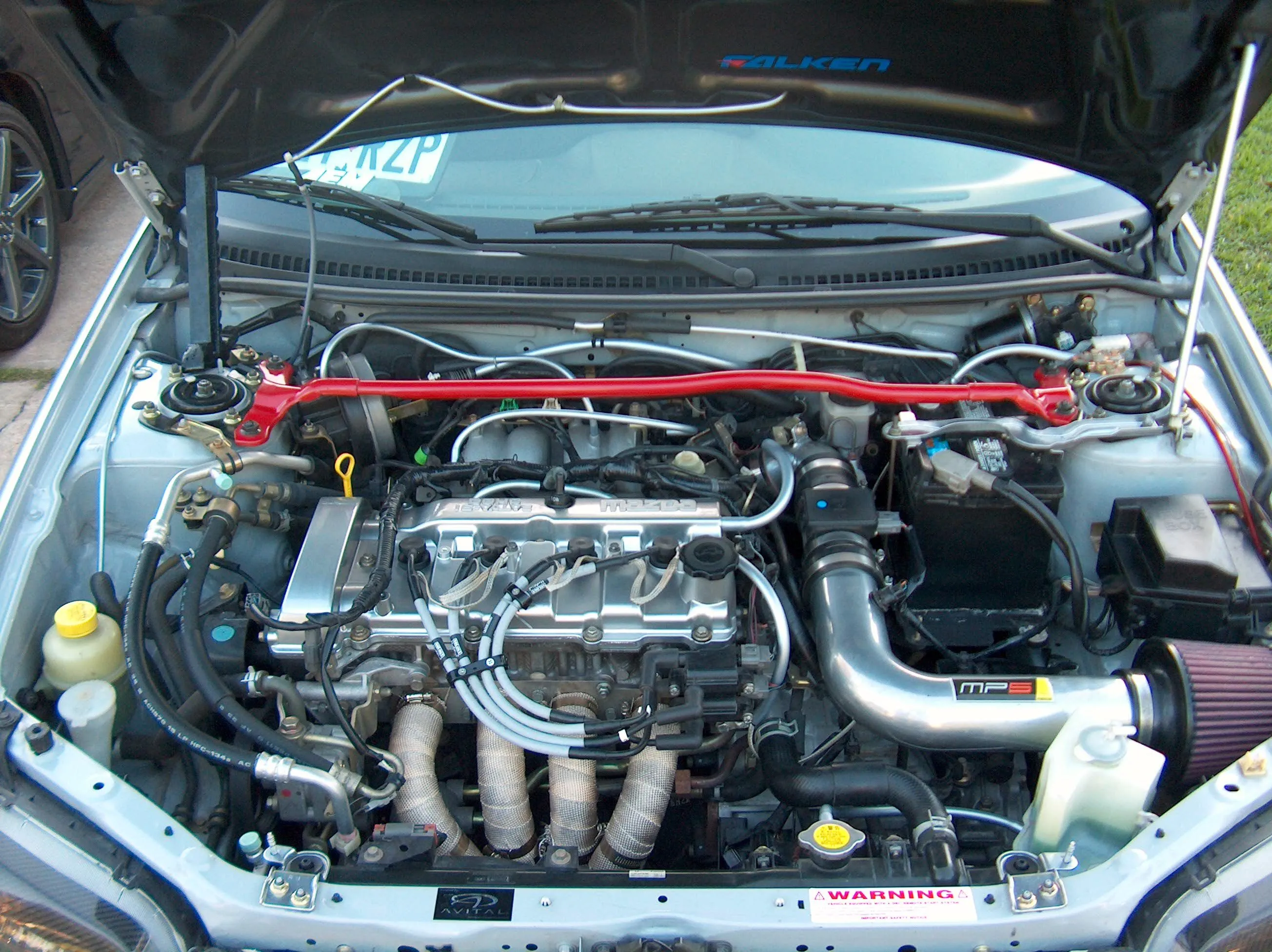

LOL.....dont take it to heart. I actually have driven a P5 with that model intake, and at the time wasnt looking for any differences. BUT!! i can tell you that you are gathering much more heat than the "rerouted AEM MT intake", since it sits so close to the engine. Boxing in the filter (rerouted intake) with a heat shield would be even better, since you can still get cooler air coming in from the hole where the CAI goes through (with the help of a custom ram air kit :D). I used to have the Injen CAI, so i know the differences.......and yes, you get much better throttle response with the SRI than you do with the CAI......deciding which one is better is up to the buyer.

Pic of the rerouted AEM MT SRI: brought to you by CitizenPro

AT can be used on manual but not the other way around. Hence the reason they created a AT version, as the manual version wouldn't fit.

This maybe stupid, but can you use the AEM SRI for the Manual Trans. on an Automatic Trans.(scratch)
Yes you can.....just turn it sideways. Same way as this thread shows you.
Well duh, how stupid am I. That was the original point of this thread, so of course CitizenPro is correct. In fact, the Manual version will move the filter itself further over to the side, over the hole where the CAIs go, so its prolly the best buy if you agree with all the heatsoak stuff that pops up in the CAI vs SRI debate.
