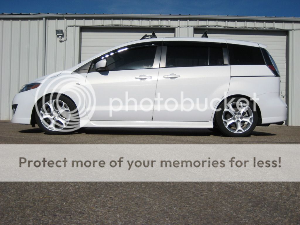

Lowered on H&R Springs for Mazda 3. I highly recommend using Mazda 5 specific springs which H&R has, the rear was sagging too much although shocks that were on their way out didn't help.
ok, i like the drop on the front backs a little low, i guess i know what you mean

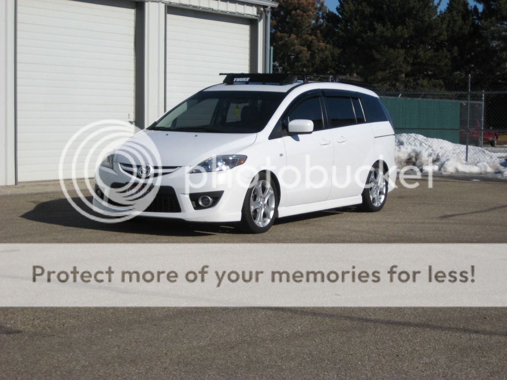

Looks good with the megan springs. I have 2009 and after blowing a rear shock at 60,000 miles and replacing with kyb's.....i am not happy. The stock shocks were firmer. So now i am looking at all the options, koni yellows, sport springs..
What are you running for shocks and what kind of ride do you have with the car lowered. I imagine you installed the rear adjustable camber arms?? Thanks for your input..
Thanks Highfive, sorry to hear about the kyb's not working out. Im running stock struts still with the megan springs for the 5. Now just waiting for my camber arms and new agressive wheels/tire set up. The springs are firmer than stock but not too firm. I like how it rides now, next I will get the adjustable sway bar and end links to help with the roll in the corners.
