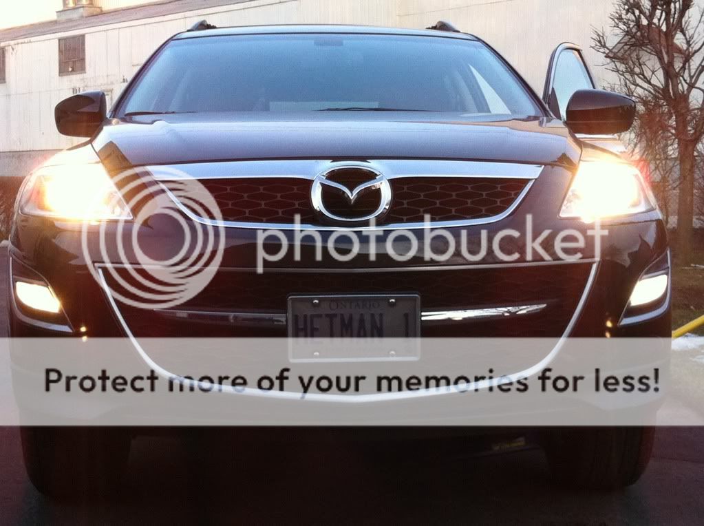

Pics below.

No problem, I will do post pics. The 9011 and 9012's require a slight mod of one of the tabs.
Ok, OSRAMs fit without mods, so I am pushing on to the install of the high beams and fogs.
I did the 9011 mods and they are in and they fit. They appear to be a lot brighter than the stock high beams, wonder what their temp rating is.
On to the fogs, pics to follow
