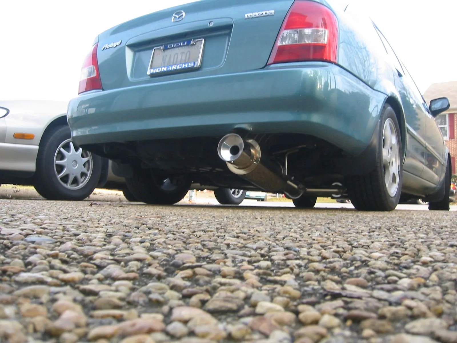

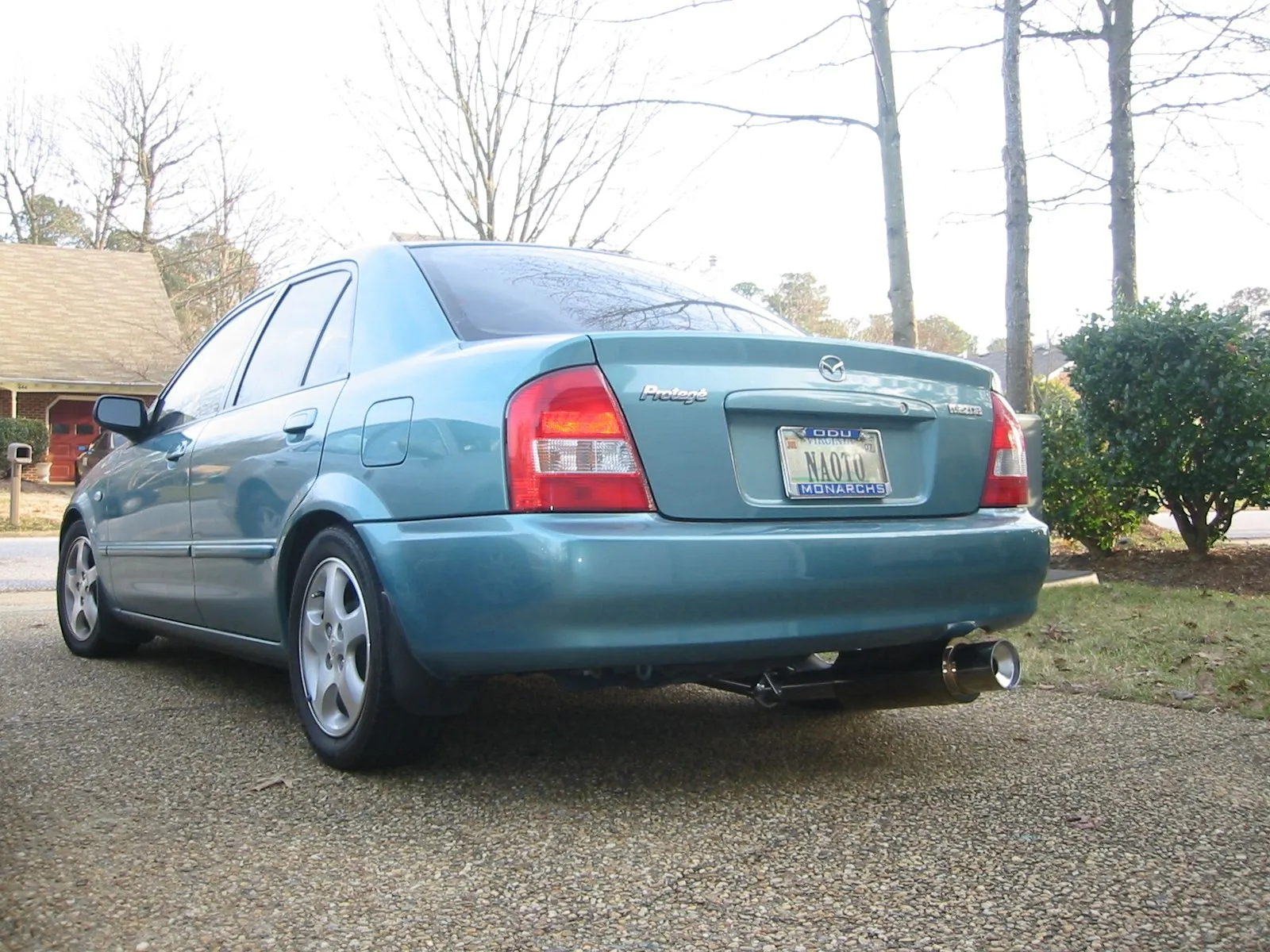

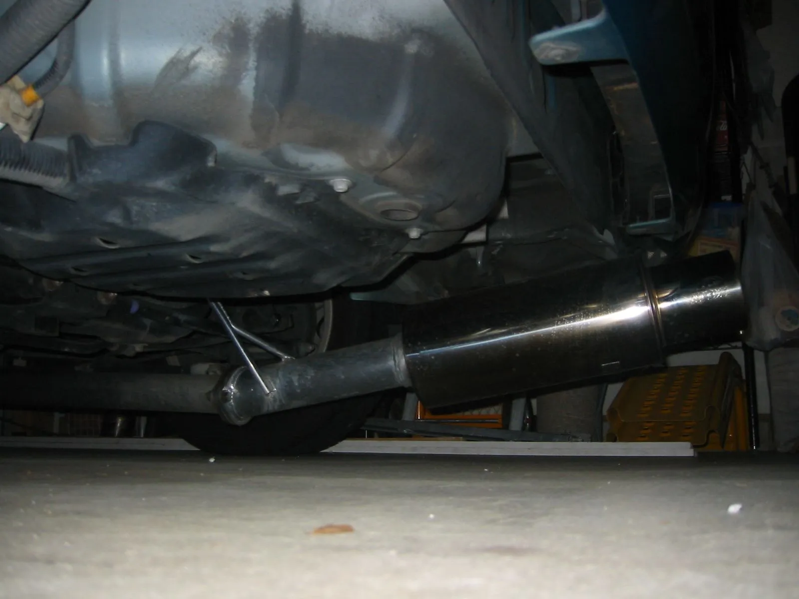

here's my apex exhaust, but not on a mazdaspeed, lowered on eibach springs...
not sure about the sound of the Apex but I love the sound of the CS...not a hint of rasp...
