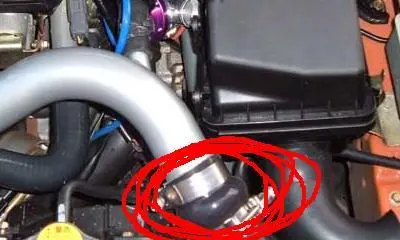

Is that bulge normal? Cheap rubber connectors I'm guessing.
its actually just the opposite those are the more expensive connectors like tyrant said it allows more flex for engine movement and it saves the cheap plastic endtanks on the SMIC
