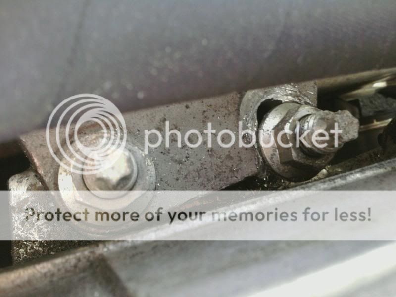

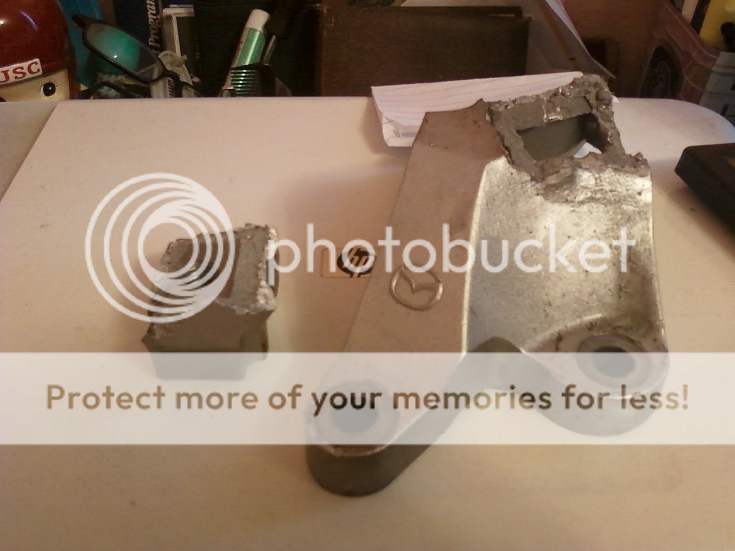

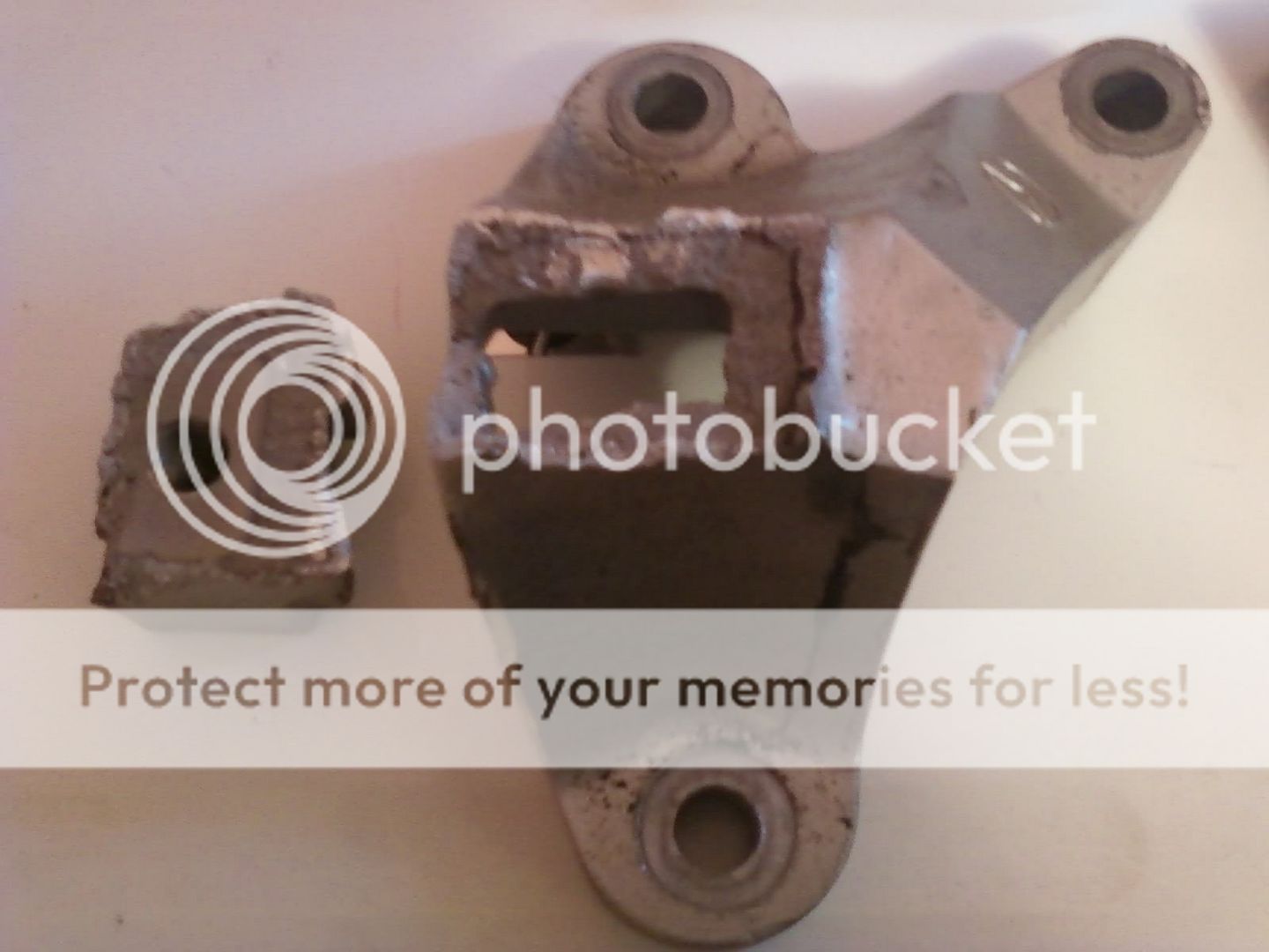

So on saturday i went up to New England dragway, Had some great runs (wet track, limited us to only running 1/8th miles) But on my 13th or 14th run I think i broke my motor mount, because i took a few more runs, my launches were s*** and it sounded a bit different. So below is what i found.
So as you can see the PMM, failed on me and the aluminum on the bracket snapped from around the stud.

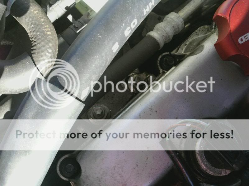

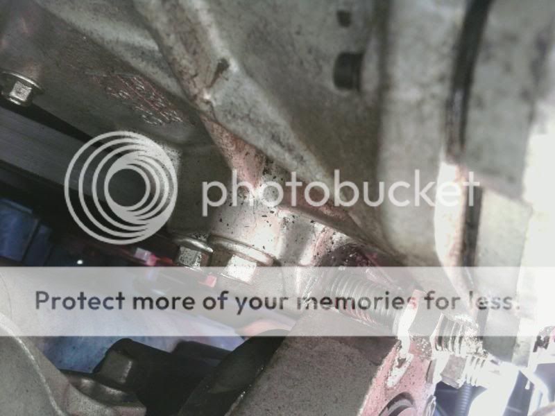

The issue is one of the studs is also bent it appears, and i am concerned about how that will effect the repair.

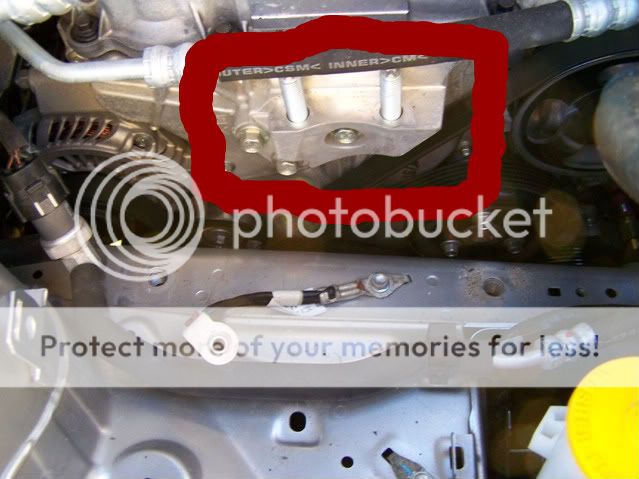

Can Anyone tell me what the part# or what to call what is pictured below.
(stolen from bioevolve and edited)
I think i will need to replace that piece.

-Need part number of item depicted in red box

2. go to this site and they have a list of all the prices part numbers and images of the oem parts. http://www.trademotion.com/partlocator/index.cfm?action=getJointLocator&siteid=214264
3. Any pmm are better than the stock ones but try to find one that also replaces the bracket.

this is what happened to my tranny motor mount bracket I would recommend the ptp that I just ordered because it replaces the bracket and the trans mount. But they are on backorder so i would recommend ordering them asap.
The street unit mounts and any mounts are better than the stock mounts but the street unit trans mount does not replace the bracket that is made out of low quality aluminium.

WOW I've never seen the bracket fail like that before, that's nuts.
Yea the bracket is a piece of crap. It might have just been a bad piece but it definitely should have not passed the quality control inspection. Inside the fracture there is lots of porosity in the metal.
