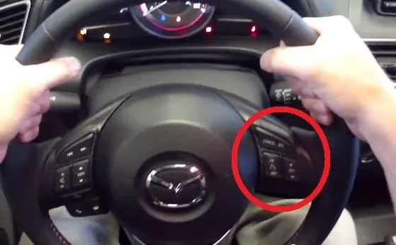

Hello everyone.
How do you do?
Would anybody be able to tell me the part number for the cruise control buttons? (cars with NO city-brake)
My car did not come with it, and I guess it should be a plug-and-play thing so I would like to try and add this feature.
(I know they are different but I did it on my 2010 Mitsubishi Lancer and it worked perfectly with no need to re-program anything)
Thank you very much

FOUND IT!!
I asked in a forum in Japan and a guys has done to his CX-5. He installed the paddle shifters and the cruise control. However, the cruise does not seem to work.
anyway, check this out:
http://www.jimellismazdaparts.com/showAssembly.aspx?ukey_assembly=1149968&ukey_product=9905551
part number: KD35664M3
