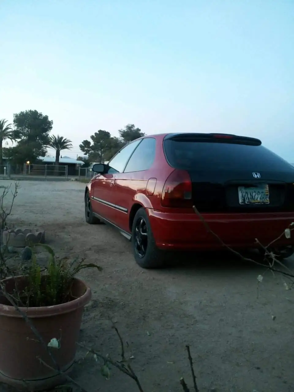

Just sand and paint it yourself. I've had to do it in the past. Easiest way is to use spray paint.
This picture is of a Honda hatch I painted black.

Ultimately, in decent condition it's around a $2000 car if everything works and not all rusted out. I personally could not justify spending several hundred dollars to repaint a hood.
