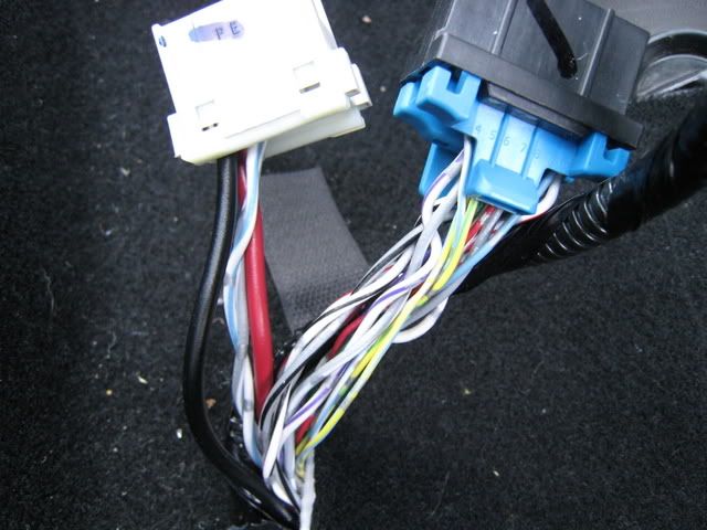

I bought this thing like, a year ago and finally got enough funds to add an amp. Well... I get everything torn apart and it's not even close. My plugs are smaller and more compact. I have a 2008 Mazdaspeed 3 with the Bose... said it'd work with the Bose. Well, it will not. Suggestions? Someone has already been in there and there's 4 leads off 4 wires going into the amp. I'd prefer not going that route. I wanted to use the OEM amp interface. Please help? (gah)

Look in the How-To section. I'm sure someone has the wiring diagram. The easiest place to tap the signals is the pre-amp harness underneath the driver seat. I say "easiest" because if you're like me with a FUBAR back, you'll look like Quasimodo after splicing wires in a hunched position.
I bought a speaker level input harness for the Alpine I bought. Tap the 2 wires off the white plug, which I still don't know which is left and right. Tap the solid blue on the blue plug. :) Should be done.

you can do it yourself by following the "underseat" wiring diagram, tough search, but its in here somewhere
Were you trying to connect it under the seat? I wasn't able to, because the plugs were a different size, but it fit great behind the radio. Try that before you give up.
Oh wow. I didn't think to ask if he was installing it properly. I just assume everyone knows it connects to the back of the HU, not at the amp.
I eventually did. Butchered 1 RCA into the right channel on my amp. As it is a MONO amp. Not ideal, but it works. Eventually, I may put in a low output converter. Because the gain is WAY down. But for now.
