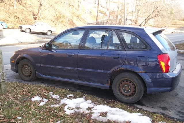

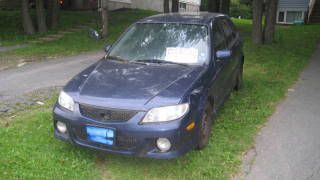

I am makeing this thread mainley to document the work and progress of my 2002 Protege5 auto I bought about six months ago for $1200, It came with a safty that was two months before it expired, so i decieded to drive it until it ran up, then I would do the work thaat need to be done for quite some time. I am the second owner, the first owner dident take very good care of it form the day he bought it, never had it under coated, was a chain smoker and had two huge Dogs that have fur eveywhere and not to mention ripped apart the rear seats.

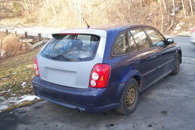

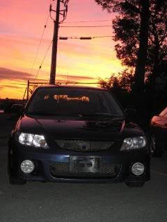

Here is what it look like when i first bought it..

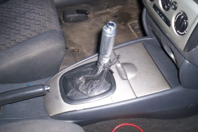

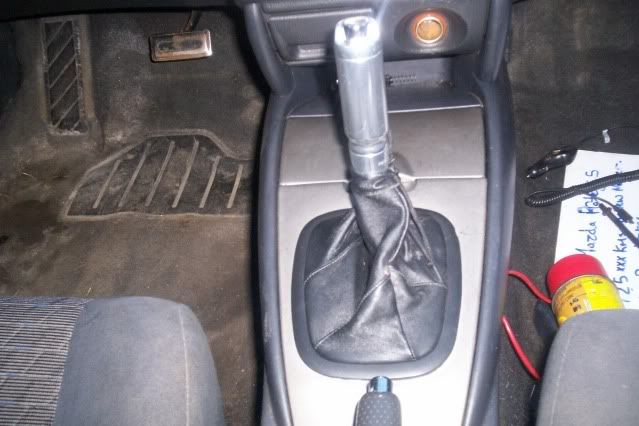

Hated the look of he stock auto shifter so i added shift boot and shift nob that i had kicking around, then that was it before the safty ran out..

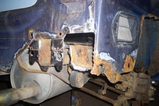

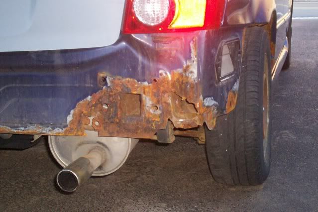

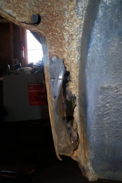

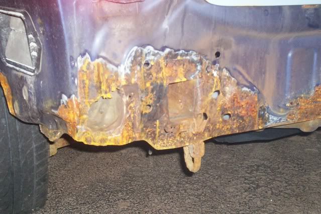

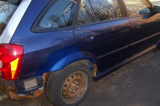

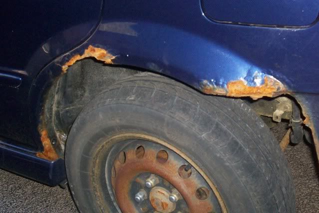

Now that the safty ran out the real woork begins, rear wheel wells are pritty rotted so i took the rear bumper of and found alot more rot problems them i thought there was but what the hell its got to be fixed.

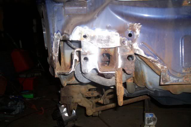

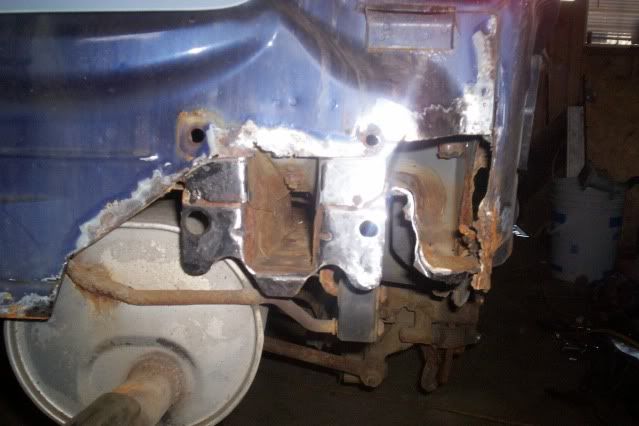

All cut out and ready to be welded

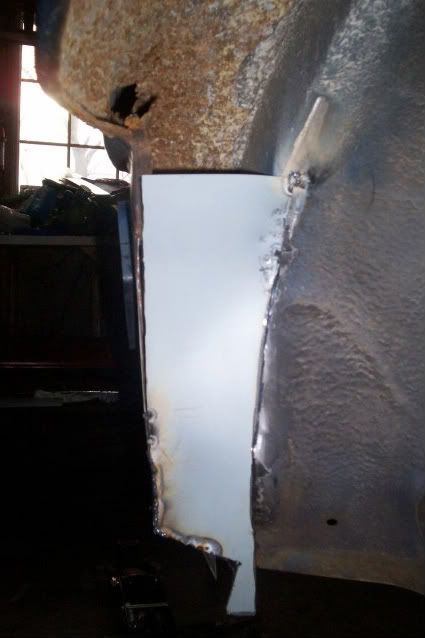

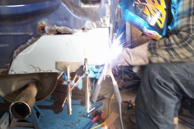

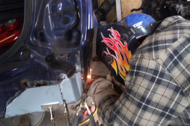

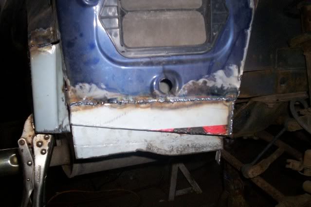

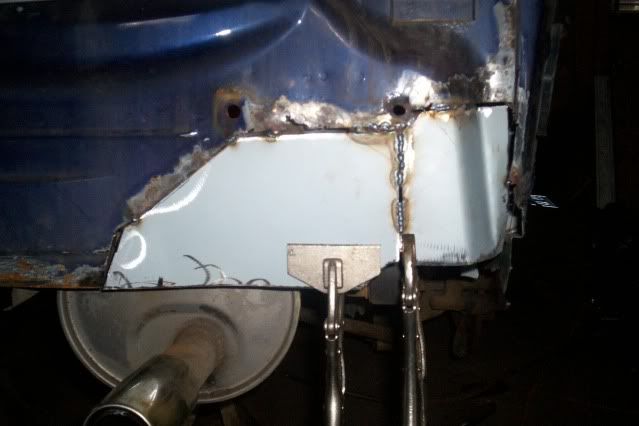

well we got one side tacked together today before we ran out of wire over all i think its going to come out good when it is done. im hopeing we can finish it up tuesday night before we go pick up my brothers new flatbed trailer..
my brother is doing the welding on this car as my welder decided to die a few weeks back, i did all the metal bending and cut the peaces out.
well this is it untill tuesday night comes around..

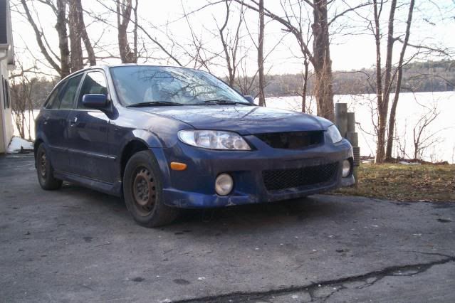

What happend to your factory wheels?
That hatch looks so purdy I can't tell with the pics but is the licens plate boarder thing shaved too?
Yes the the plate border is shaved i did that wile being bored one day, but its got to be redone again with a strip of metal, the tiger hair keeps cracking because the factory plastic peace keeps flexing..
the factory wheels did come with the car but they had alot of curb damage on them so i sold them, ill be looking in to getting a set of aftermarket wheels after the car gets painted, probably stick with a 16 inch rim though..

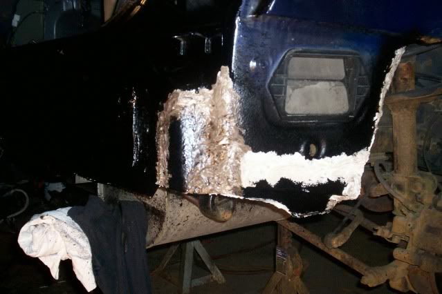

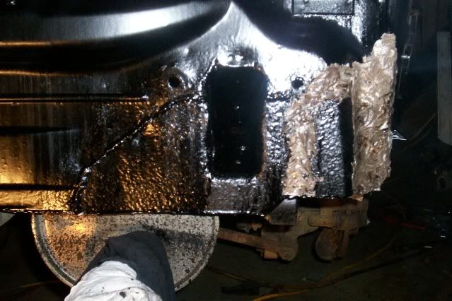

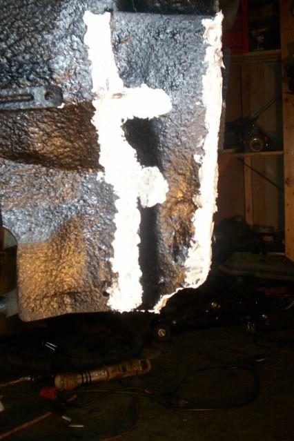

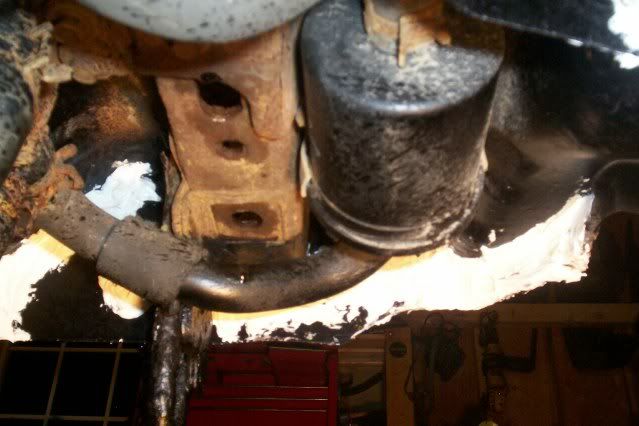

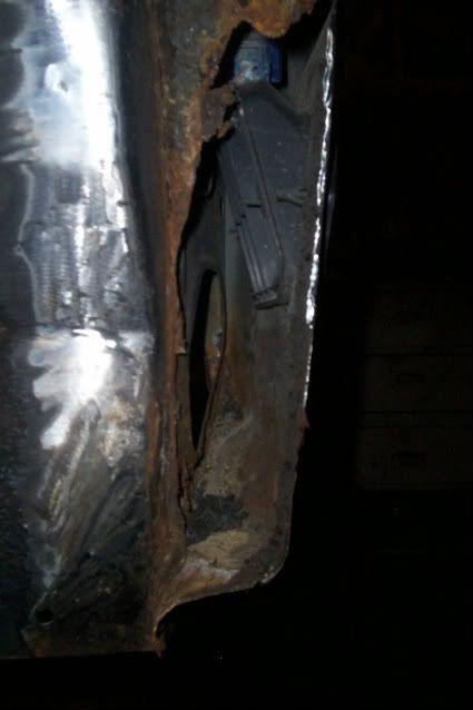

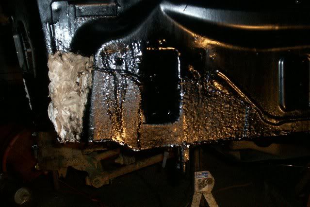

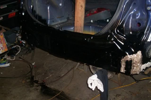

My brother kinda diched out on me and half assed the welds, but luckey for me he left his welder in my garage so I ended up finishing up the welding, then after that was done I sprayed Ruberized under coating ove all of it, let that dry while I was at work then i seam sealed over all the welds and any where else that needed to be done, I aso sprayed the inside of the frame with fluid film to help the rust that is in there to slow down..
Pics
After the seam sealer dryes I will be coating it again with ruberized undercoating, them once that is all over I will be starting to work on the wheel wells..
