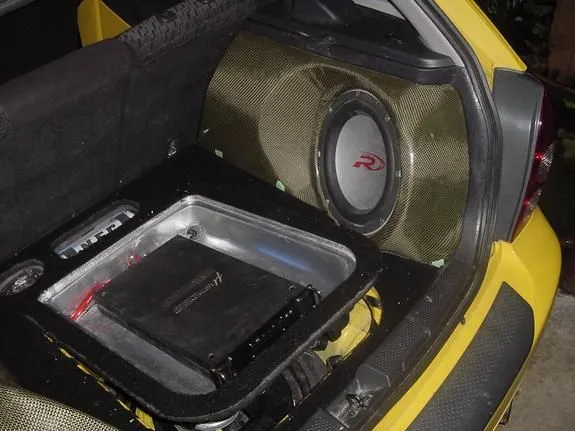

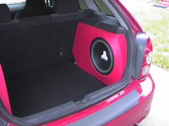

Any pics of this? I tried to evaluate that spot for my CD changer, and it was just too small. I don't see how a sub could properly fit in there and perform well.
I have no idea who these cars belong to but they were saved like 1.5+ years ago. I've seen others as well.
